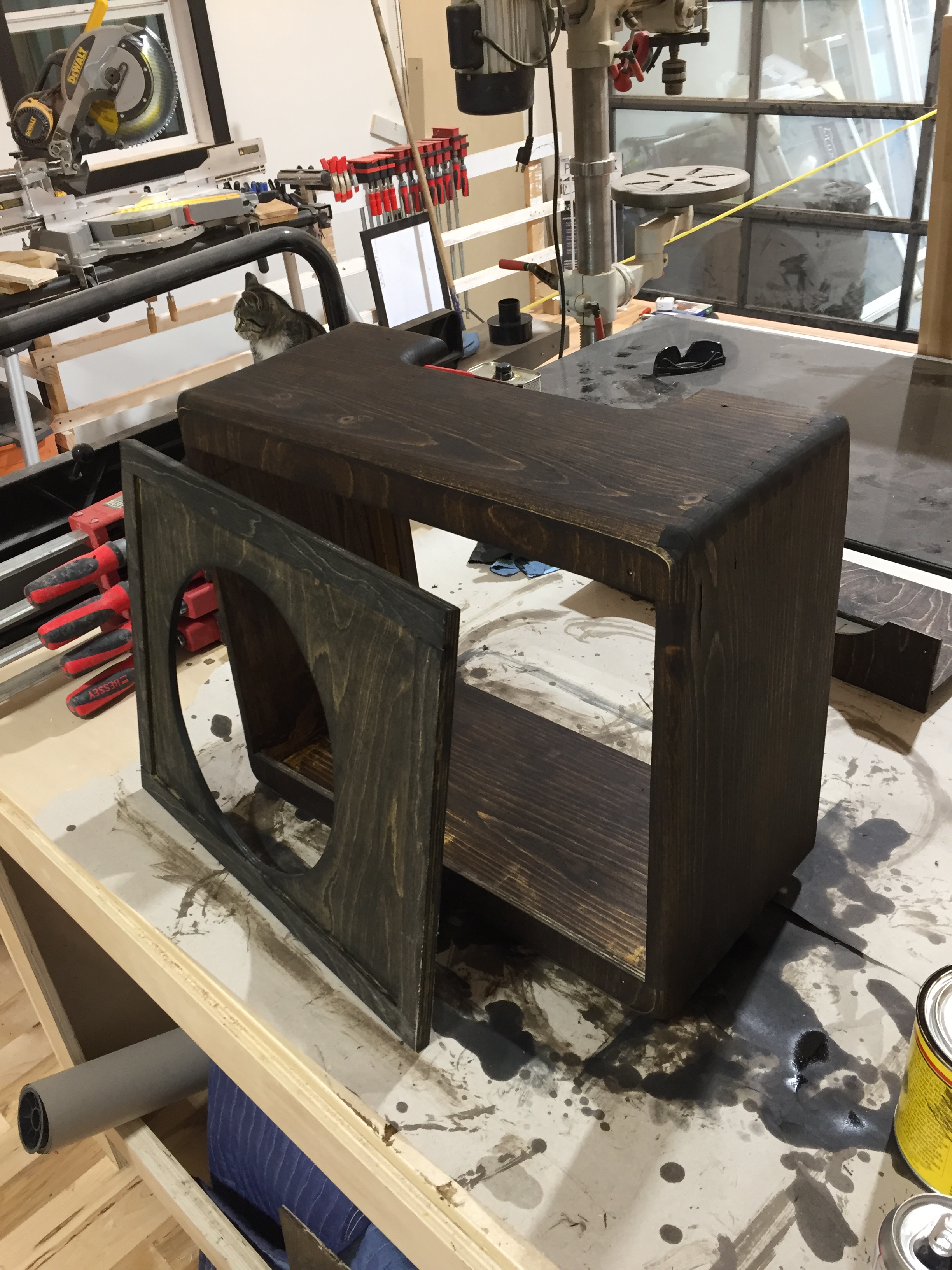

I got one coat of stain over the weekend. Used Dark Walnut Minwax. Ended up being a little darker than I thought but I like it. Just needs a bit of touch up sanding and then a couple of coats of finish.

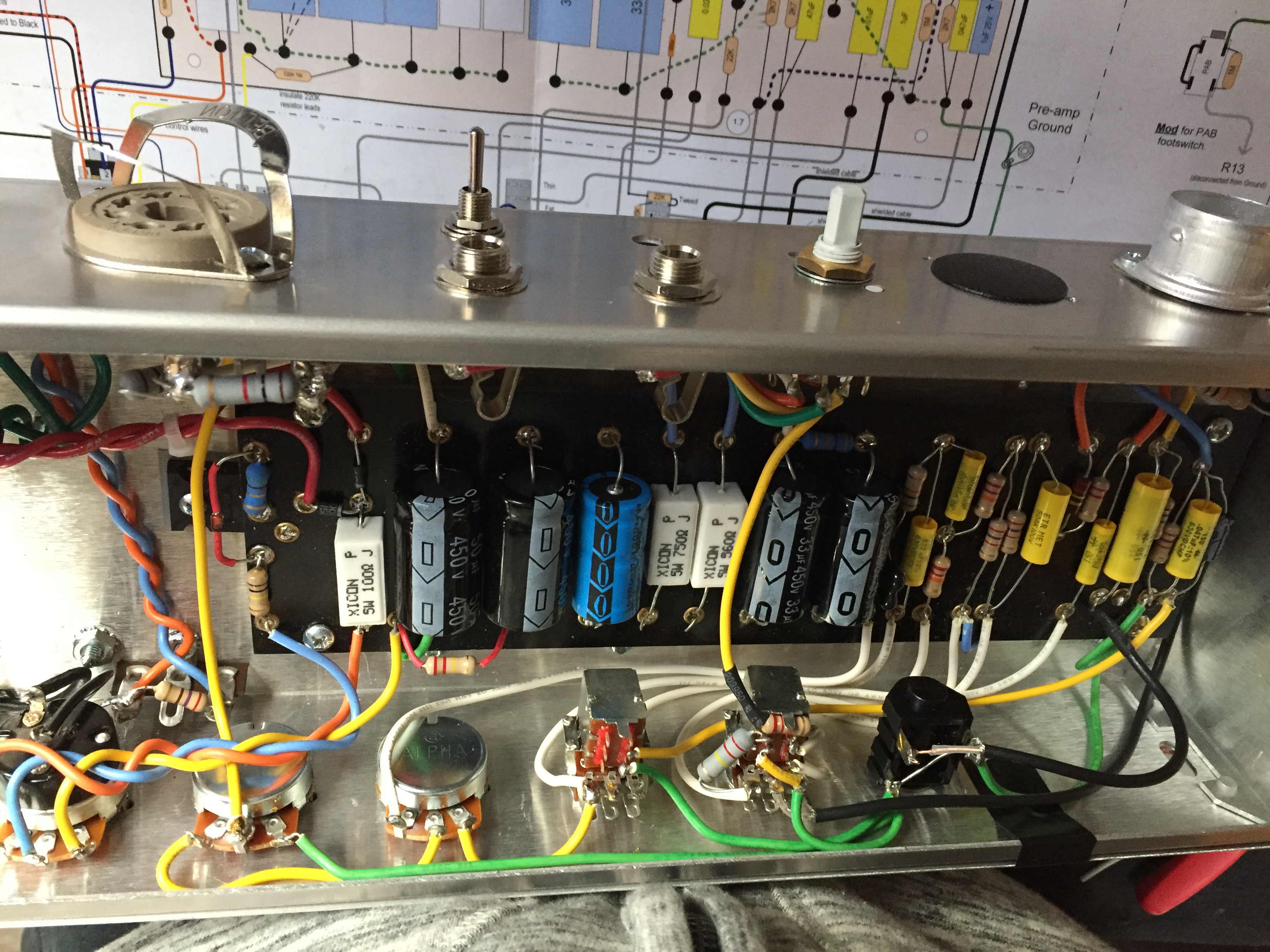

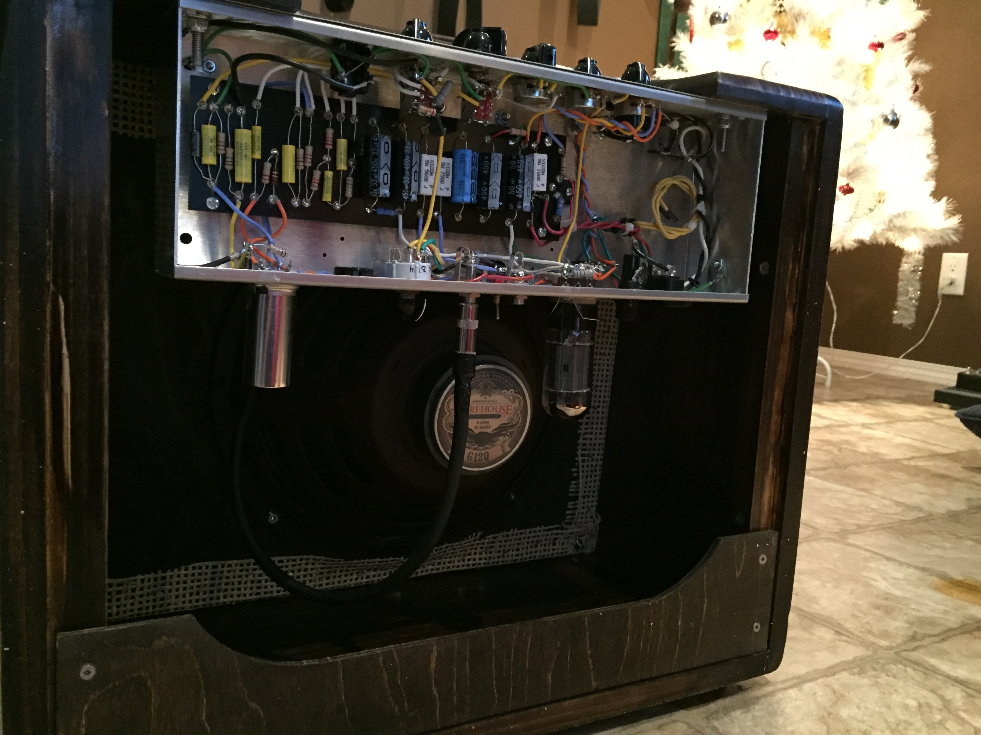

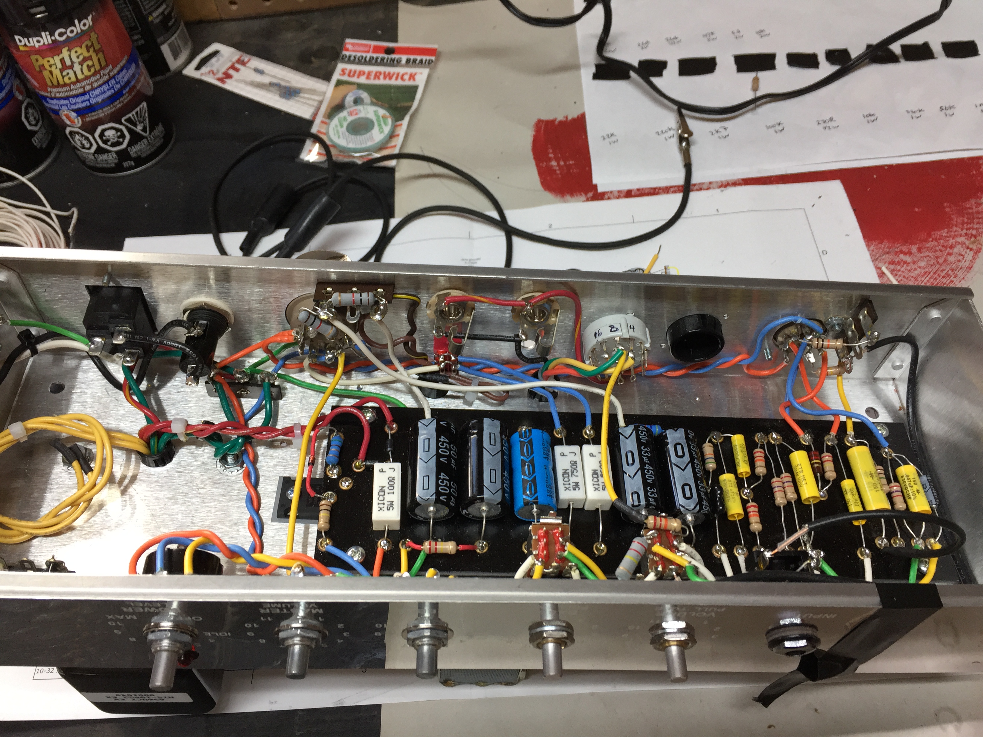

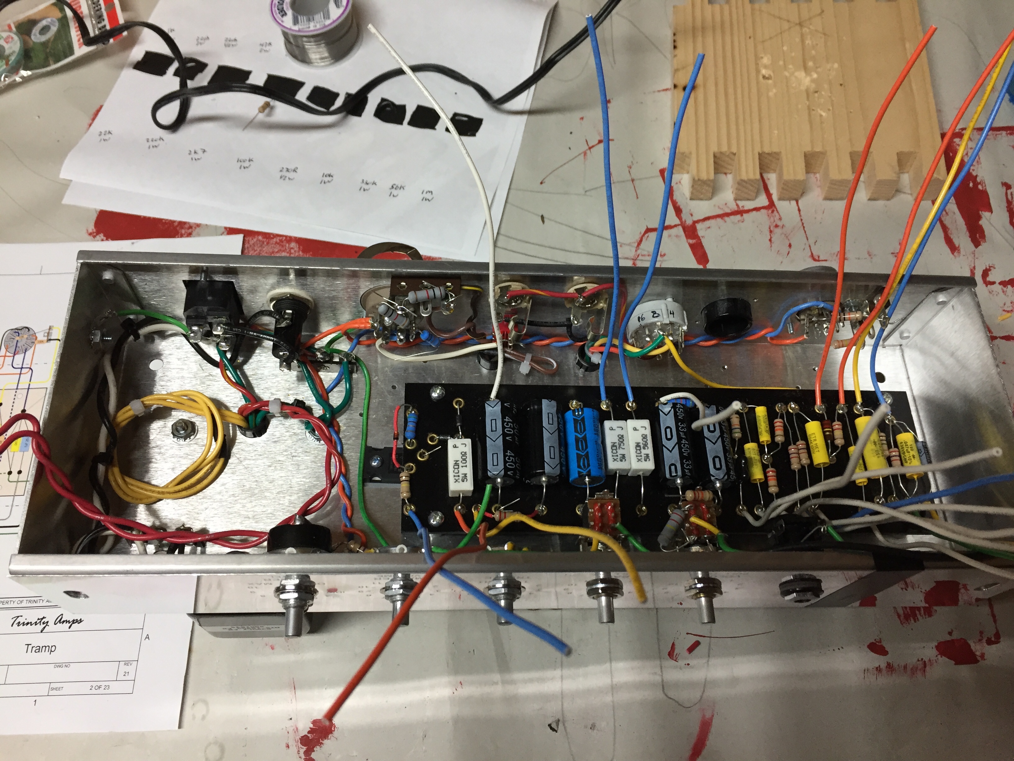

Got the wiring finished this weekend. How does everything look? Sorry I don't have a proper camera to take better pictures. Just need to check point-to-point to the schematic and then I'll build a quick light bulb limiter for first power. Can't wait to hear what it sounds like!

Dumb question, how do you know what position you're in (4,8,16) on the impedance selector switch? I’m counting six different positions when I click it around.
I think my kit must have been missing that tang washer that was described in the manual to limit it to three positions. I'm assuming it's not critical as long as you don't turn it past the 3 settings. I read elsewhere on the forum that these Lorlin 2P, 6POS switches work as follows:
Lug 1 = yellow = 4 ohm = full counter-clockwise
Lug 2 = green = 8 ohm = one click clockwise
Lug 3 = orange = 16 ohm = two clicks clockwise
Can anyone confirm if this will work? Is there a way to test this? If I am in the 4 ohm position should I be reading 4 ohms between lug A and lug 1? Thanks
 Post subject: Re: Tramp build
PostPosted: Tue Nov 28, 2017 11:39 pm
Your build looks really good! Very clean and neat.
Yes, it sounds like you are missing the tang washer that sets the stop on the switch.
You won't read 4 ohms between lug 1 and lug A of the switch. With nothing connected to the output jack you should read open circuit between lug A and all other lugs except the one the switch is set to connect. In that position you should read 0 ohms.
To put it another way, when the switch is set to "4 Ohms" you should read 0 ohms between the yellow wire from the OT and the hot (tip) terminal on the output jack. When the switch is set to "8 Ohms" you should read 0 ohms between the green wire from the OT and the hot terminal on the output jack. And when the switch is set to "16 Ohms" you should read 0 ohms between the orange wire from the OT and the hot terminal on the output jack.
Another way to check is to measure the resistance across the the output jack (hot terminal to ground) with the amp off and no speaker connected, of course. These readings will be really low, around 1 ohm or less, since you are just measuring the DC resistance of the secondary winding on the OT. The lowest reading will be when the switch is set for 4 ohms and the highest will be when it's set for 16 ohms.
You should try to get the tang washer or rig something up so the switch can't go to any unconnected setting. In that case there will be no load on the OT and that's very bad!

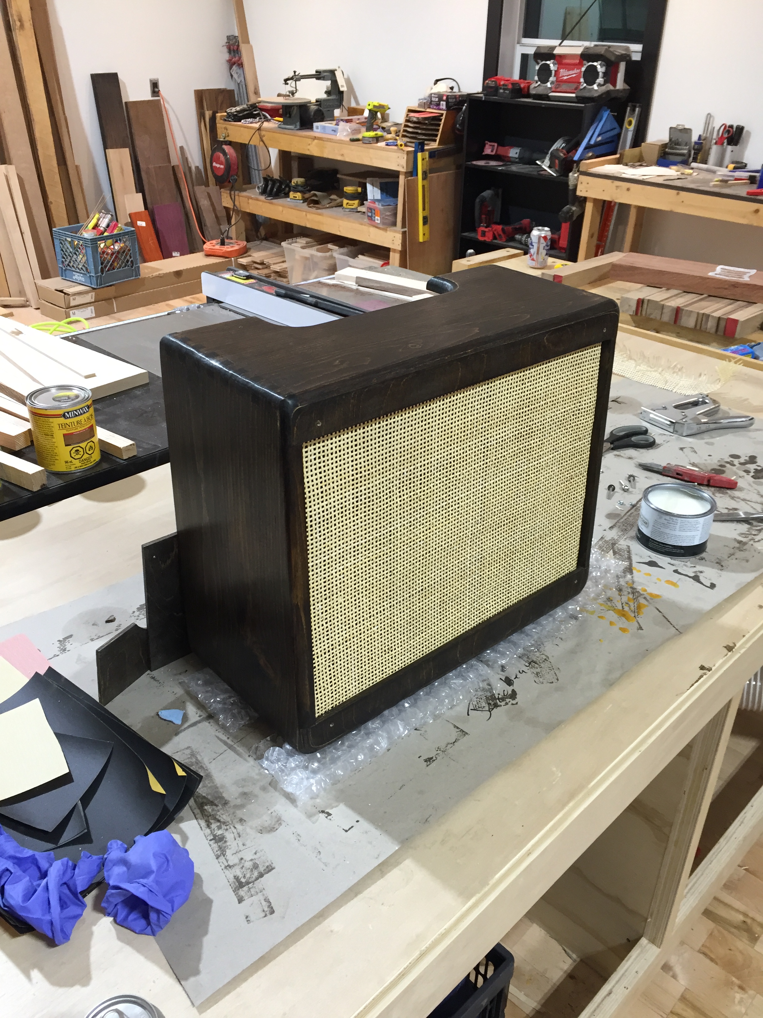

Two coats of wax applied last night. I think one more quick sand with 400 grit and a final light coat of wax and that will be it.

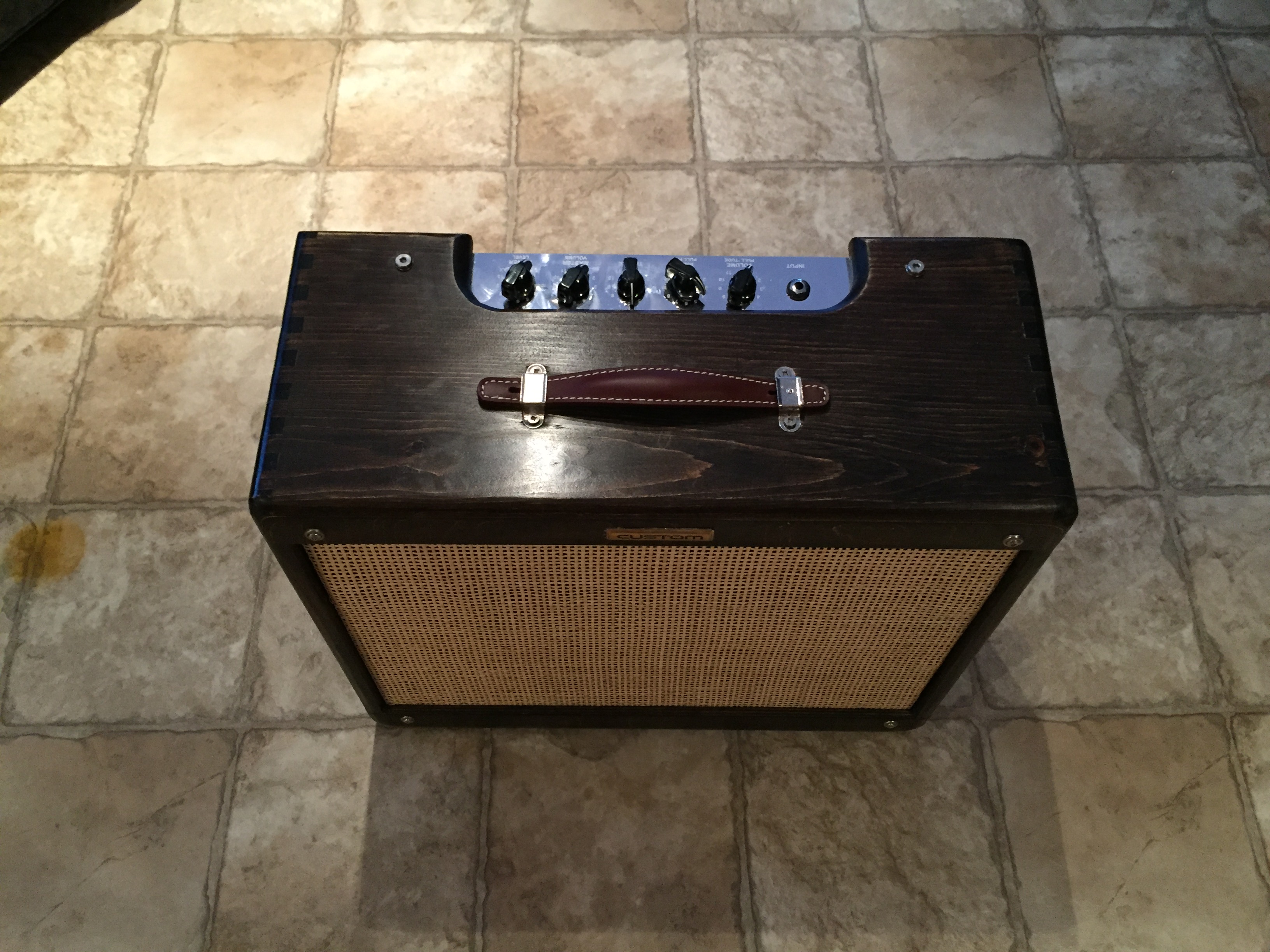

Xmas came a bit early for this guy! Turned out a lot better than I thought it would. Sounds awesome. Thanks everyone for helping me out. Thanks Stephen for a great kit! I thoroughly enjoyed the whole process of building both the amp and cabinet. Can't wait to start another one!
Happy holidays everyone.
