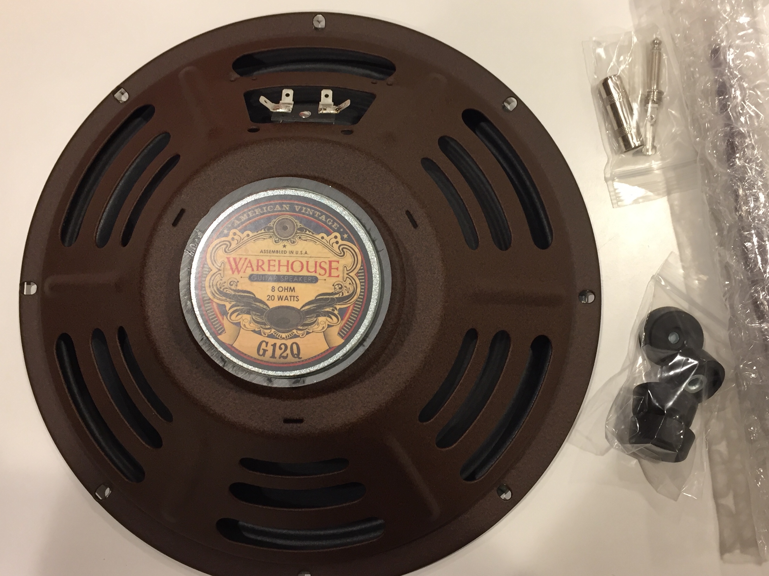

Speaker showed up today

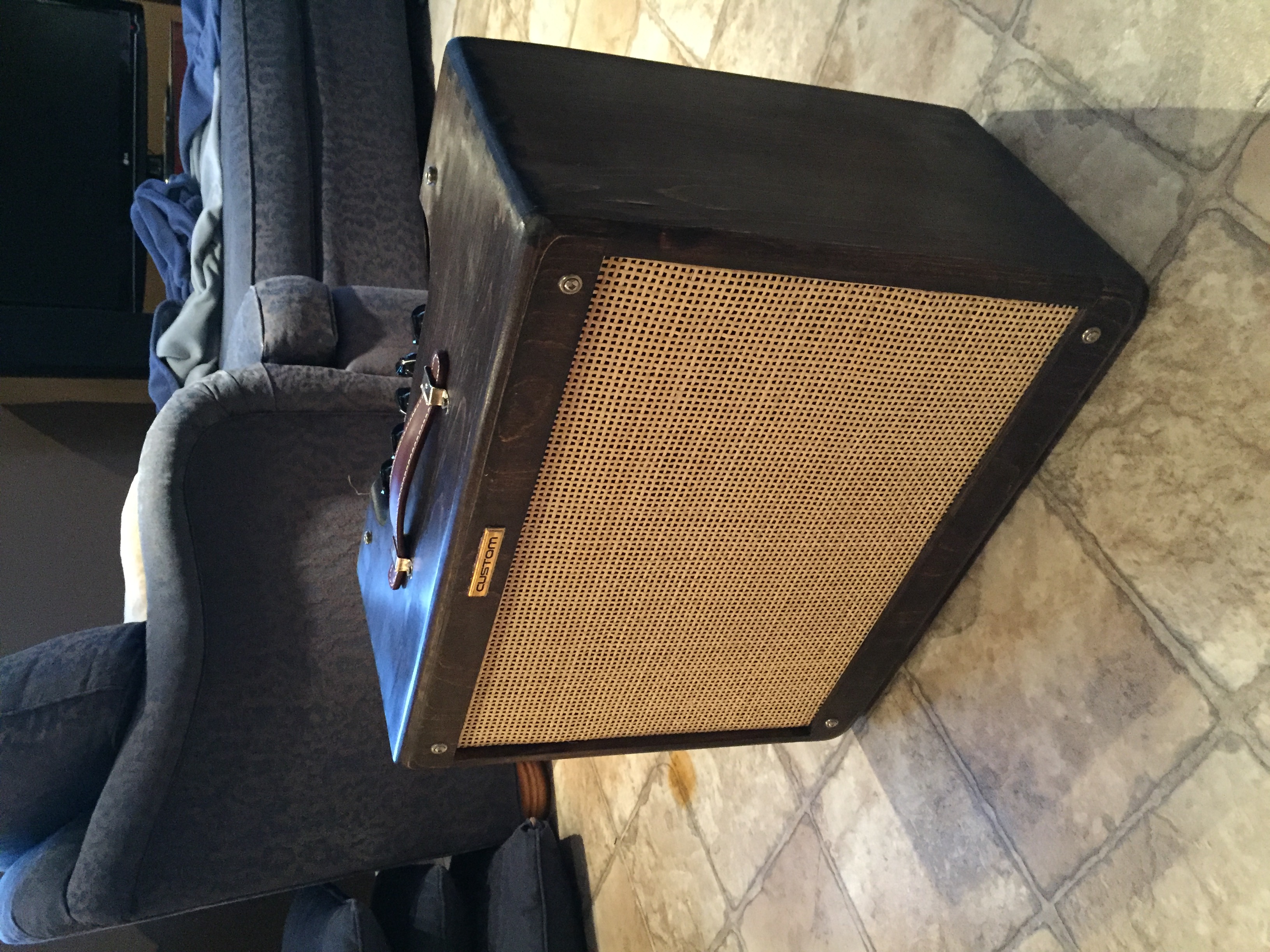

Two coats of wax applied last night. I think one more quick sand with 400 grit and a final light coat of wax and that will be it.
 Post subject: Re: Tramp build
PostPosted: Sun Dec 17, 2017 11:57 pm
It's looking great, congrats on the chassis build, the cab looks really good, nice workshop there too! :thumbsup:

Xmas came a bit early for this guy! Turned out a lot better than I thought it would. Sounds awesome. Thanks everyone for helping me out. Thanks Stephen for a great kit! I thoroughly enjoyed the whole process of building both the amp and cabinet. Can't wait to start another one!
Happy holidays everyone.
Barry
