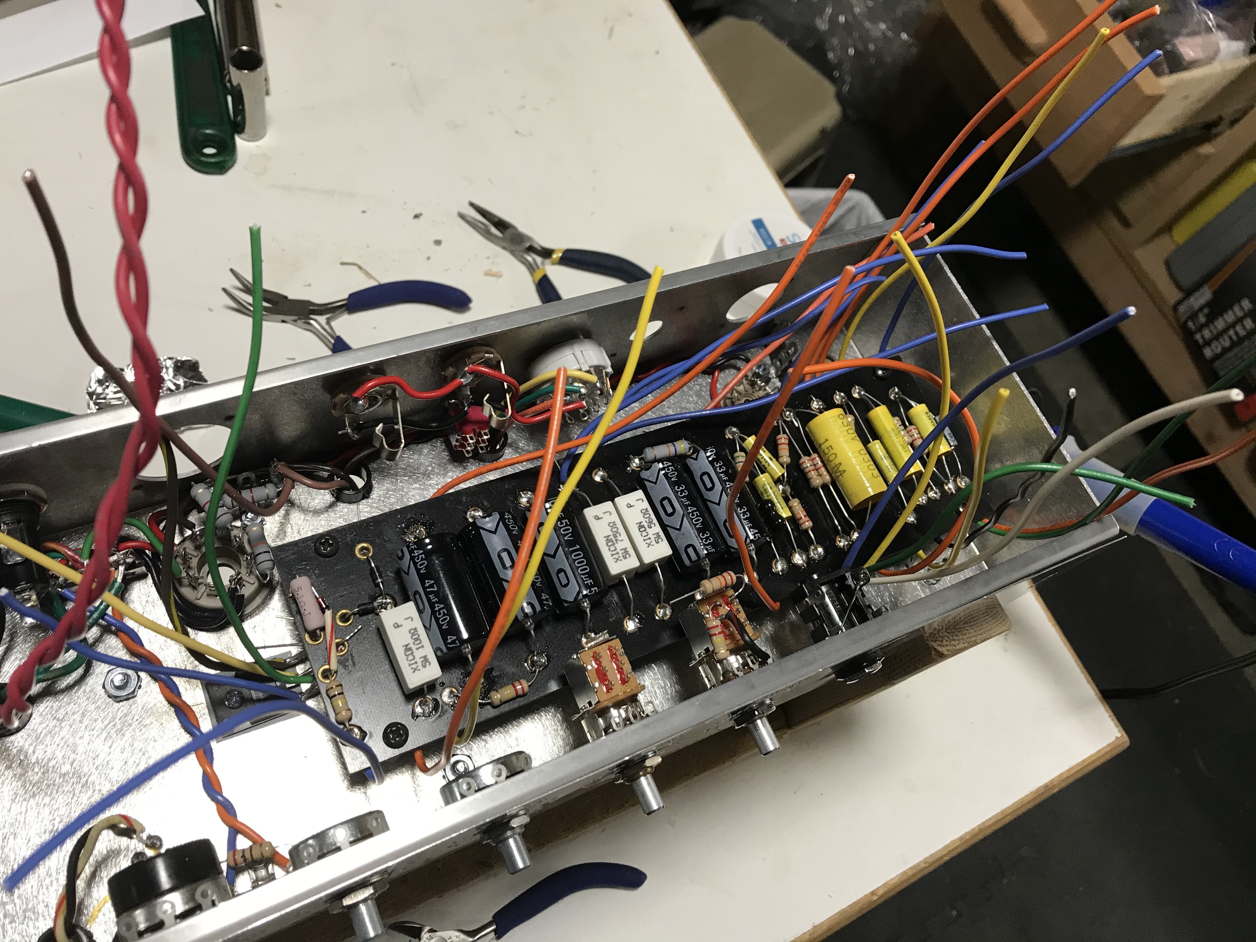

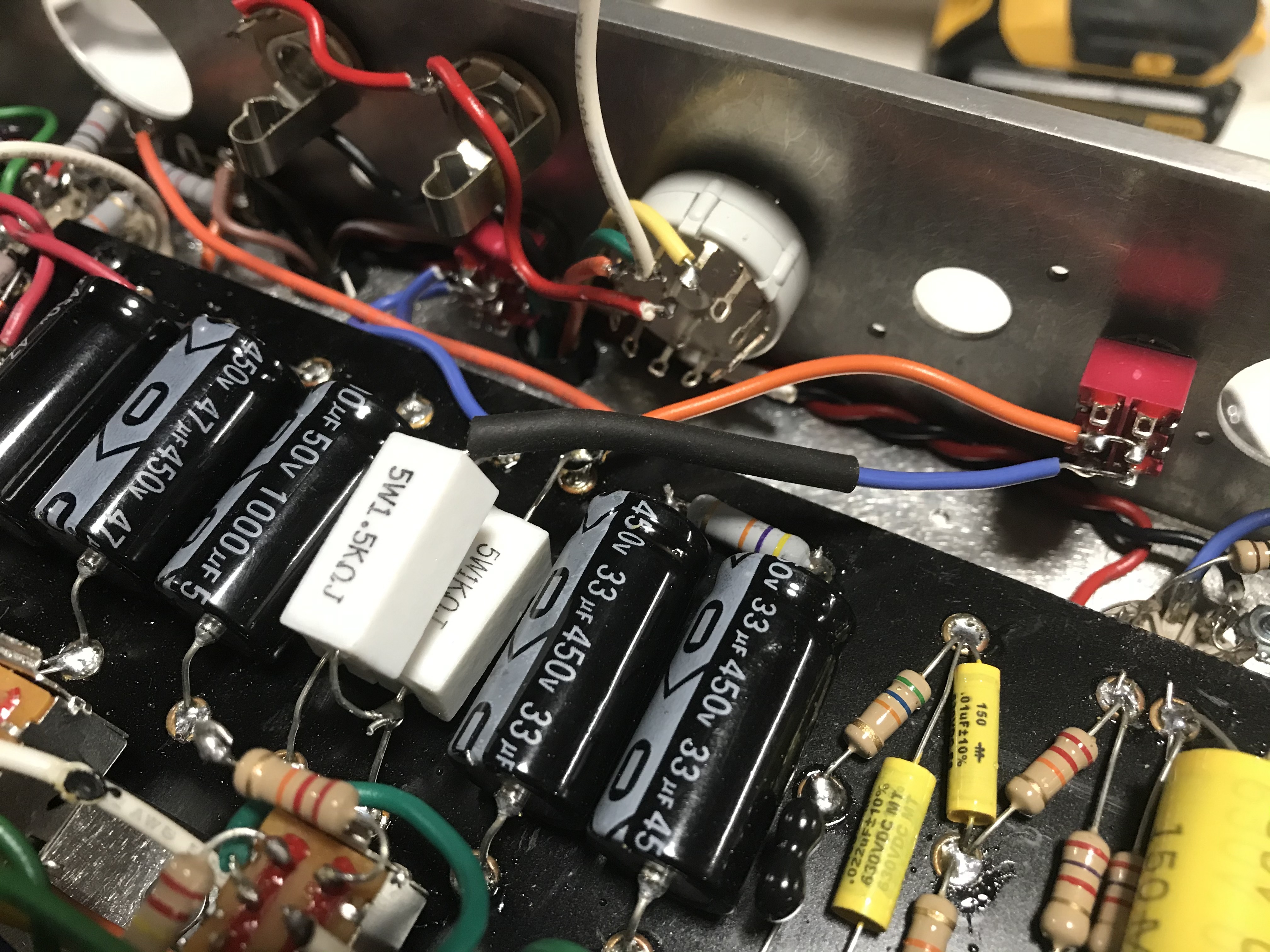

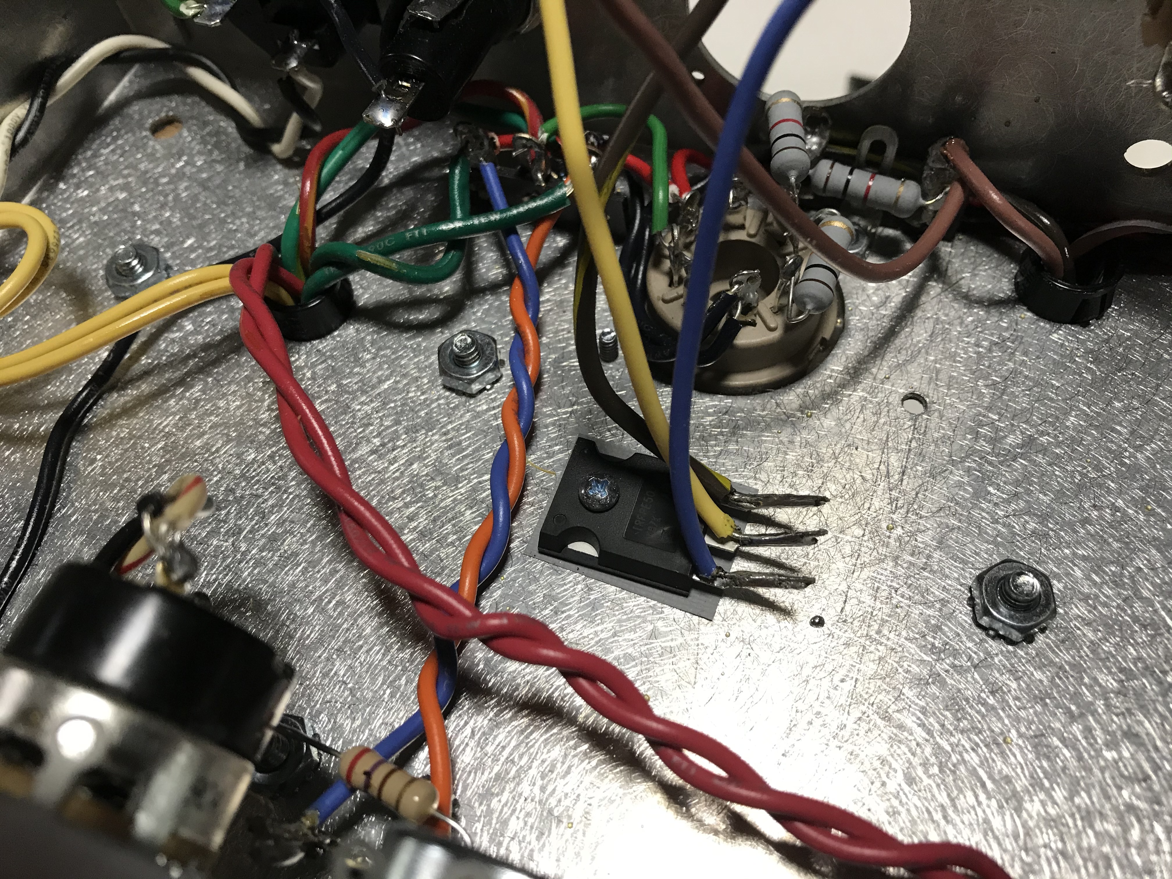

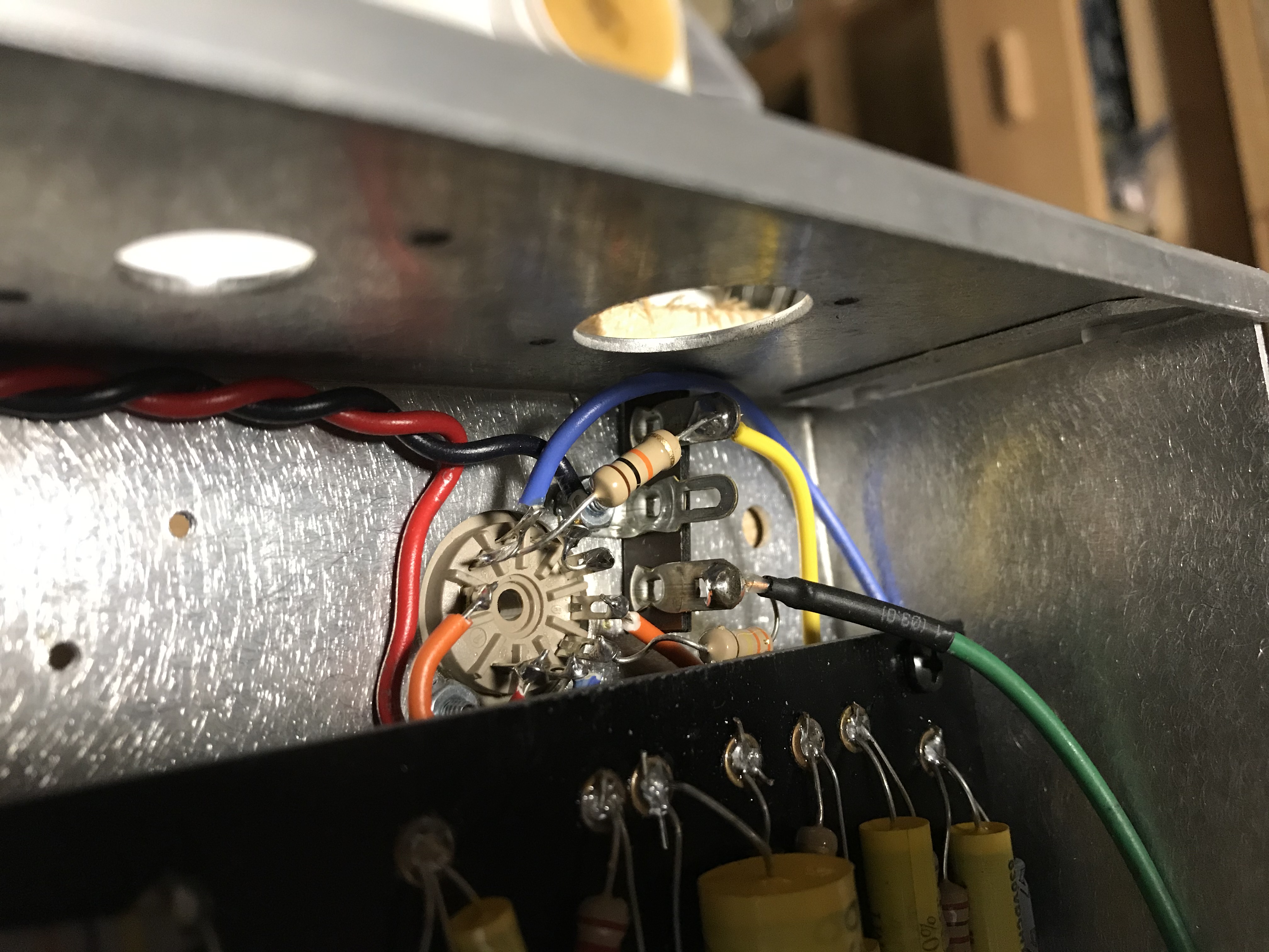

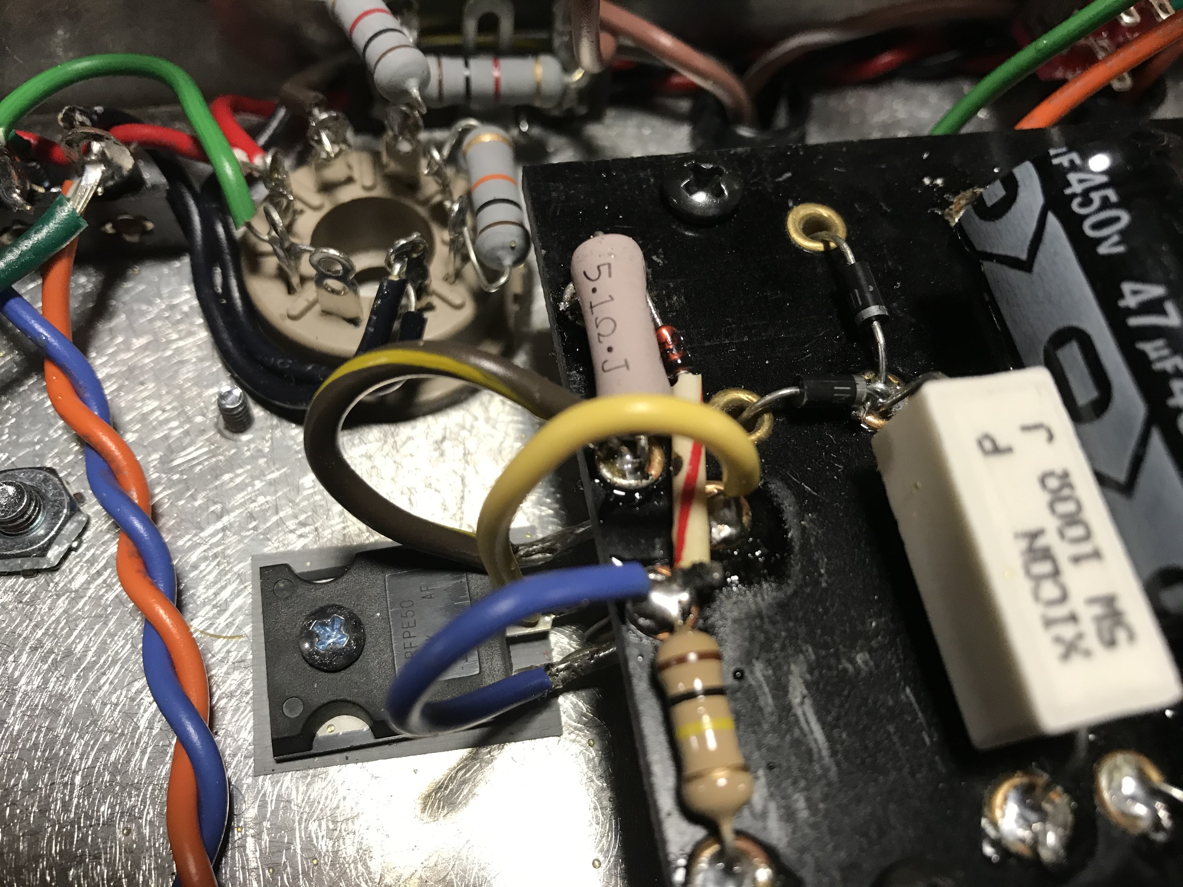

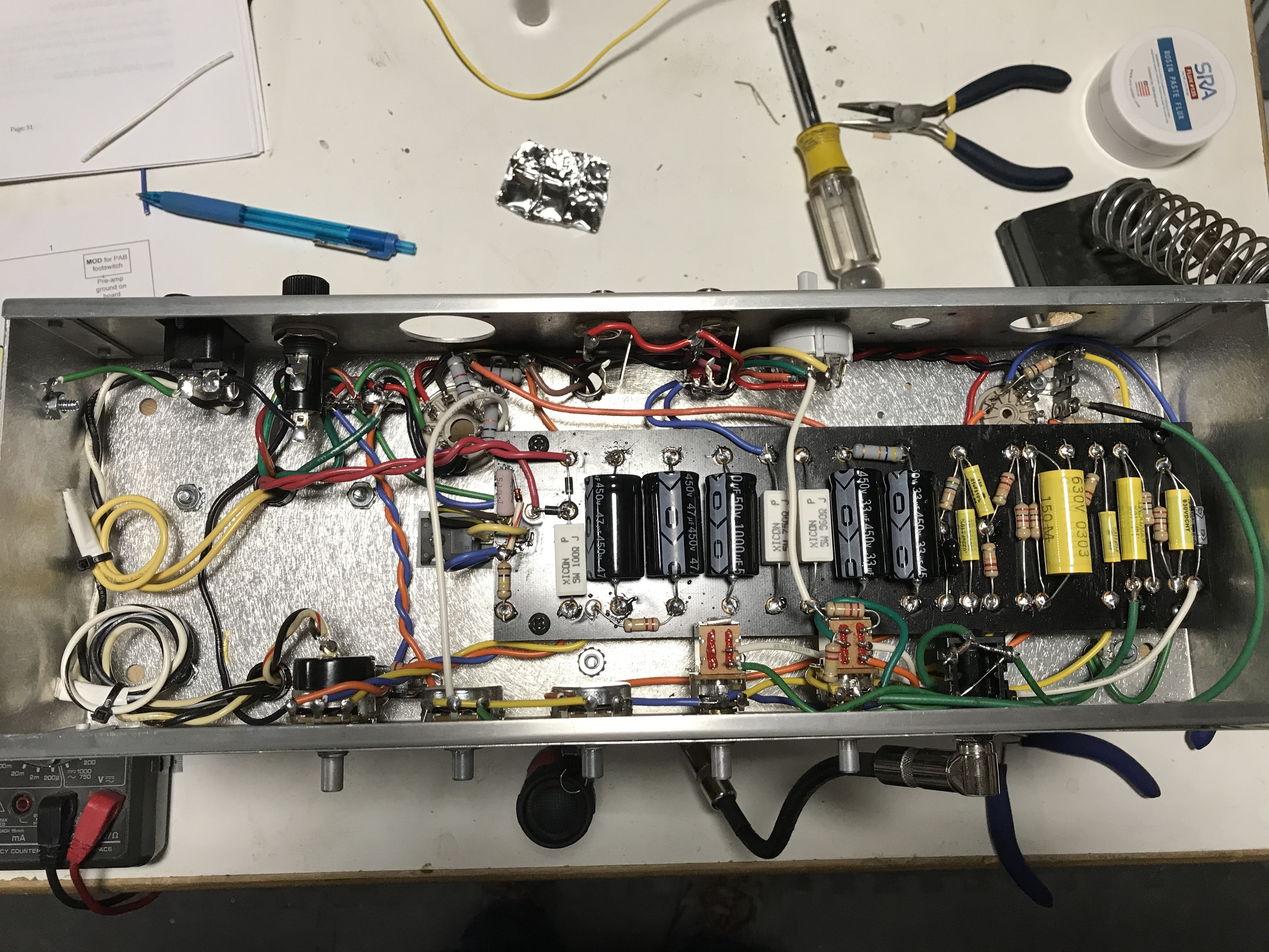

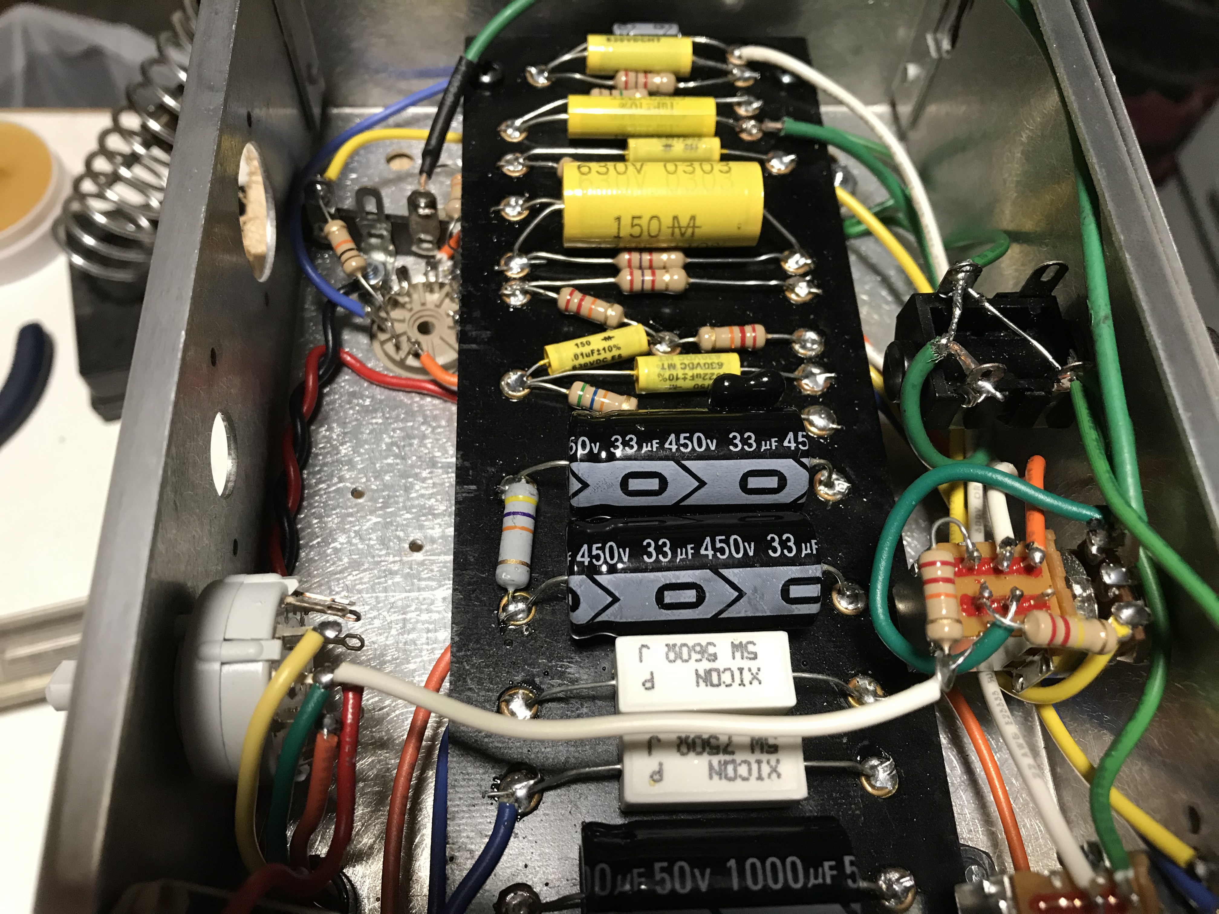

Finished the build. Here's some pictures. Testing is next.
File comment: Mosfet leads wired up

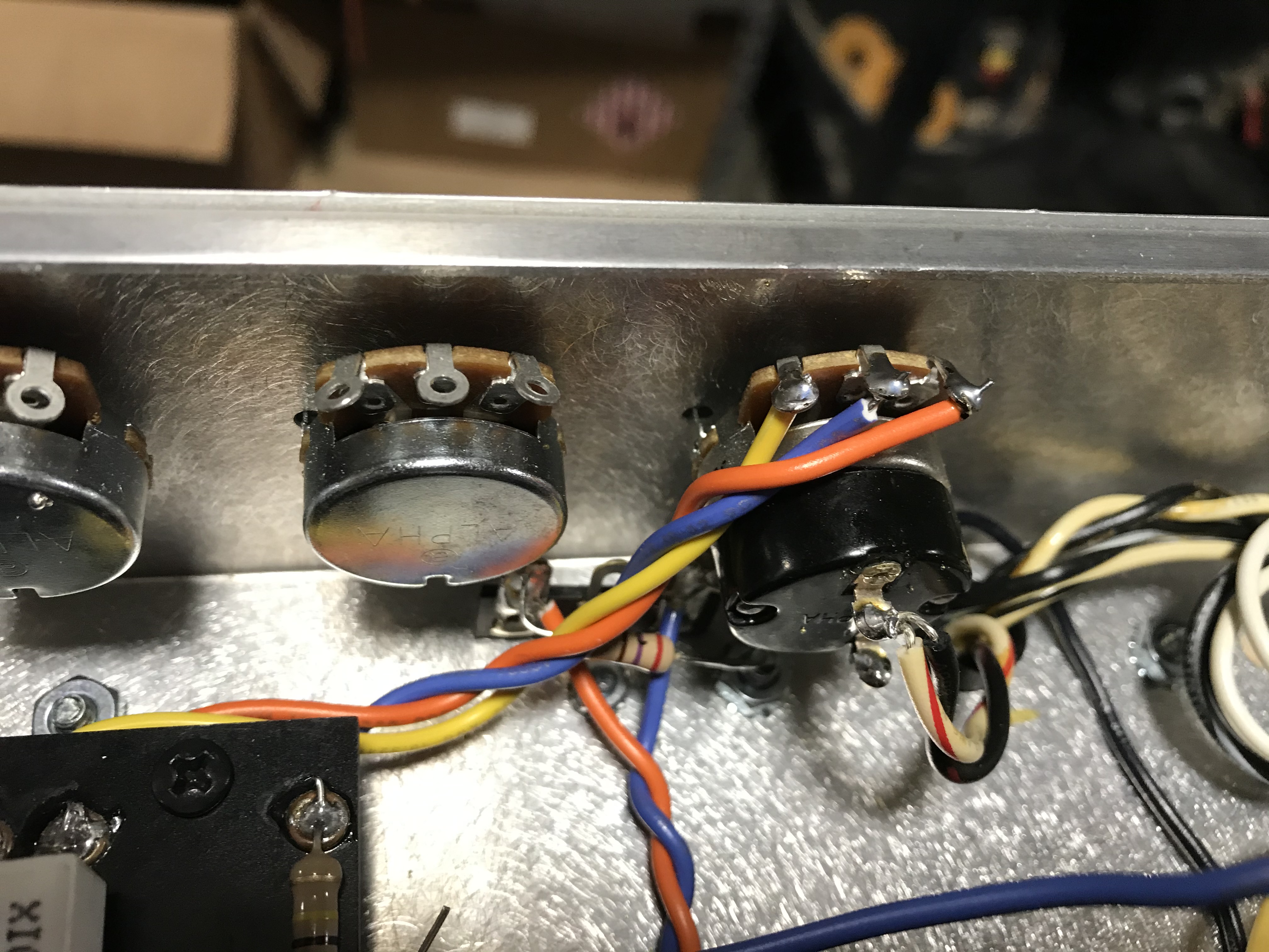

File comment: Power Level knob soldered
File comment: Mosfet soldered to board

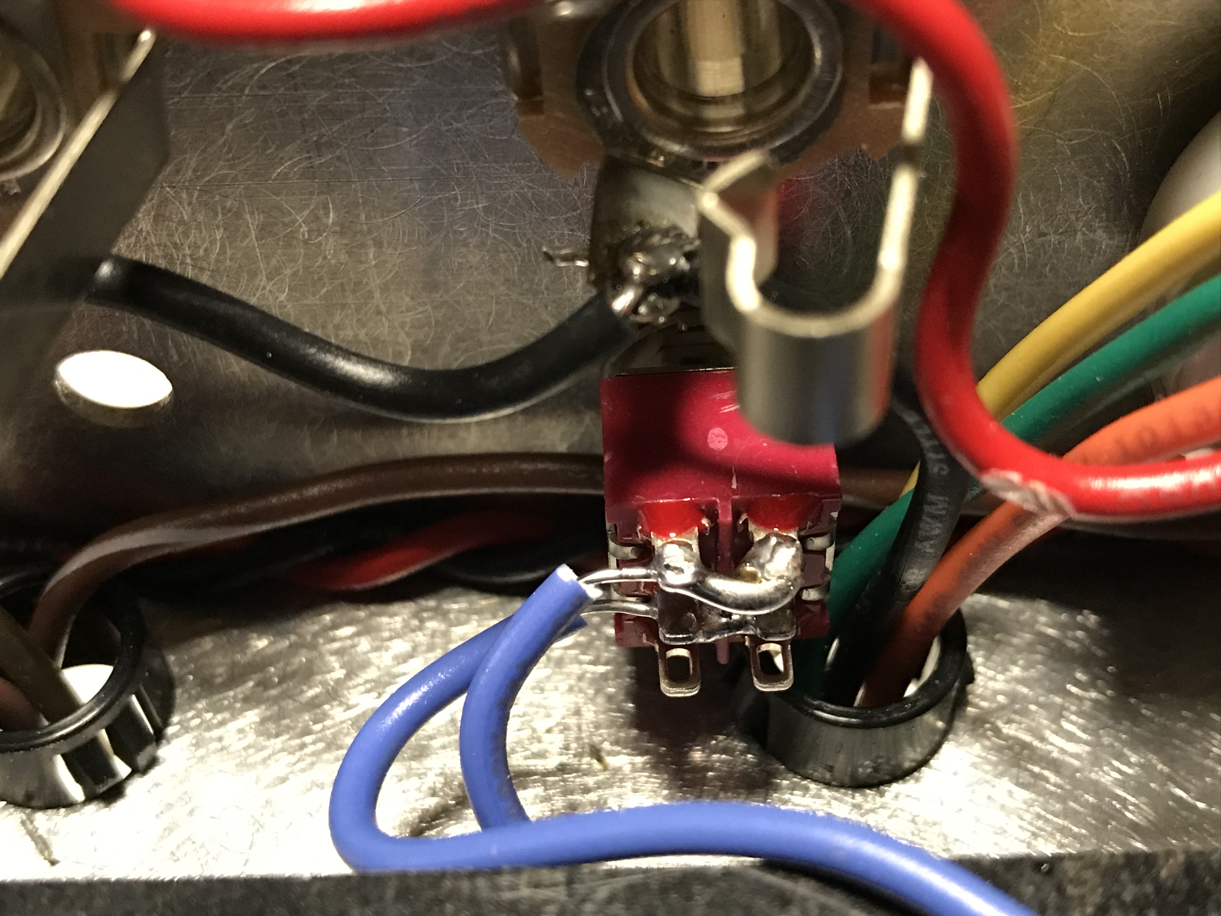

File comment: Bias switch soldered

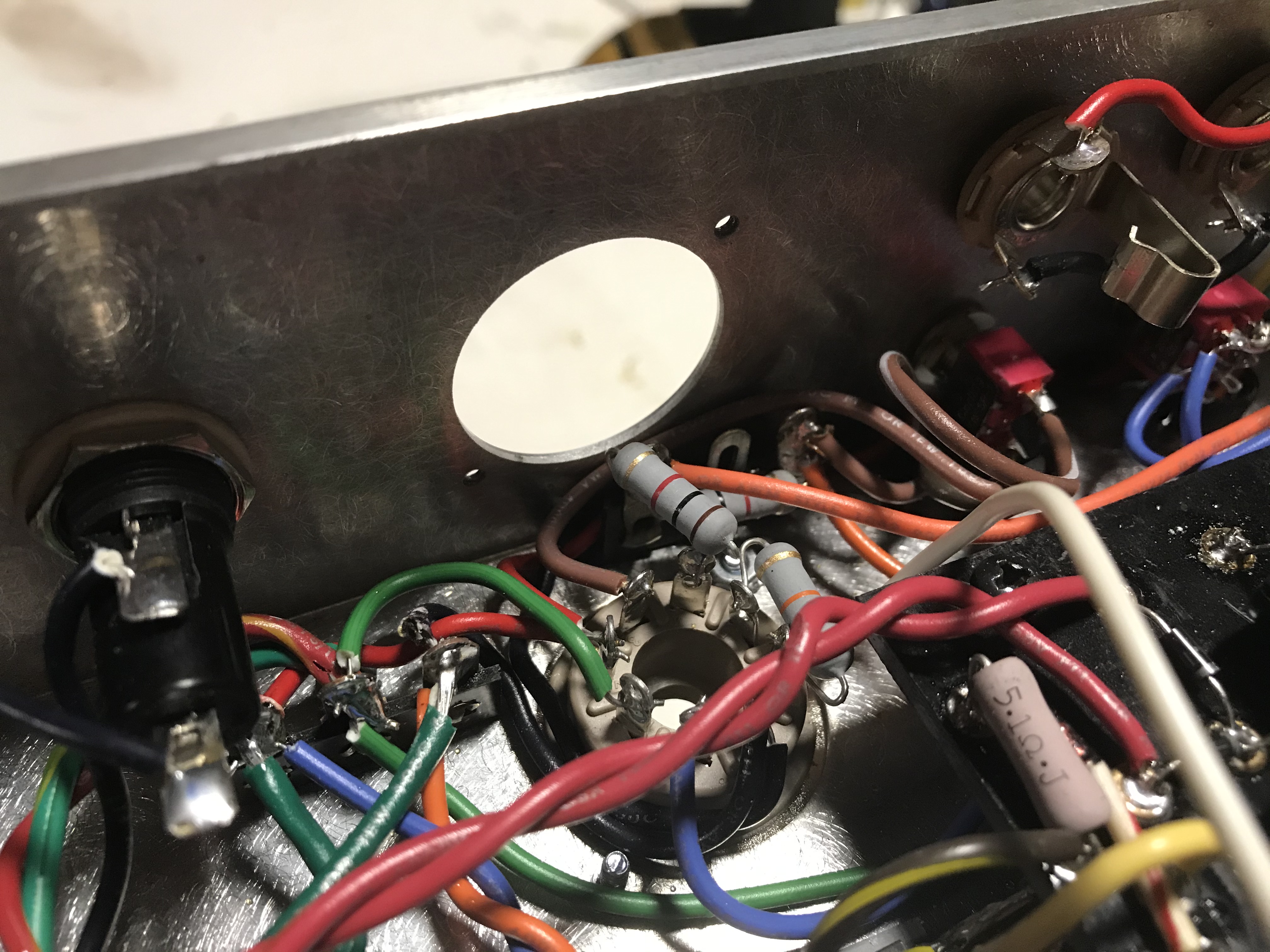

File comment: Preamp Socket soldered

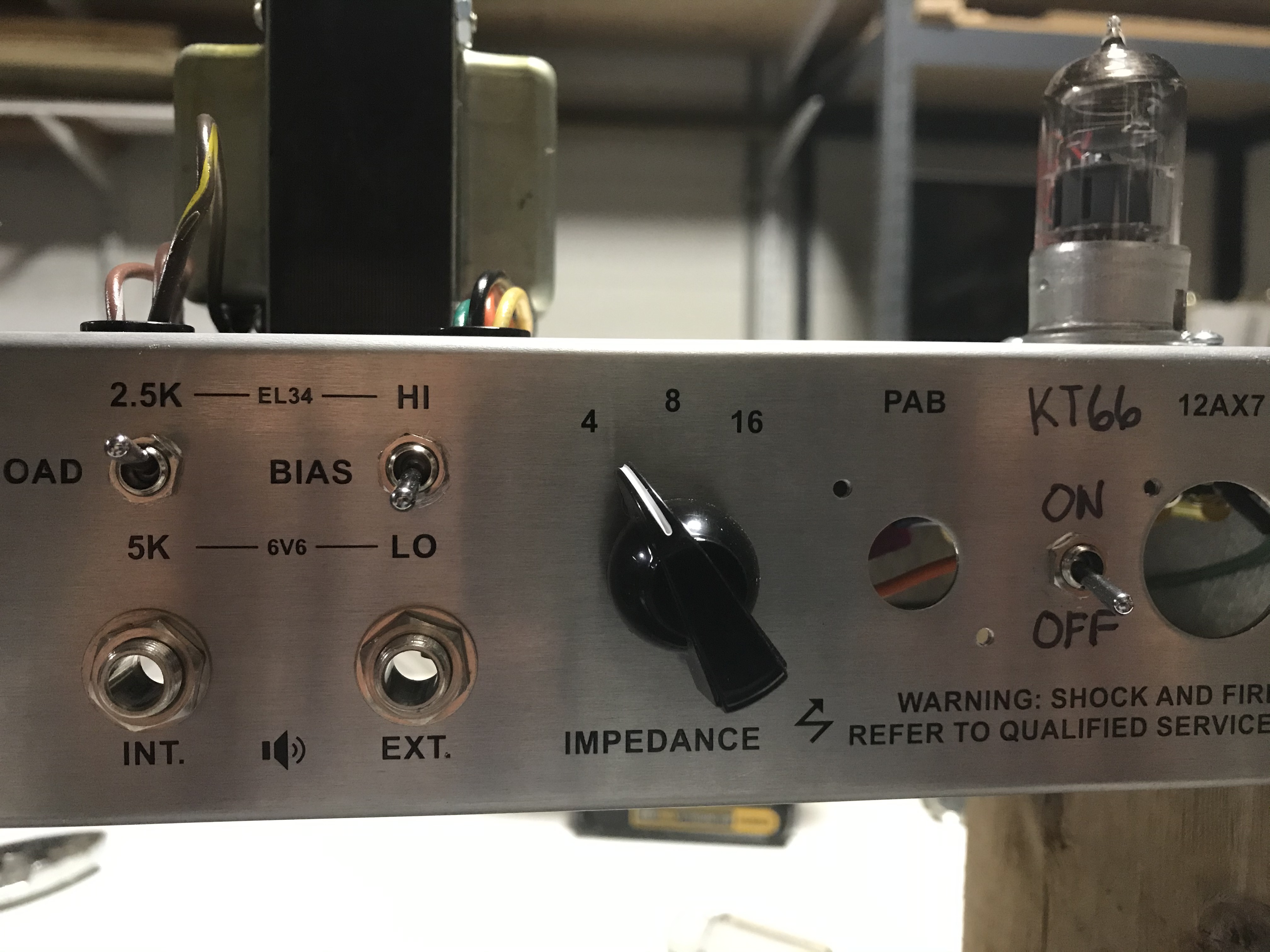

PostPosted: Sun Jan 24, 2021 5:23 pm
Posts: 23
Today I added the OT switch for EL34s, and modified it to use KT66's.
The KT66 mod suggested is to replace the 560 ohm resistor with a 1kohm. So I did that onto the board. But then I wired a 1k5 ohm in parallel with it to a switch so that when the switch is OFF, it is 600 ohms (close to the original 560). But when the switch is ON, it does nothing and only the 1k is active for the KT66.
File comment: OT switch for EL34's
File comment: 1k5 over the top of 1k ohm for KT66
File comment: ON - just 1k for KT66.
OFF - 1k in parallel with 1k5 = 600 ohms
PostPosted: Thu Dec 30, 2021 11:12 am
Posts: 23
I’m getting similar minimal impacts from my bass and treble pots……any thoughts on how to increase their effectiveness?
