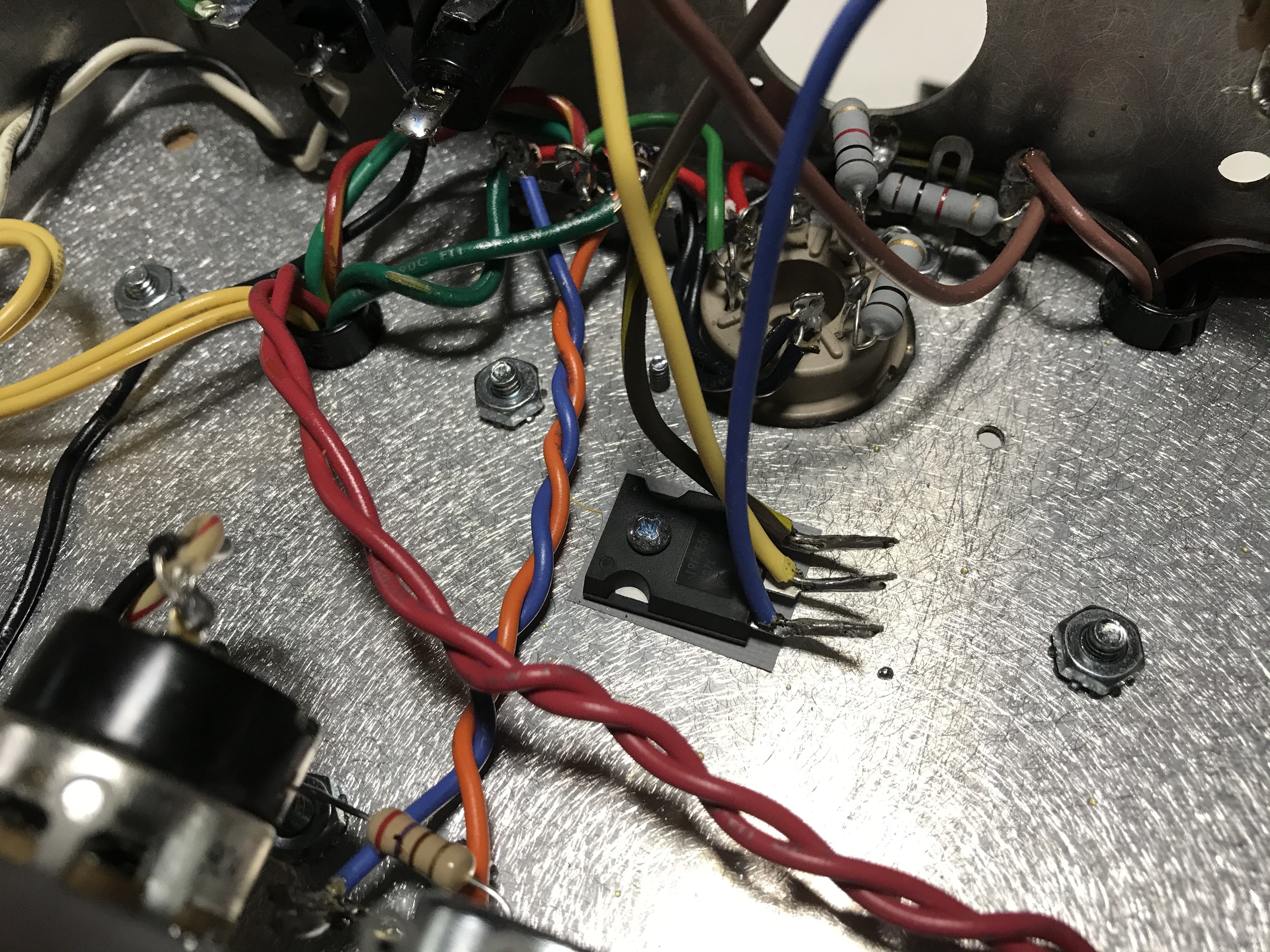

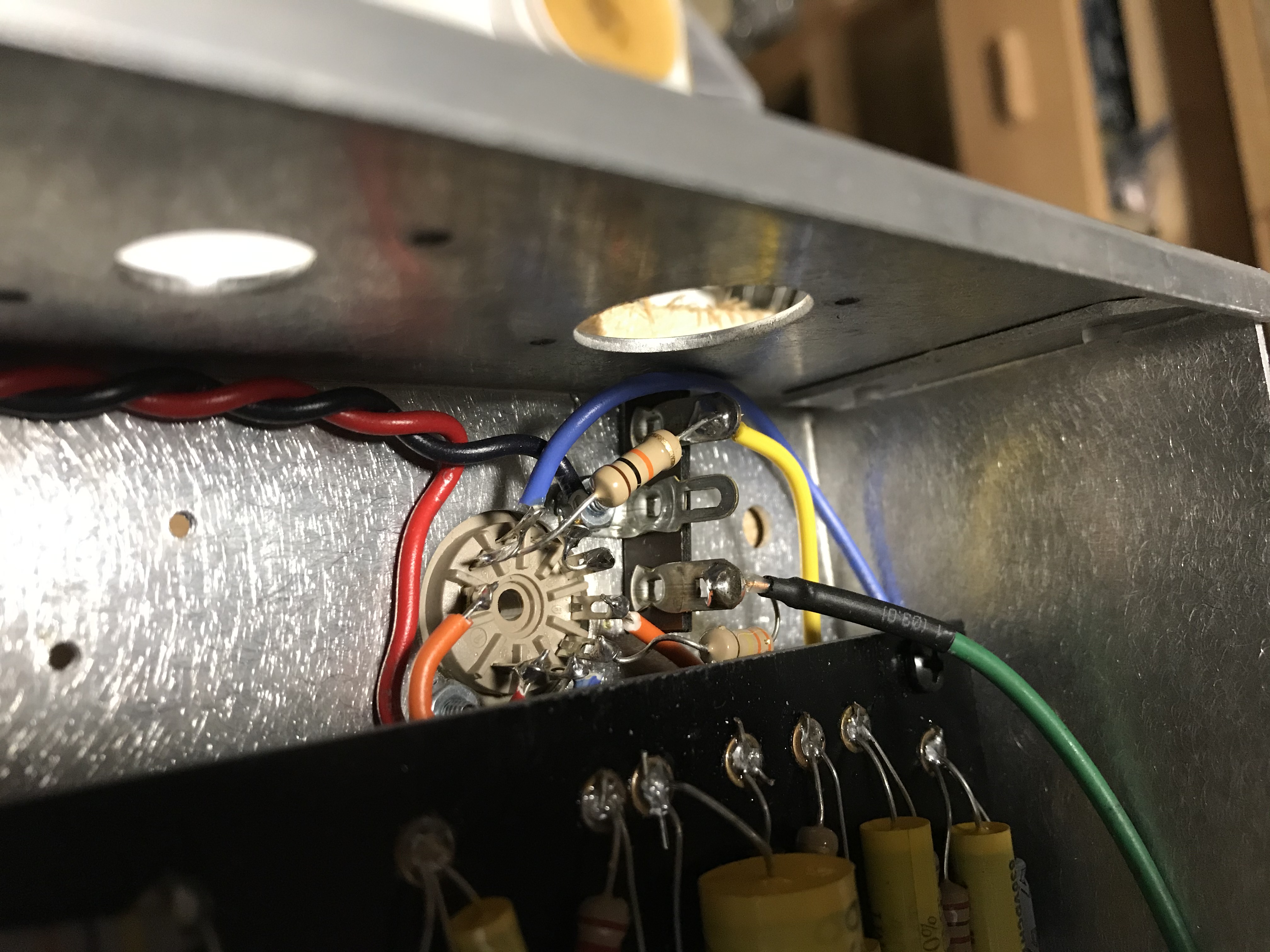

Finished the build. Here's some pictures. Testing is next.
File comment: Mosfet leads wired up

File comment: Preamp Socket soldered

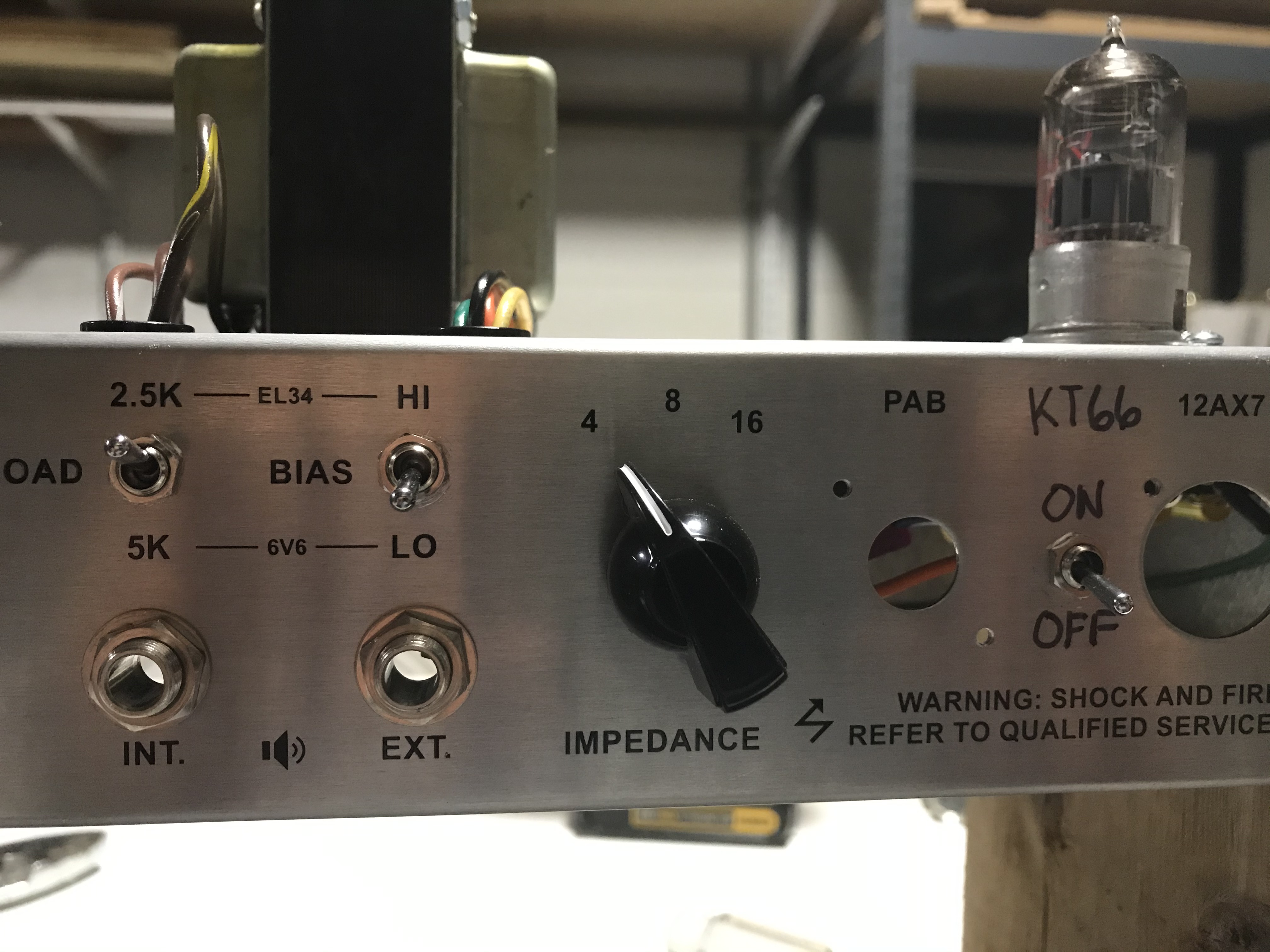

PostPosted: Sun Jan 24, 2021 5:23 pm
Posts: 23
Today I added the OT switch for EL34s, and modified it to use KT66's.
The KT66 mod suggested is to replace the 560 ohm resistor with a 1kohm. So I did that onto the board. But then I wired a 1k5 ohm in parallel with it to a switch so that when the switch is OFF, it is 600 ohms (close to the original 560). But when the switch is ON, it does nothing and only the 1k is active for the KT66.
File comment: OT switch for EL34's
