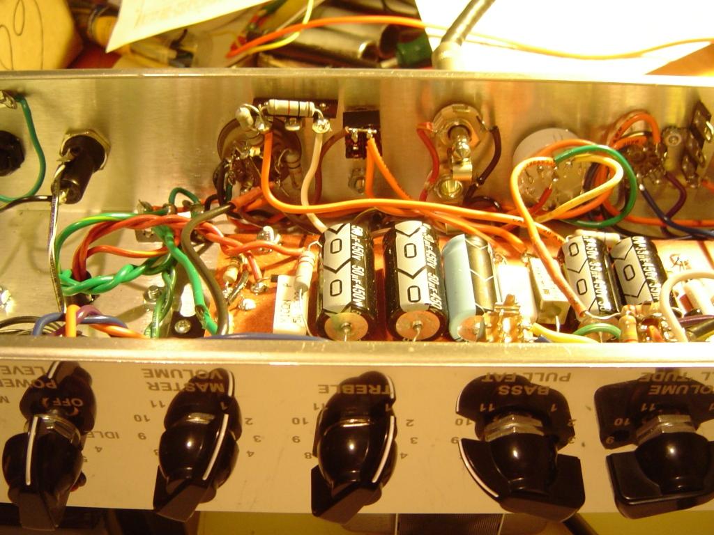

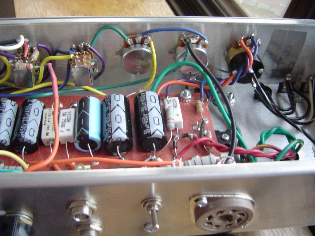

Hello all,
I have been reading the forums here off and on here for the last few years, and decided to take the plunge with the Tramp a few weeks ago. Like Sergelac I was planning on two-stroke project, but then this Tramp came along.

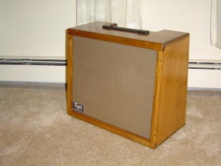

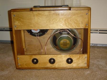

The cabinet is done. I had a local cabinet builder custom build it(i don't know if I am allowed to mention the company?). Solid pine with dovetail joints, it is as solid as a tank. He did a really nice job on it. I stained it with early American stain with clear gloss polyurethane.
I decided on the Tone Tubby 8" alnico and a Celestion 10" Greenback combo. I have them wired so that I can use them independently at 8 ohms or together at 4 ohms.
These forums have been a great help. I am a complete newbie at this. I have the amp completed, but I am having some issues. I am checking everything over and hoping I will have success soon.

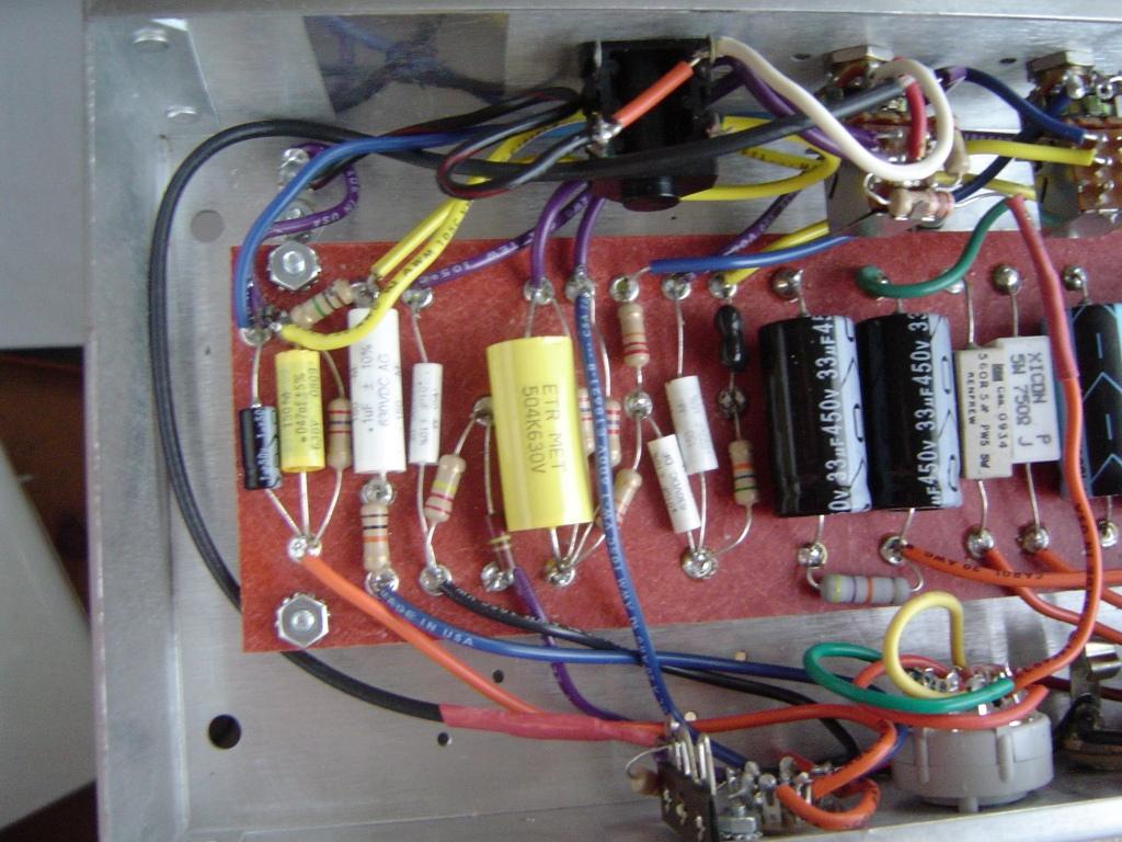

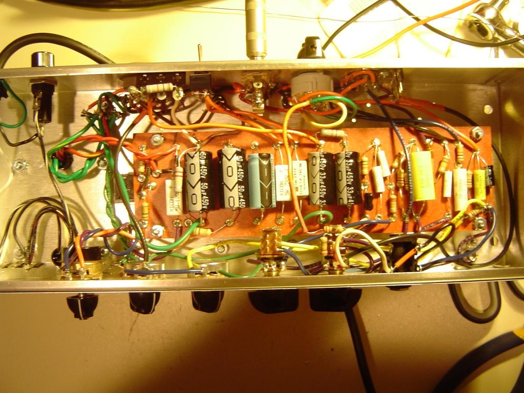

Certainly, right now I have no output. Please forgive me as I am a rookie.
Perhaps this post will be a good reference for others.
PostPosted: Sun Jun 27, 2010 9:57 pm
Can you get some more closeups, less flash, macro setting? It's kinda hard to tell whats going on in there.
I'd start by working through the layout, crossing off wires on the layout as you check the build to make sure they are correct. You could shorten up/re-route some of the runs while you do this.

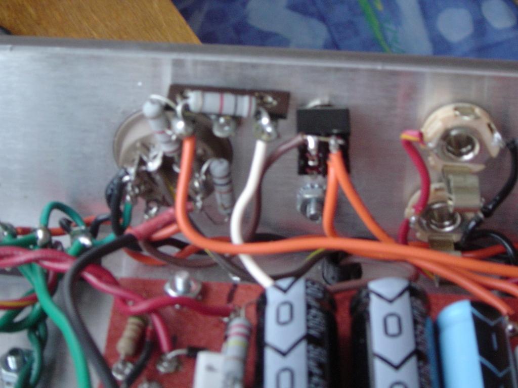

With no tubes installed, the power level does not change at the first filter cap. I get no DC voltage at the first cap. Only the second cap has voltage applied.
PostPosted: Mon Jun 28, 2010 8:46 am
Check your jumpers then. Use the continuity function on your DMM.
With no tubes (no load essentially) the VRM will do nothing and behave kinda weird. Put tubes in and check it again.
PostPosted: Mon Jun 28, 2010 9:10 am
Joined: Sun Jun 27, 2010 7:38 pm
Posts: 9
Location: Guelph
OK. With the tubes in, still no change with the VRM. The tube heaters do work though.
PostPosted: Mon Jun 28, 2010 9:23 am
Did you insulate the MOSFET from the chassis? Sounds like you need to go back to basics and check the power supply wiring.
If you didnt insulate the MOSFET, it's probably pooched. Need some close up/aerial views of the power end of the amp.

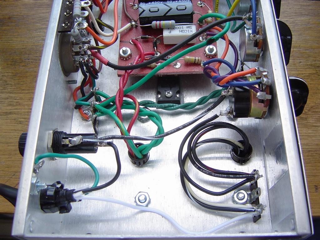

I installed the insulator between the mosfet and the chassis. I also smeared them with dielectric grease.

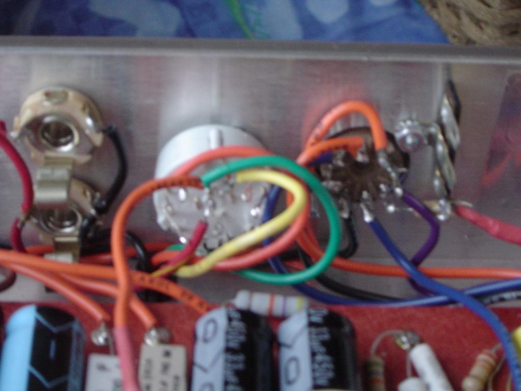

PostPosted: Mon Jun 28, 2010 1:07 pm
Looks like your 6L6/6V6 switch may be wrong. The impedance rotary switch also looks to have the NFB wire (the orange wire running in the air from one side to the other) hardwired right to one of the secondary taps.
I'd check your jumpers as well, they can be easy to miss. Though you have some suspect joints and possible shorts (hard to tell, espically around the PP pots) there is no obvious errors.
PostPosted: Mon Jun 28, 2010 1:11 pm
That grease may not be a good thing. Those grey Sil Pads are not designed to have grease on them and some dielectric grease (as in for CPUs) is conductive. Besides kurtlives comments, suggest you check on that.

I connected the NFB wire to the 8 ohm tap. Is that incorrect?

PostPosted: Mon Jun 28, 2010 4:00 pm
Wire as per the layout / schematic. The 8 ohm tap will have a signal on it even when it is not connected to a speaker. Feedback is designed to work off the 8 ohm tap. Same as on the TRIWATT, JTM45 etc.
