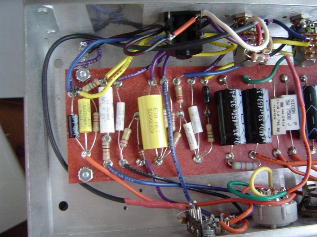

Certainly, right now I have no output. Please forgive me as I am a rookie.

PostPosted: Sun Jun 27, 2010 9:57 pm
Can you get some more closeups, less flash, macro setting? It's kinda hard to tell whats going on in there.
I'd start by working through the layout, crossing off wires on the layout as you check the build to make sure they are correct. You could shorten up/re-route some of the runs while you do this.

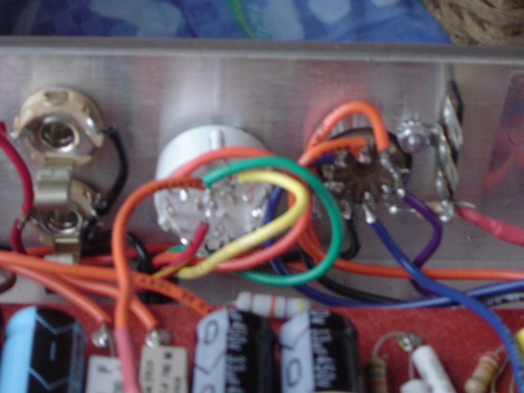

PostPosted: Mon Jun 28, 2010 1:07 pm
Looks like your 6L6/6V6 switch may be wrong. The impedance rotary switch also looks to have the NFB wire (the orange wire running in the air from one side to the other) hardwired right to one of the secondary taps.
I'd check your jumpers as well, they can be easy to miss. Though you have some suspect joints and possible shorts (hard to tell, espically around the PP pots) there is no obvious errors.
