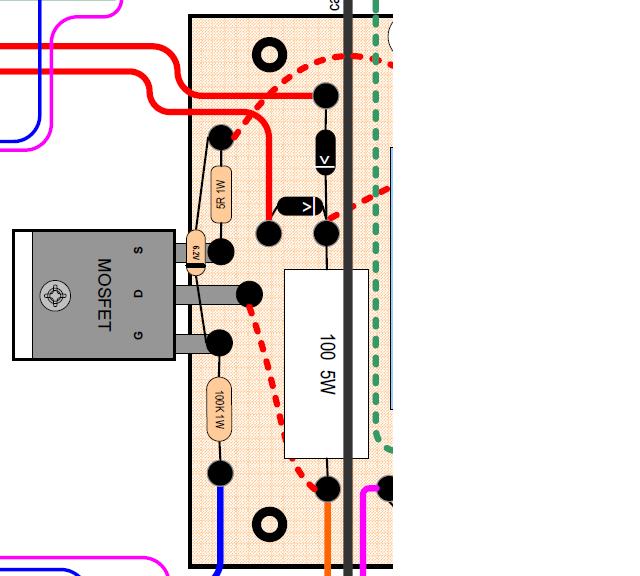

zener. Hard to tell negative end.??does it go between mosfet resisters? Hard to see in pic's.

Check the layout. There is a band at the cathode of the zener, it points 'towards' the MOSFET.

Or to explain a little further, the cathode (stripe end) is the one shown on the schematic as a crooked bar. HTH

..which would be this...
