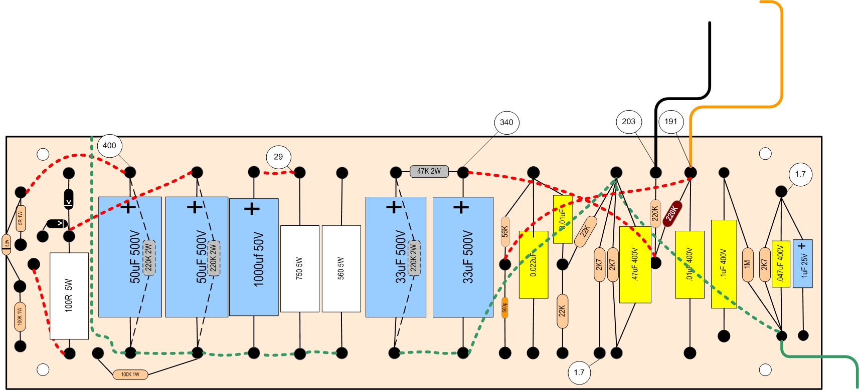

LarsOK -this is interesting. Now that you say that, I'm looking at other build pics and everybody has the negative end towards the front panel. My layout clearly has the '+' towards the front panel... what am I missing?
 Post subject: Re: Almost there!!
PostPosted: Sat Jun 25, 2011 4:48 pm
My Bad!! :oops:
I flipped them around on the last layout revision and never noticed that. They should be like this.
Also, probably need to reverse the two other wires on the 12AX7. We need to chat about that.
