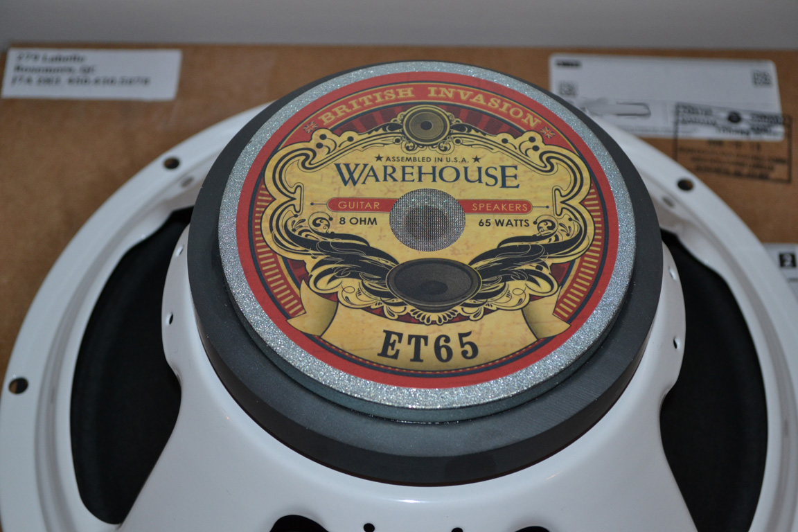

The speaker is the first to part received (delivered on Sunday!?!) :

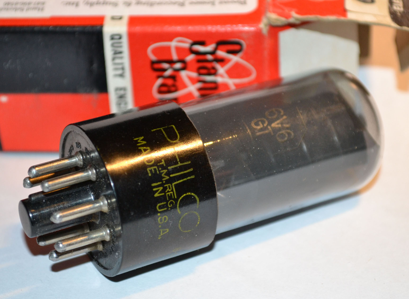

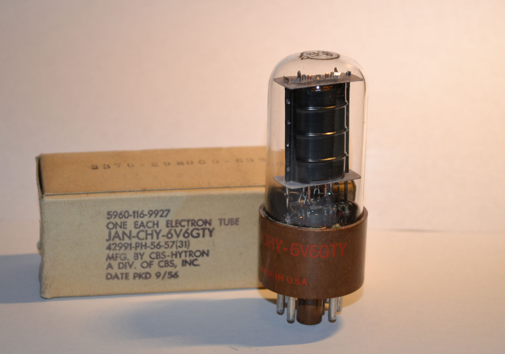

Some nice NOS tubes just delivered. They come from Brent Jessee Recording & Supply http://www.audiotubes.com/ :
Jan CBS-Hytron 6V6GTY (a military spec 6V6GT)
Philco branded, smoked glass 6V6GT made by RCA

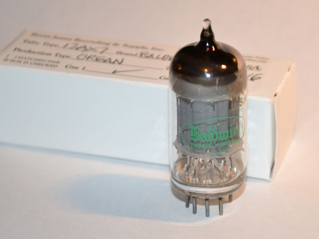

Baldwin branded 12AX7 made Sylvania

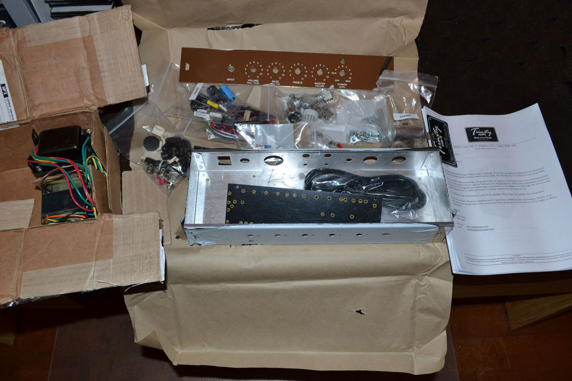

The kit just arrived (ok, some days ago) !!!
Checked the parts against the BOM, and now I'm reading the assemby guide; it contains important infos on how to approach the build, and in which order things should be done...

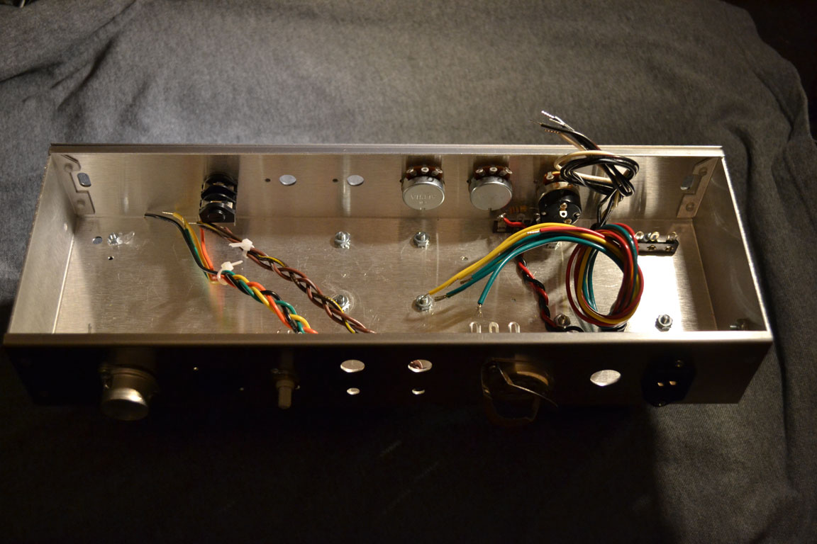

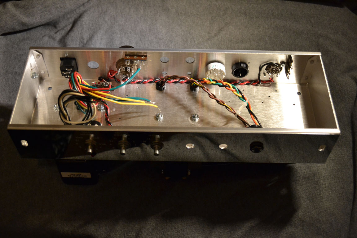

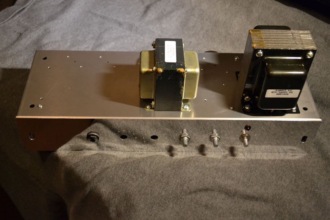

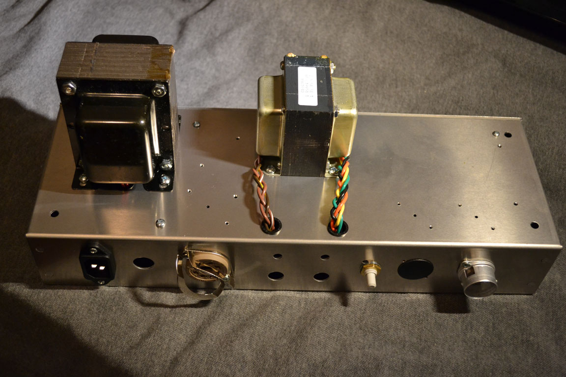

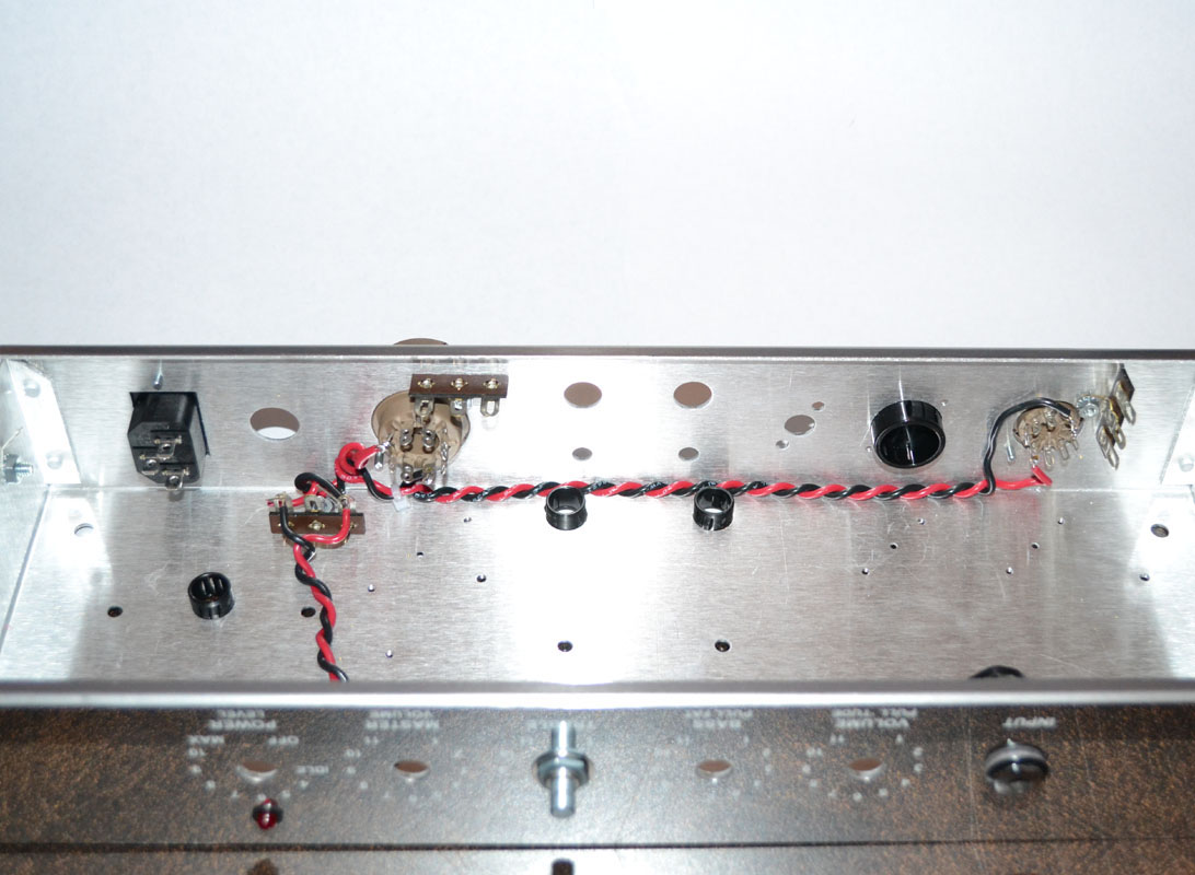

Finally some time to start the build :
Some mechanical assembly, and heathers wiring :

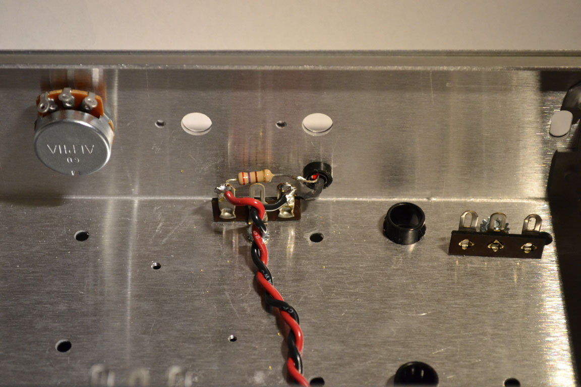

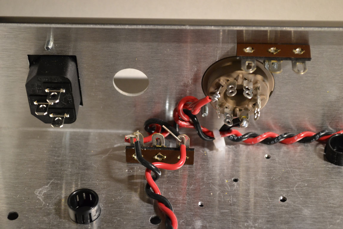

Details of the octal socket, note that my chassis is a recent version which use a IEC receptacle instead of a fixed cord. The fuse holder moved over the power ground teminal strip, so I will complete this strip before installing the fuse holder and wiring the power transformer primary.
LED wiring :
More parts added, and transformers mounted :
I know, the input socket is upside down, for now it is there only to help align the faceplate :

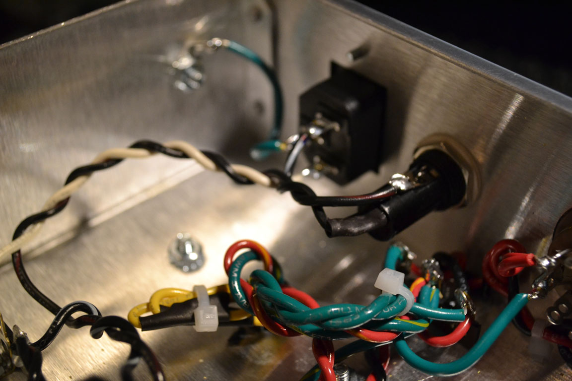

Wired the power ground/heaters supply terminal strip :
And the power transformer primary :

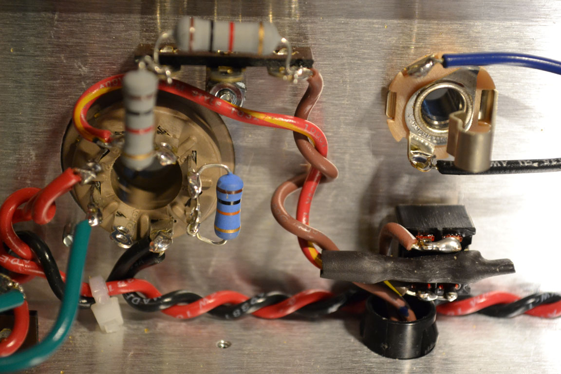

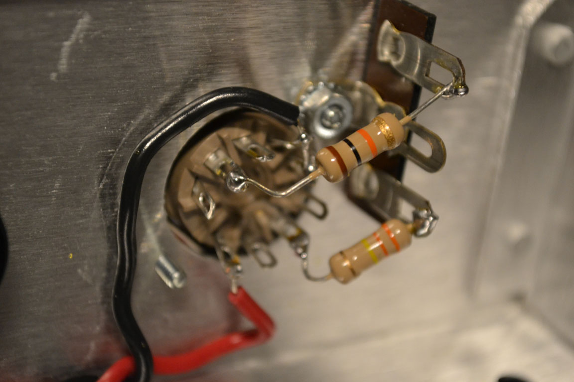

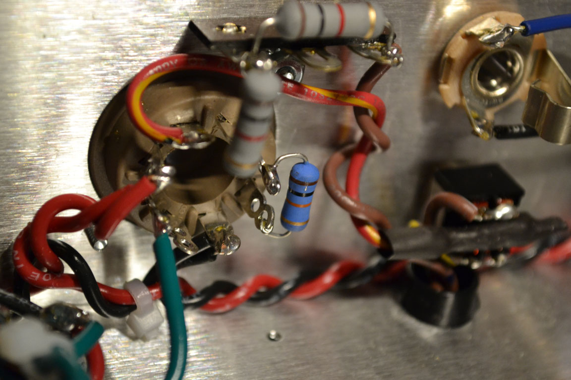

Adding resistors to the tube sockets, and wiring the output transformer :

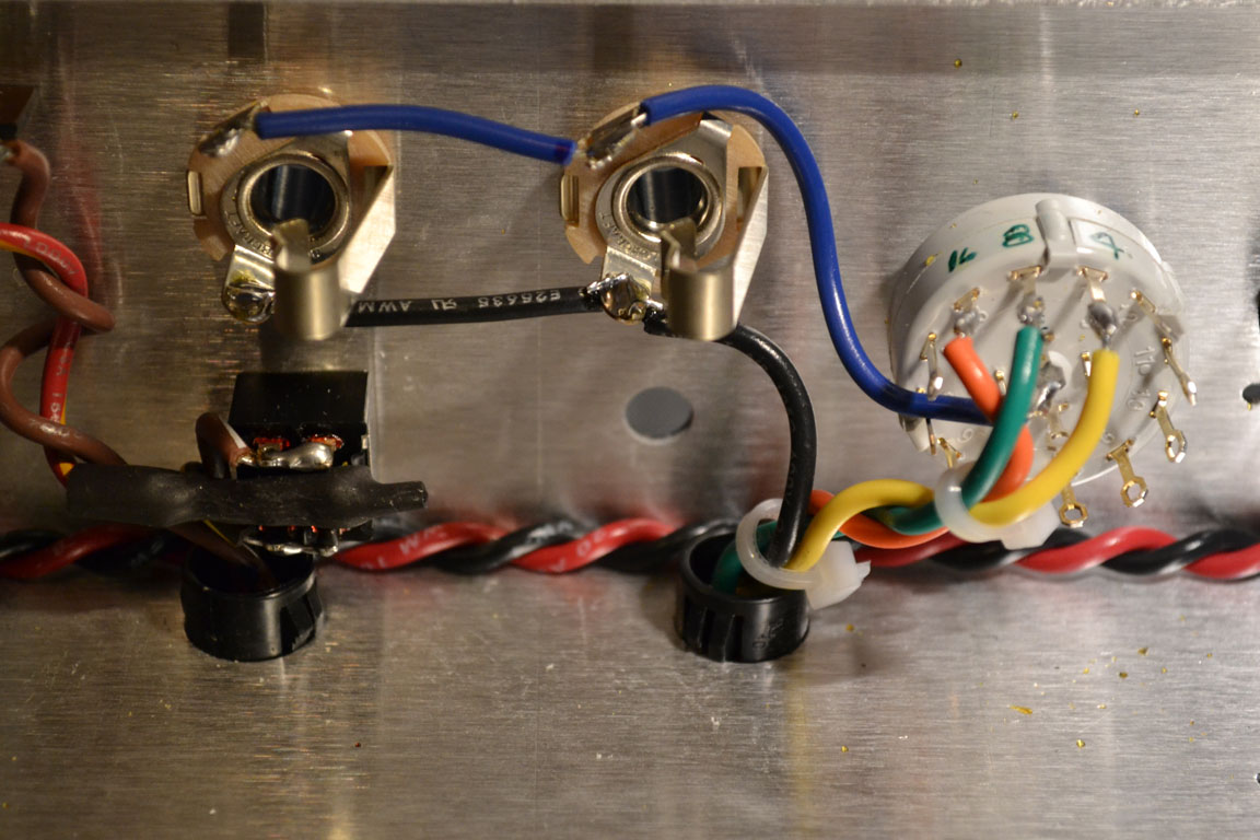

The speaker impedance selection switch :

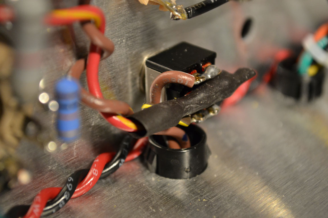

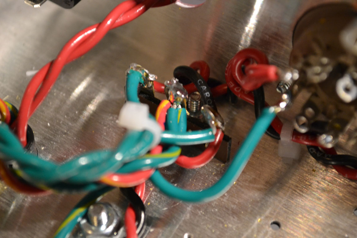

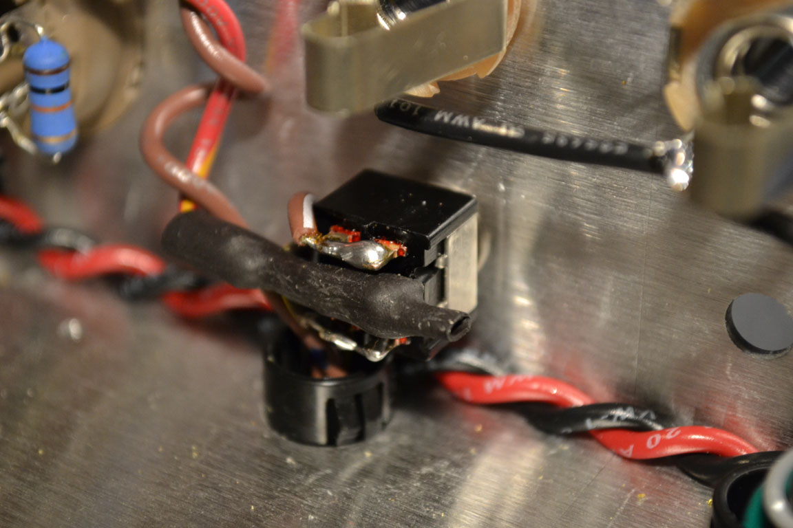

And the switch to select between 5k and 2.5k output transformer primary. Not sure that I will try a EL34 soon, but the tap exist, so I want the possibility to use it. As someone reported some arcing between switch solder lugs, I tried a piece of shrink wrap on the common lugs (both side of the switch are used, to divide the current between them).
Details :
And to what is what :

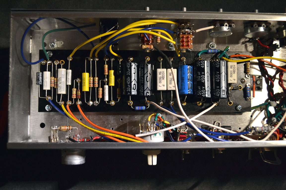

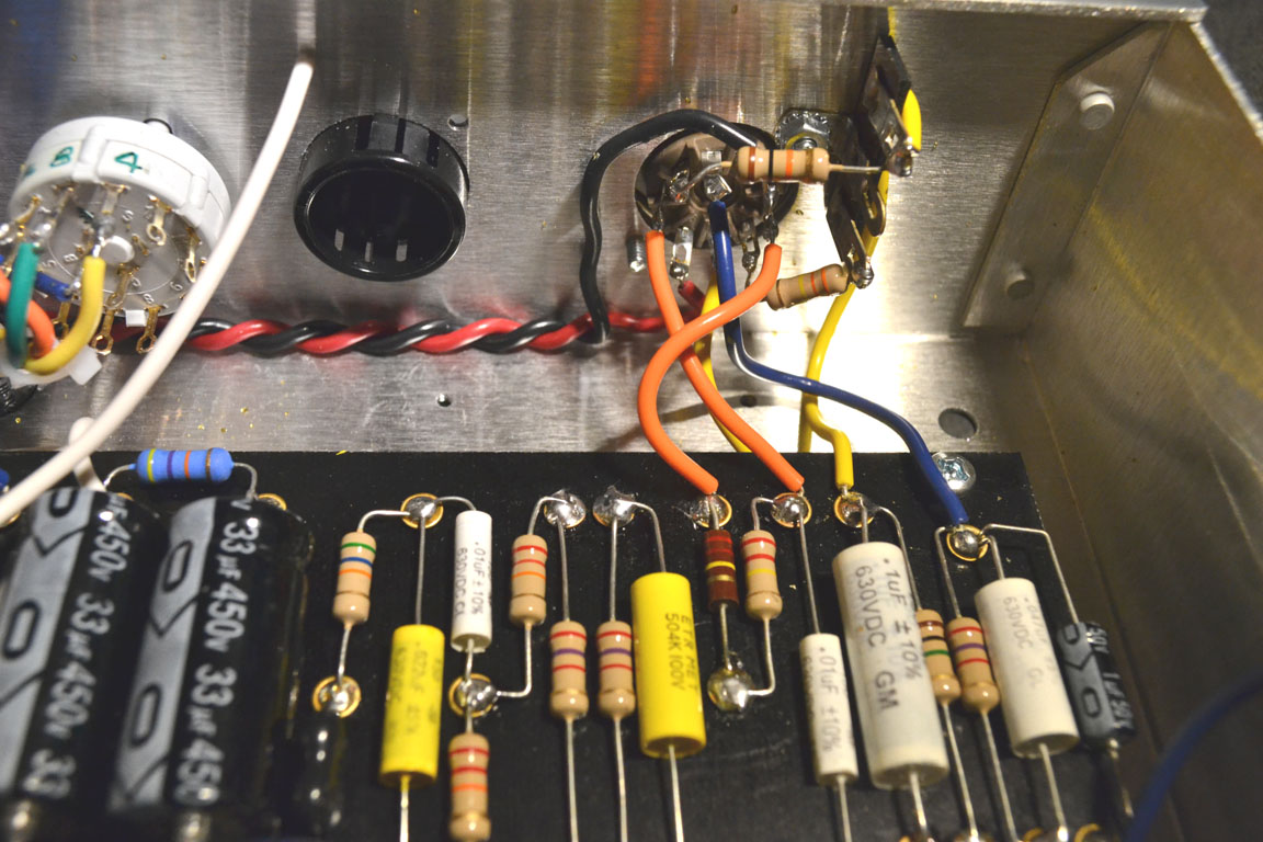

PostPosted: Wed Feb 15, 2017 1:41 pm
Joined: Tue Dec 06, 2016 1:26 pm
Posts: 31

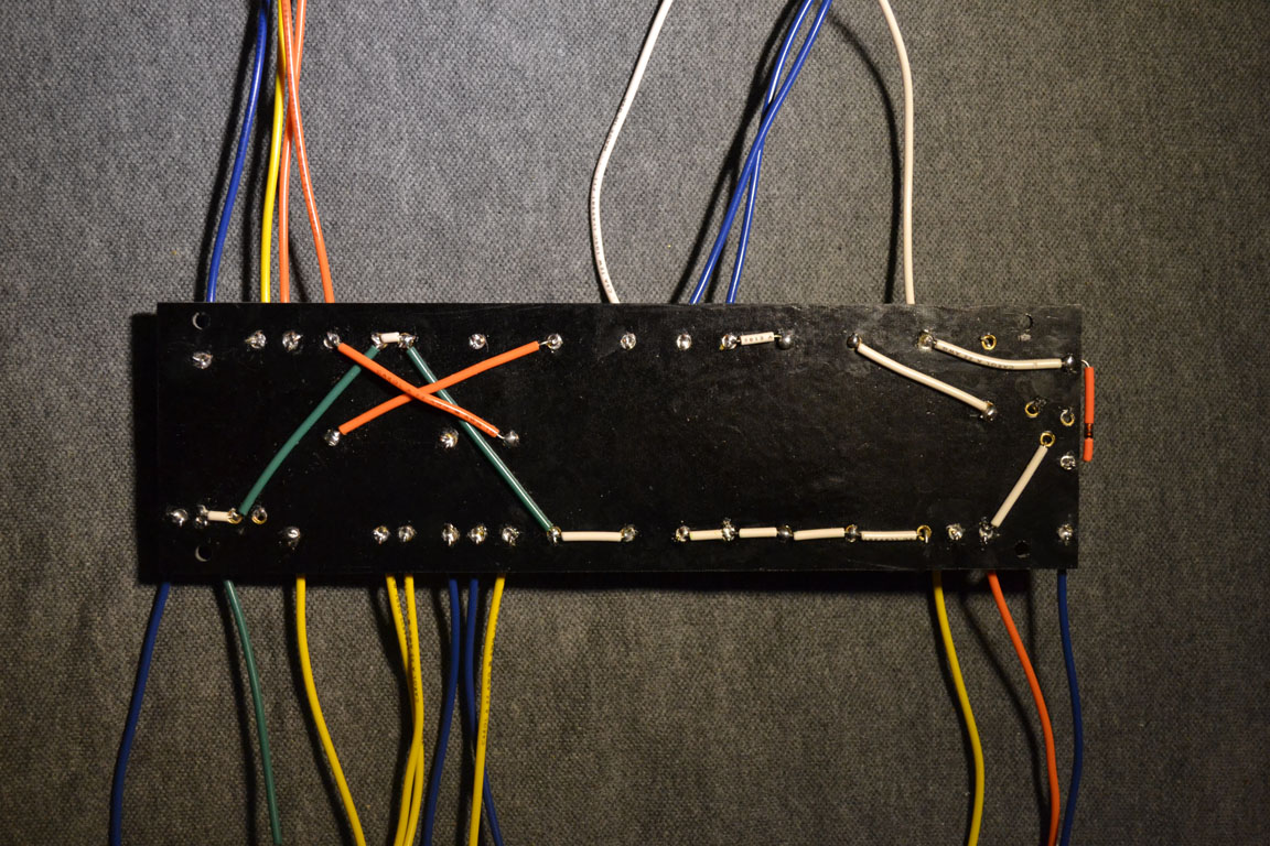

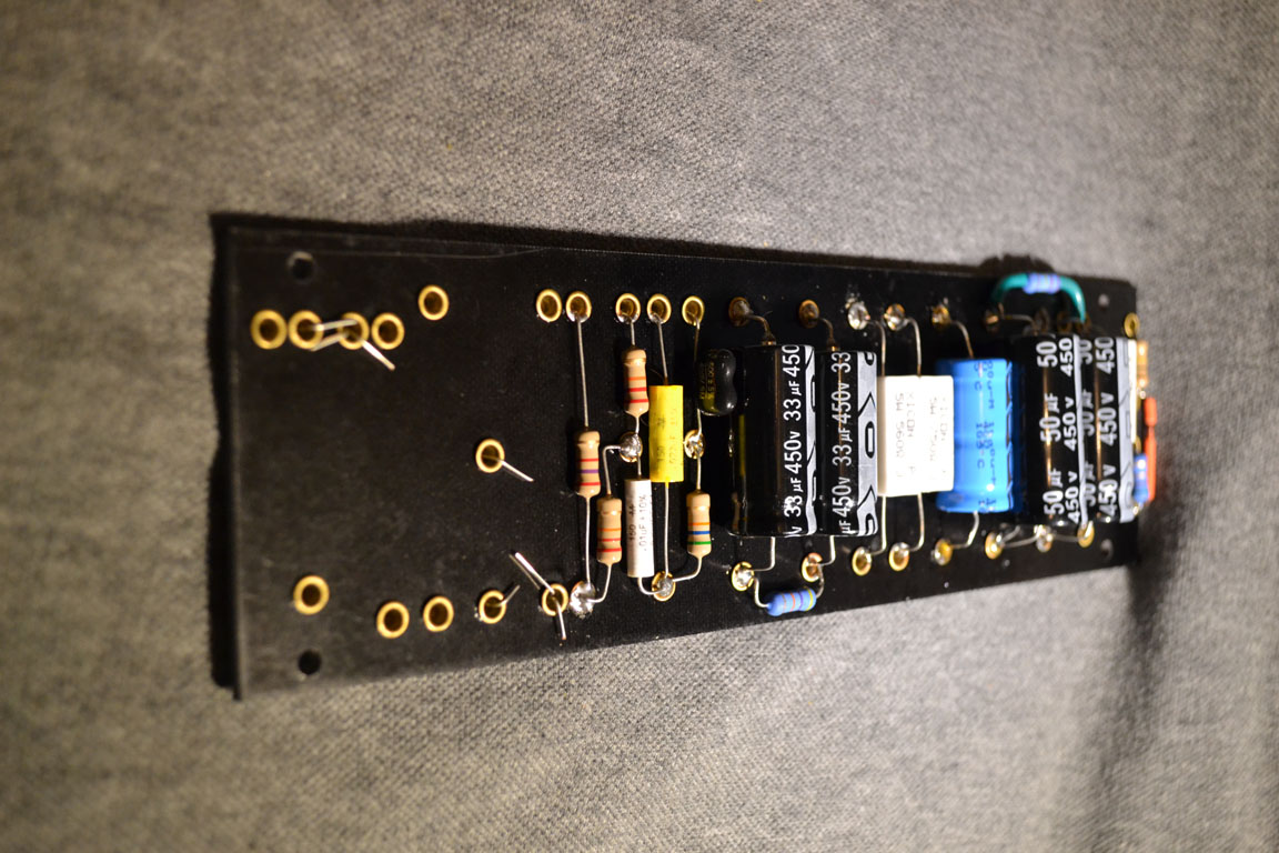

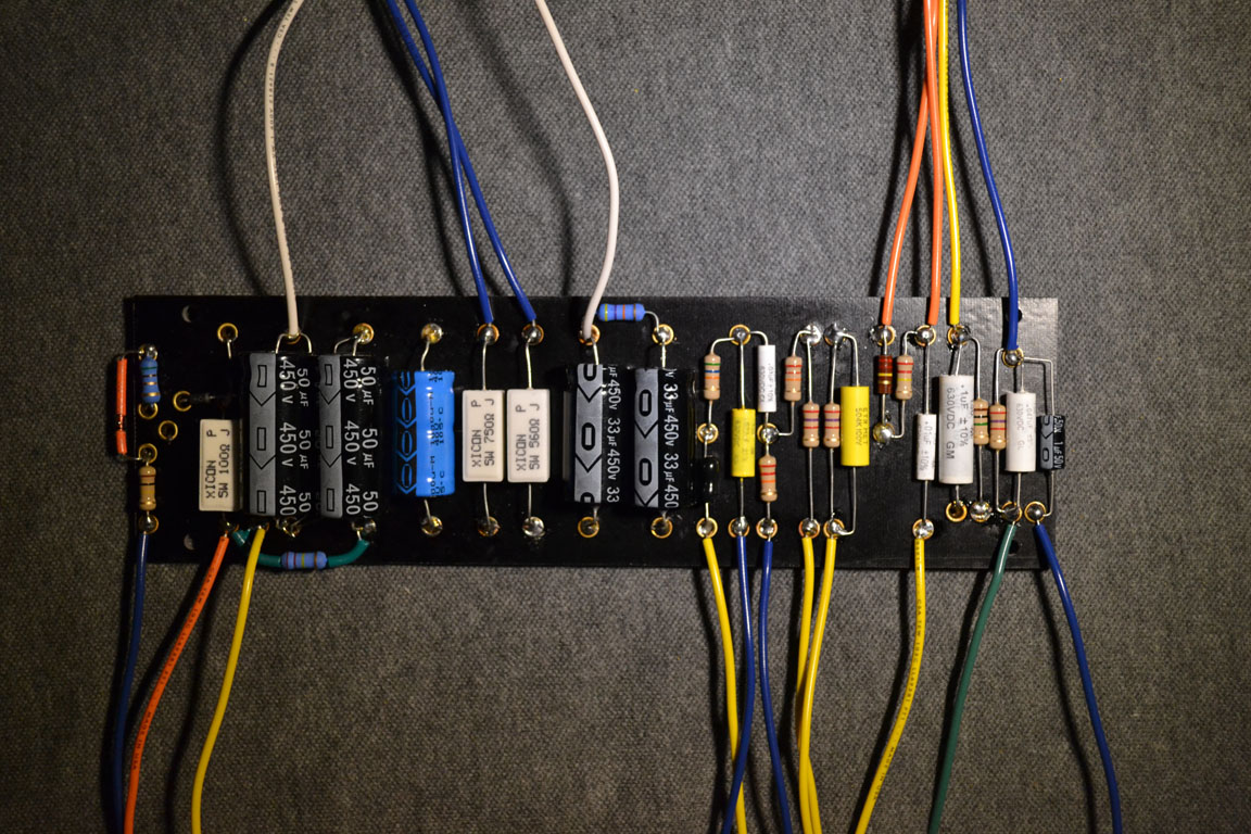

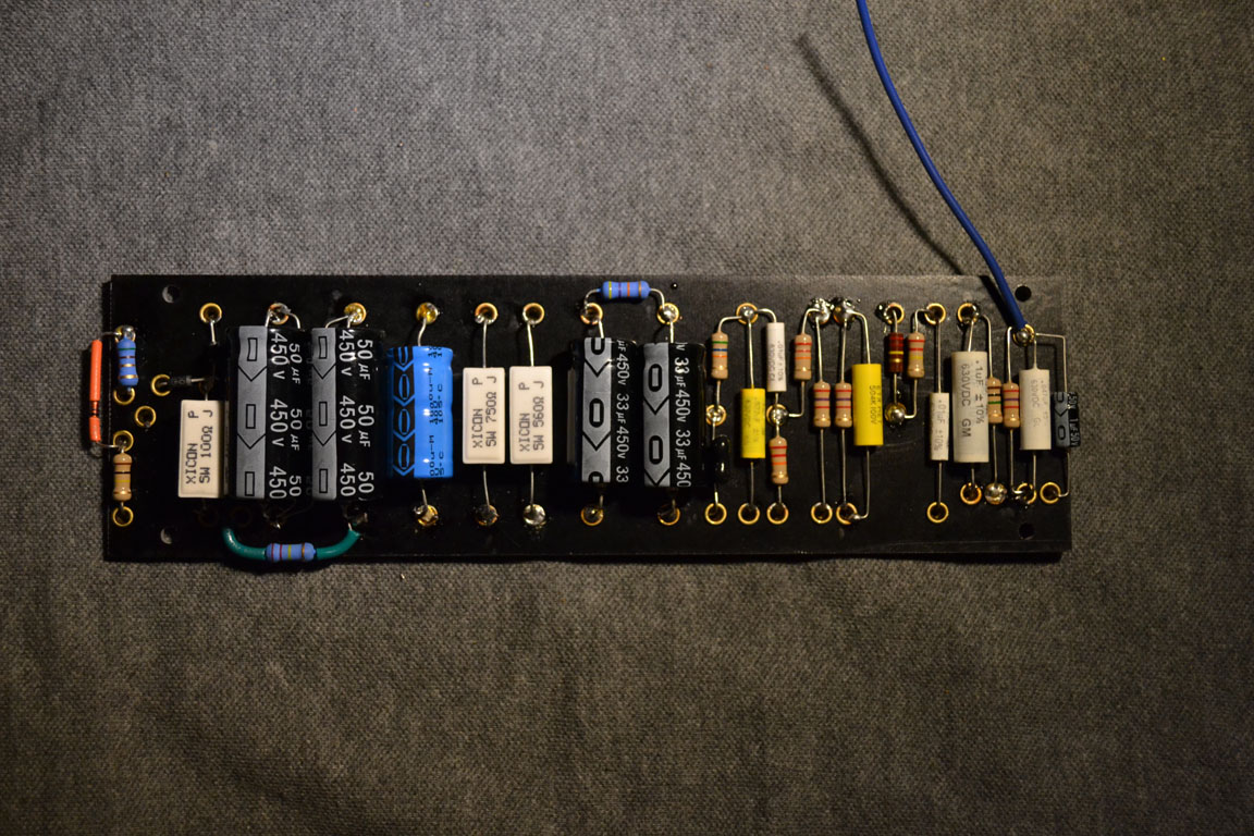

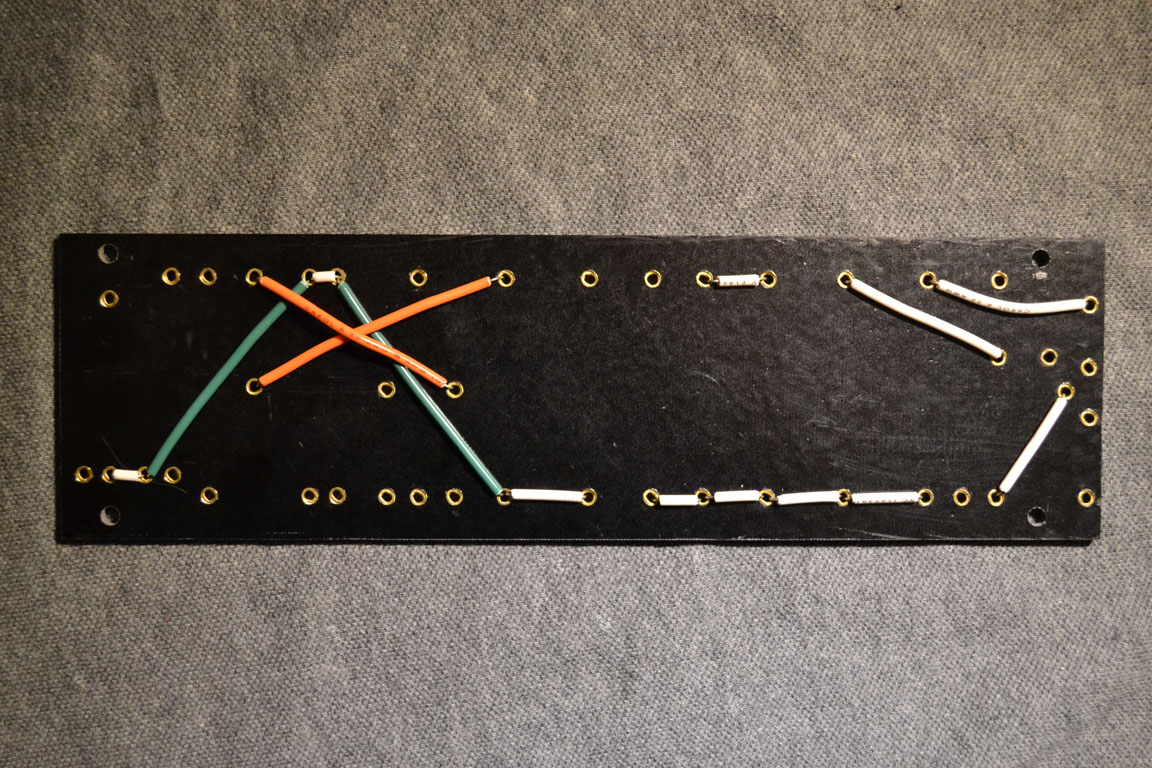

The eyelets board is finally done.
Underside jumpers :
All components added :
And wires :

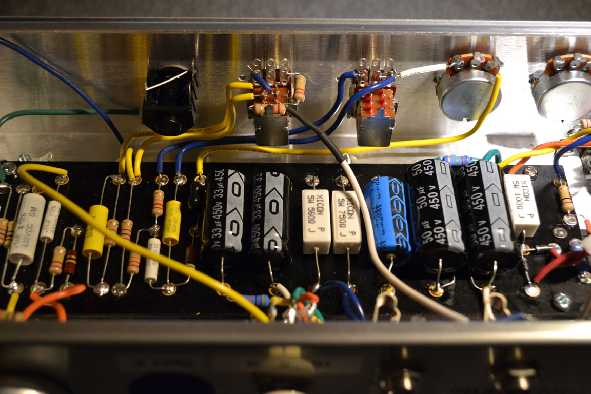

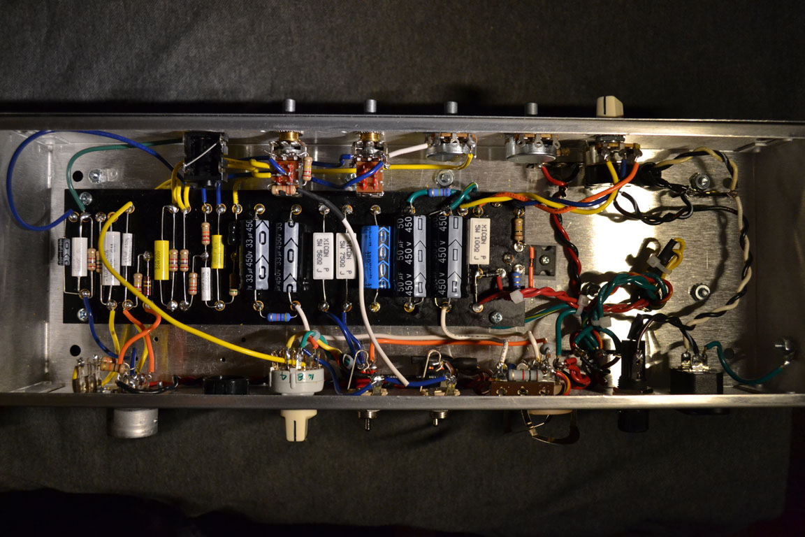

PostPosted: Thu Feb 23, 2017 1:36 pm
Posts: 31

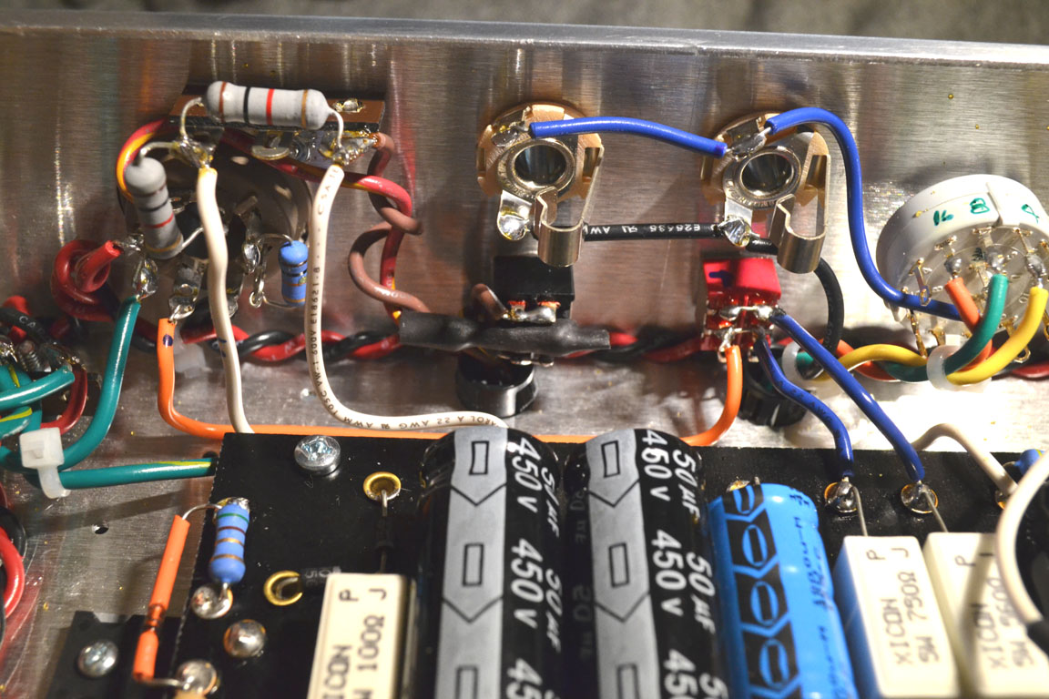

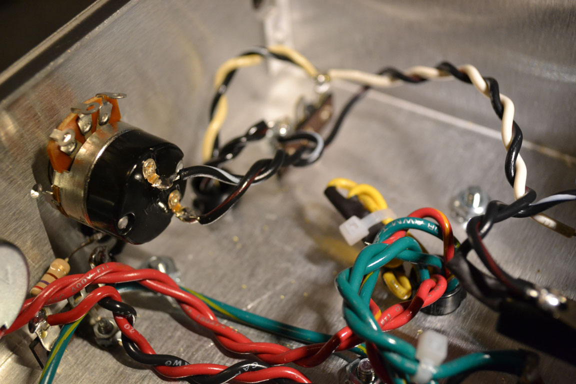

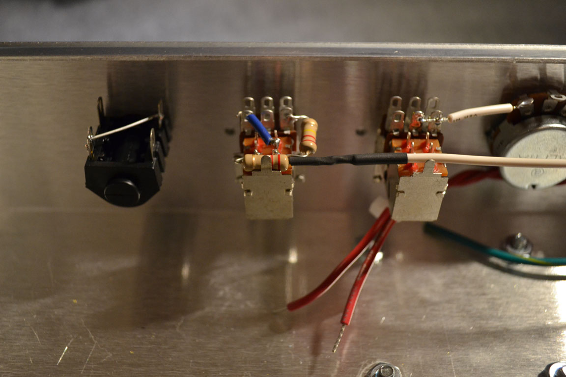

Some wiring and installation of switched pots and input jack :

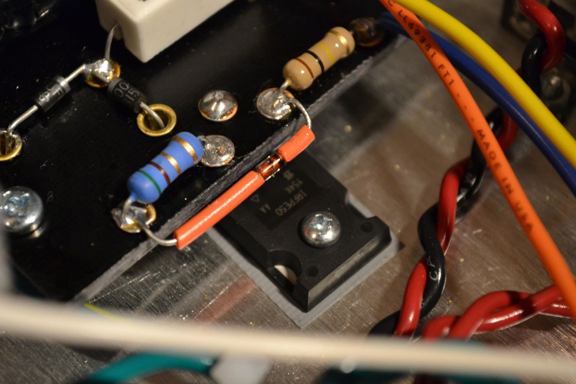

MOSFET and board installation :
PostPosted: Thu Mar 02, 2017 2:23 pm
Posts: 31

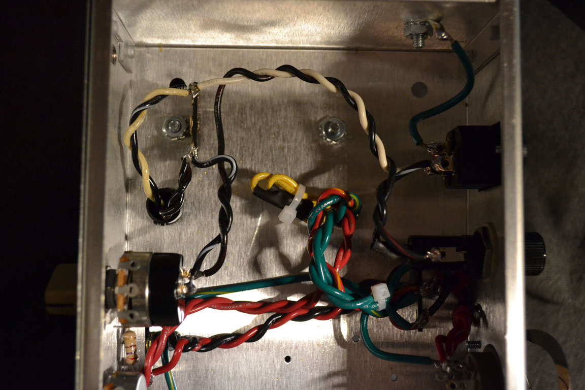

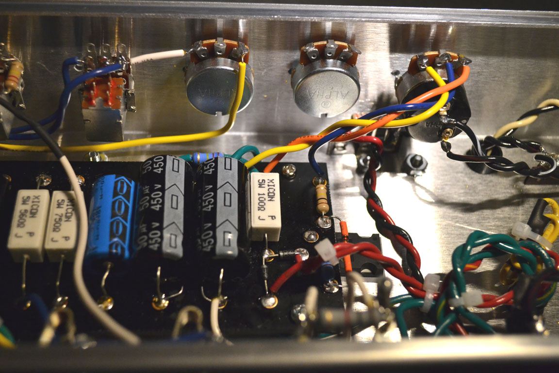

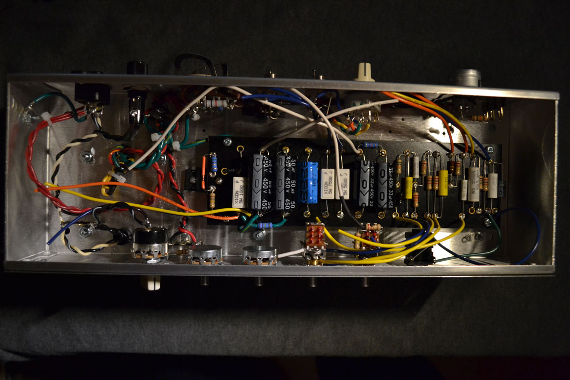

Wiring :
Preamp tube socket :

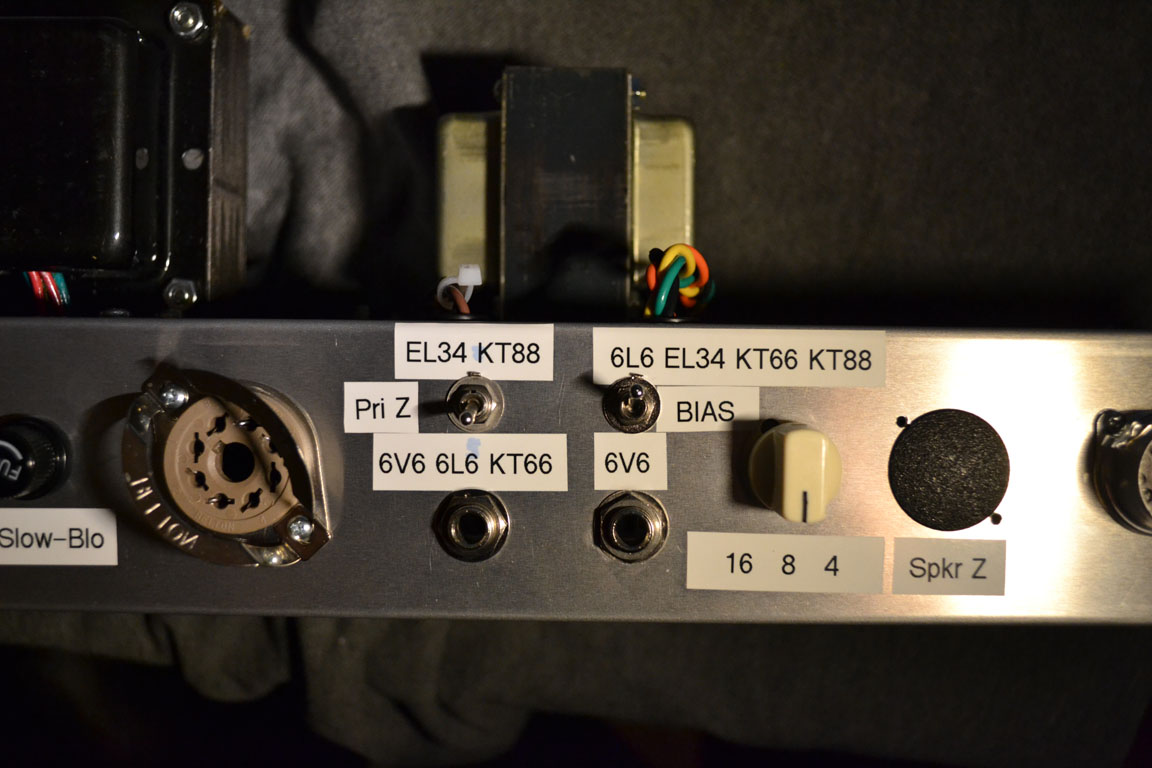

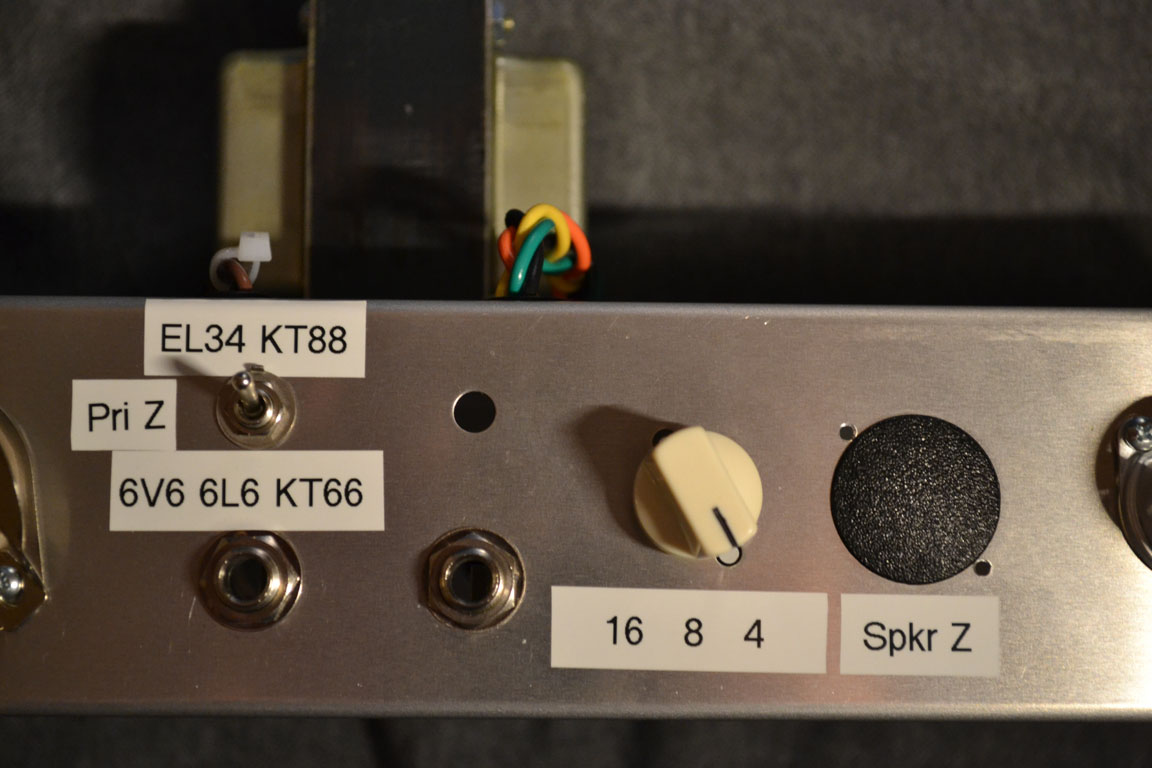

Bias selection switch, and its identification on the rear panel :
VRM :
Starting the controls wiring :

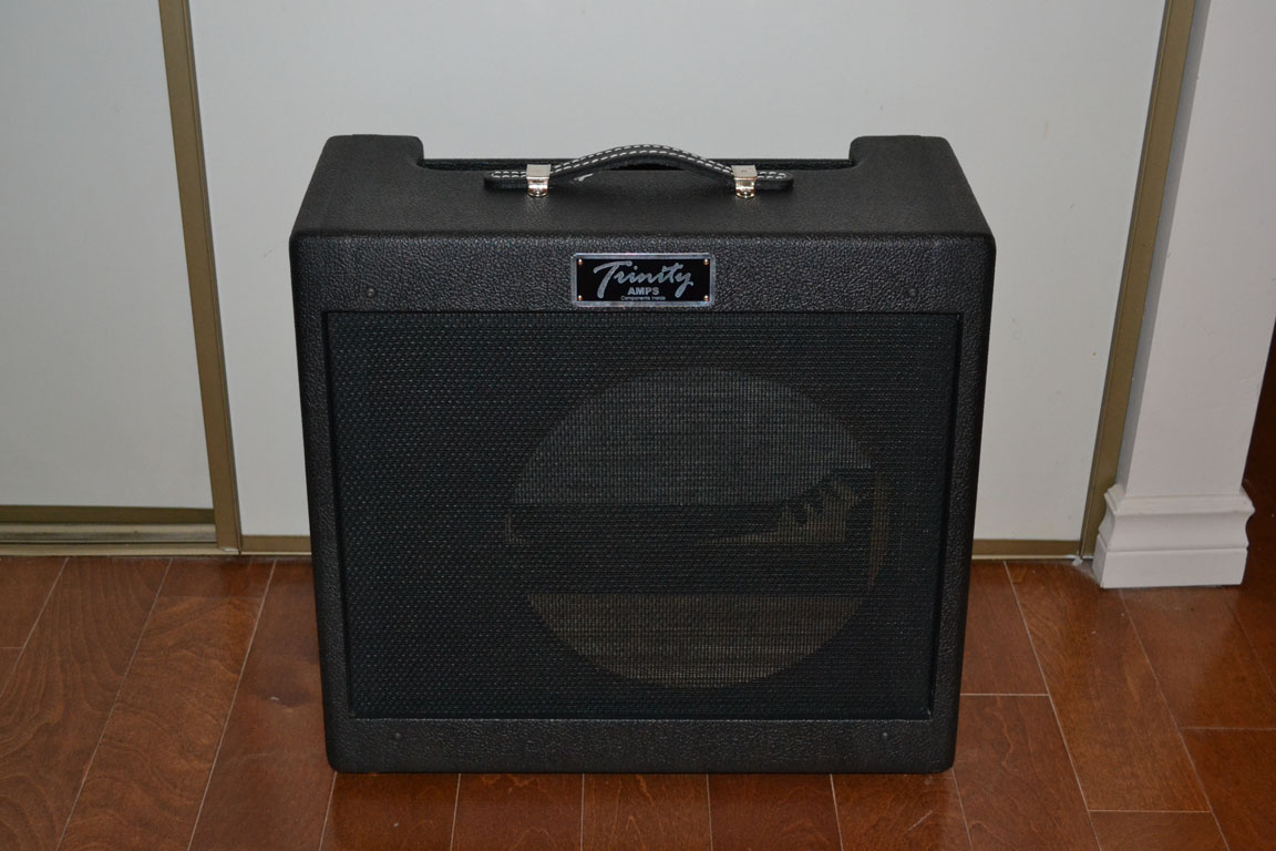

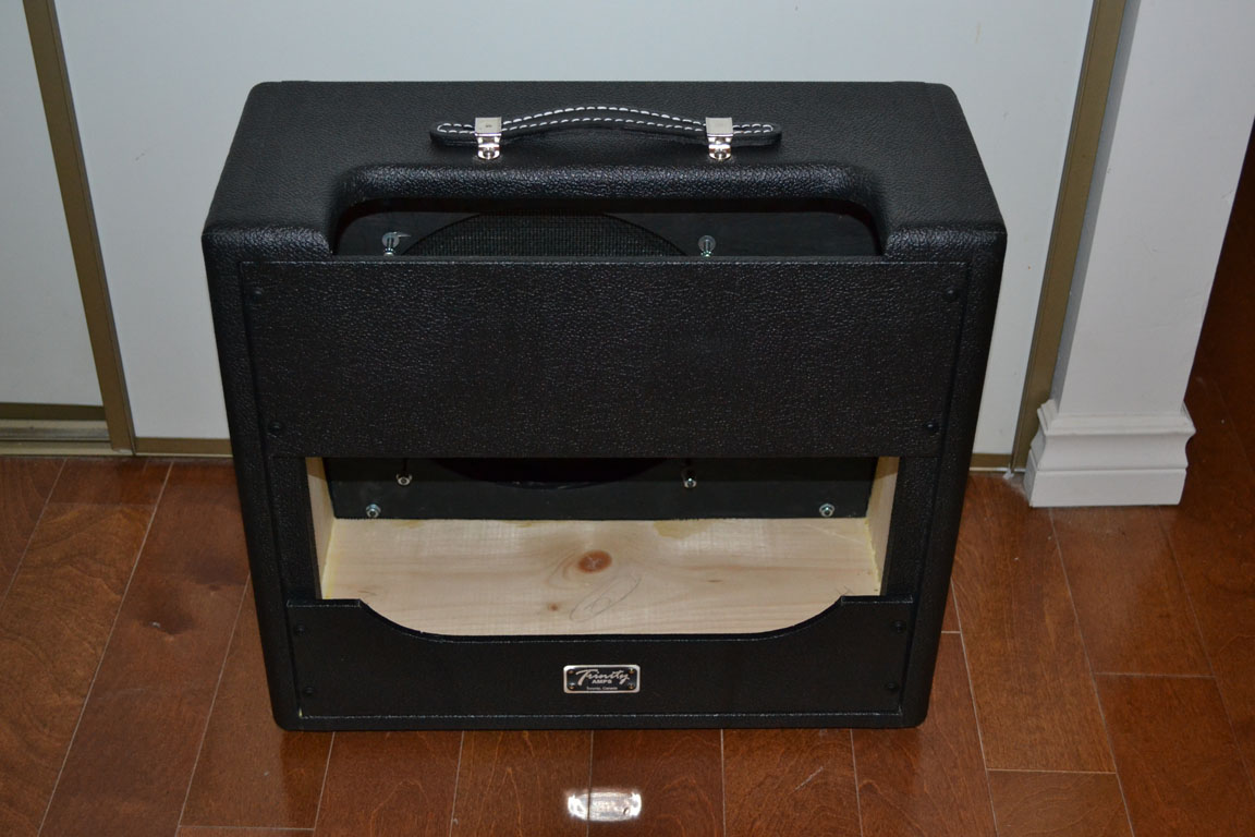

The cab also arrived some days ago. I told Stephen that I'm not in a hurry, so he can take its time; If you order your kit and a cab together like me, yours can be delivered faster, according to the pending orders.
It looks great all black...
