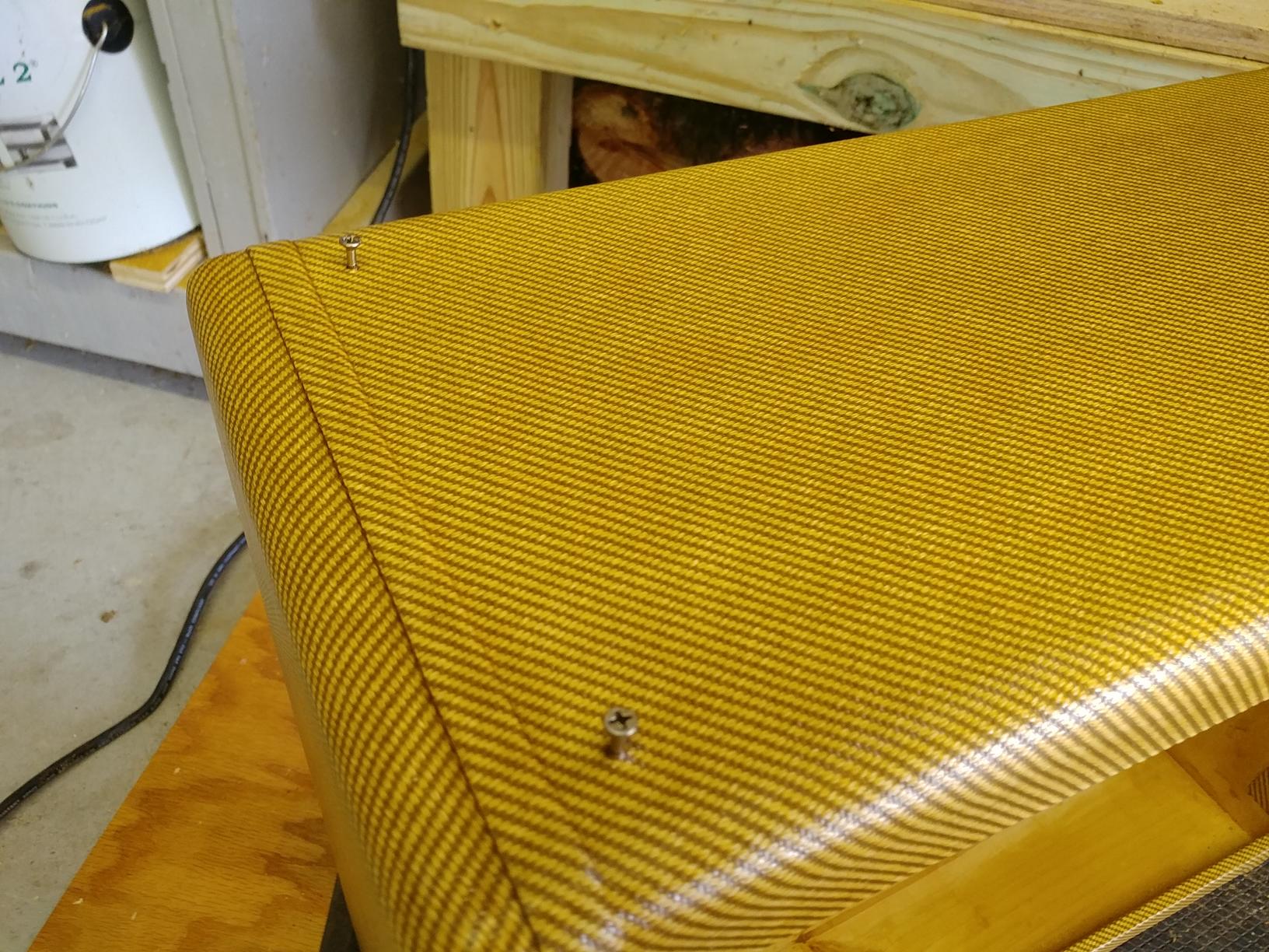

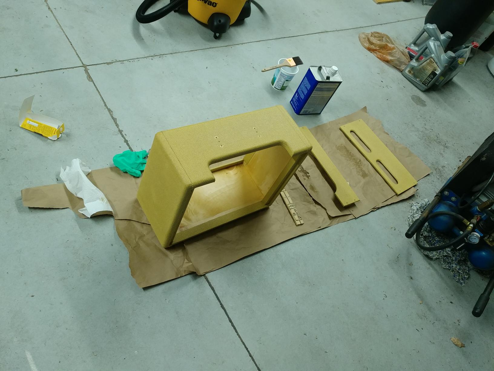

For laquering the cabinet I used Minwax PolyShades Satin polyurethane with "Honey Pine" tint. Buying a quart of the poly, some mineral spirits, a decent paintbrush, and a package of 200 grit sandpaper cost me around $40. So ordering the cabinet already laquered would have cost about the same, and wouldn't have left most of a can of poly going to waste. Live and learn.
If I were doing it again, and if I had some clear polyurethane handy, I would use clear poly for the first coat, then switch to the tinted stuff. Using the tinted poly, it was really hard to keep the first coat even because it wanted to soak into the tweed immediately. This made things a little blotchy. Here's a picture after the first coat. You can see blotches on the side of the cabinet.
File comment: After the first coat, the side of the cabinet was pretty blotchy.
OTOH, it looked better as I added more coats. If I were doing this again and I _didn't_ have clear poly on hand, I'd have to think hard about whether it made sense to buy and open a whole second can of finish just for a single coat and an improvement that nobody else will notice.
Carl's recipe called for 4 coats, but I wound up putting on 5 or 6. I thought it looked better with each coat as the poly filled up the texture of the tweed and leveled out the surface. Overall, I'm really happy with how it came out.
File comment: This picture is after the next-to-last coat. I didn't take a picture after the last coat, but I'll get one later.

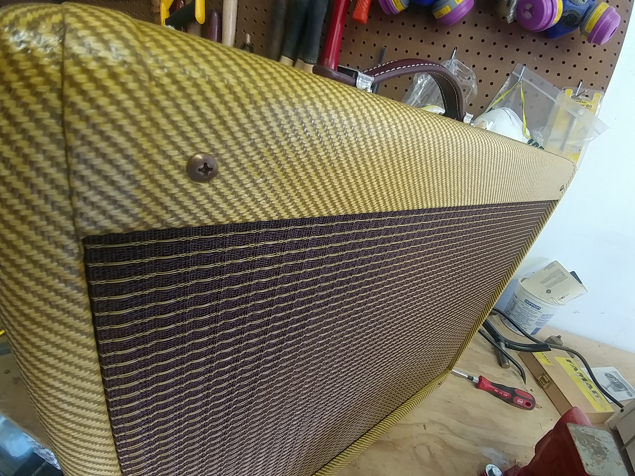

Thanks for the encouragement. I found some more photos of the finished cabinet. Here are some closeups that show how it came out. The picture of the front makes me think I should have done a couple more coats to make it look more like the bottom.
File comment: The bottom of the cabinet with the mounting screws for the chrome glides. I removed the glides for finishing, but put the screws back so I could set the cabinet on the floor when it was wet, instead of hanging it.
File comment: Apparently the white balance on my camera was changing a lot. This really is the same cabinet. In real life it looks closer to this color.

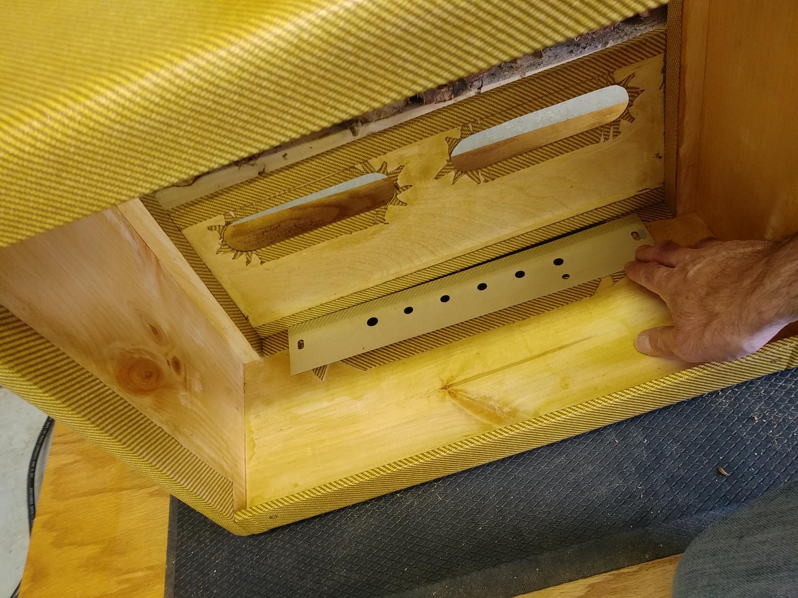

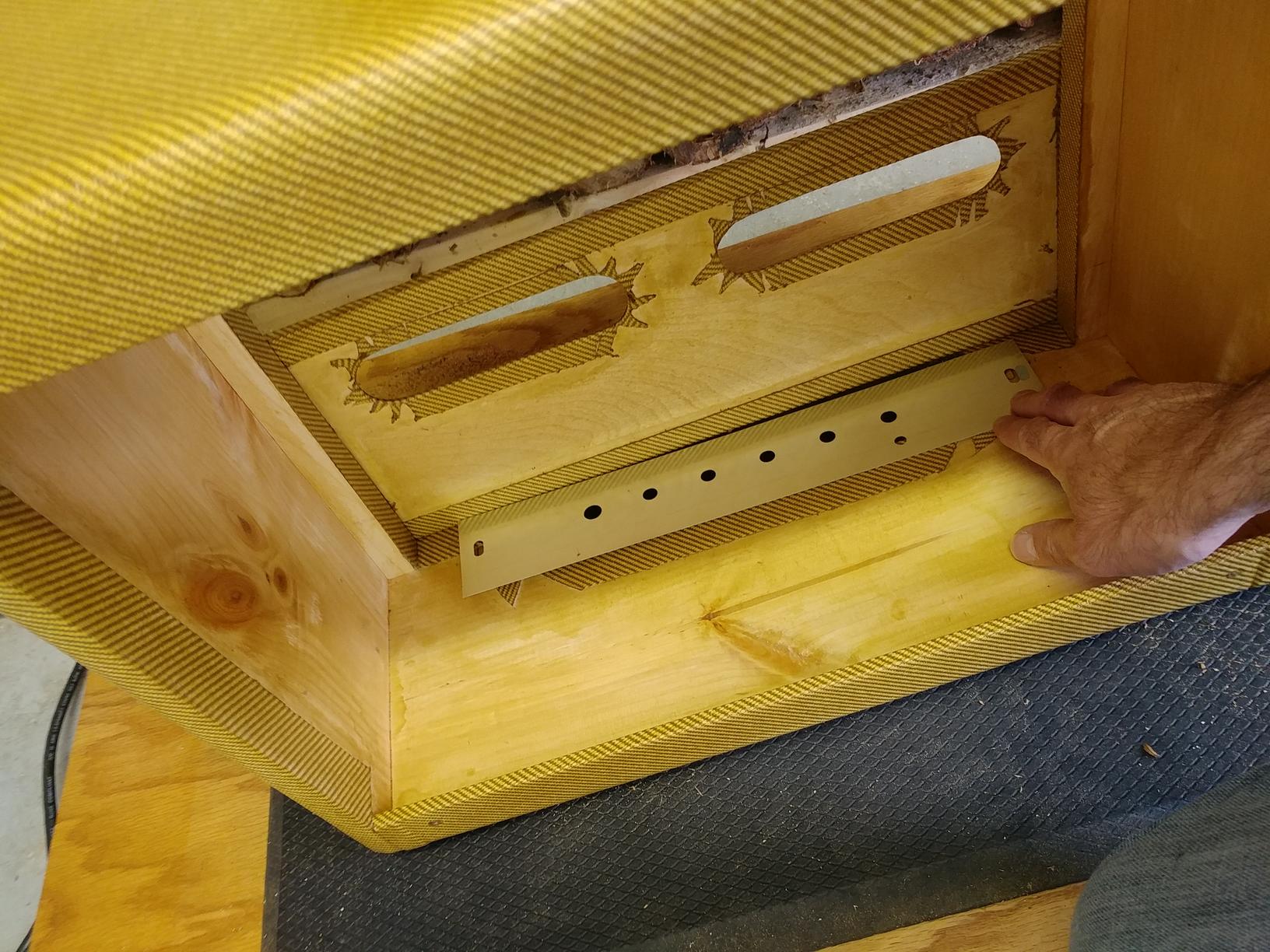

I ordered the cabinet without mounting holes. I measured, marked, and drilled pilot holes from the inside because the sides of the cabinet give a good references to measure against. I drilled to final diameter from the outside to avoid tearout on the visible part of the cabinet -- although the tweed might have protected from that as well.
File comment: Measuring and marking

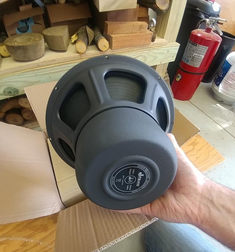

I spoke with Stephan on the phone about what speaker to install, and went with his suggestion of a Jenson Blackbird. This amp project is a splurge anyway, so I held my breath on the price and just ordered it. But wow, that's an expensive speaker. I like to support local business, so went to the Jensen website and found an independent dealer close to me (http://www.huberbreese.com/).
File comment: Jensen
This speaker has a 29oz Alnico magnet, which explains its price. I only have a vague understanding of why Alnico speakers sound good (mostly learned here: https://www.tedweber.com/lets-talk-speakers/), but I wonder if the little Tramp has enough grunt to drive such a big (100W) speaker into compression? I guess I'll find out how it sounds later. :)

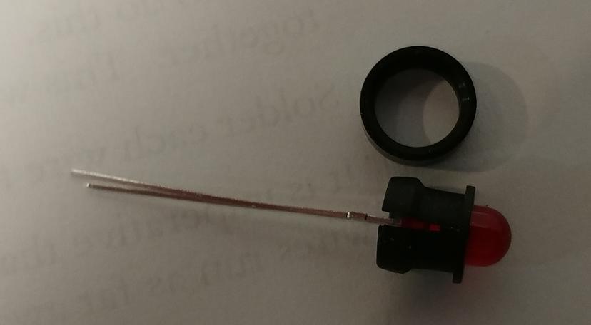

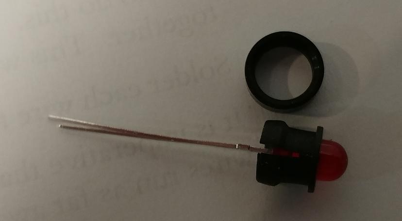

This post is about filing things. I had some trouble with the LED bezel and lock-ring. There's a groove inside the bezel that's supposed to snap around the skirt of the LED. I couldn't get the skirt to fit into the groove; it looked like the skirt was just a bit too thick (or the groove was too narrow). Here's a photo -- with the assembly removed from the chassis -- illustrating the issue. You can see that the "arms" of the bezel are splayed out just a bit to accommodate the LED. This prevented the lock ring from sliding over the splayed arms and securing the LED in the chassis. When the led snaps in properly, the arms close up just enough to let the lock ring slide over them.
File comment: The LED wouldn't snap into the bezel fully.
I solved this by lightly filing the bottom face of the LED (the one that the leads come out of) with a small flat file until the skirt on the LED fit the groove.

The LED rings are really tough. I have simply cut them so they spread open to fit the LED but they should slide on.

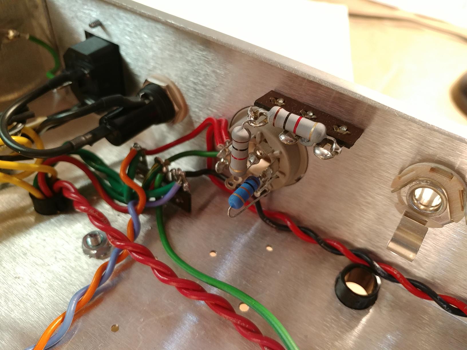

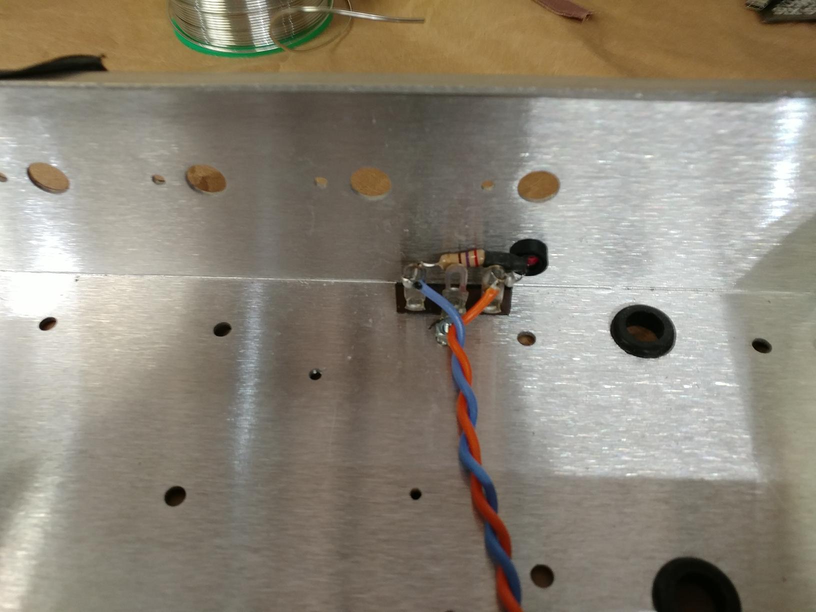

Moving along with the wiring, here's heater wiring and mains connections all completed. I felt a little silly heat-shrinking the mains connections, when right next door there are going to be uninsulated components over 300V. OTOH, the hot leg of the mains connection is the only thing in the chassis that isn't fused, so maybe it's justifiable.
File comment: Heaters and mains.

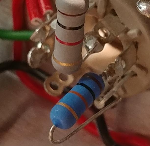

I installed the green neutral wire from the power tag strip, and just left the other end flying. I'll solder it to the board once the board is available. I did it in this order (rather than installing it on the board, then soldering to the tag strip), so I could solder the tag strip once and be done with it. This also let me route the wire cleanly underneath the green and blue wires going to the neighboring lug on the tag strip, which took a little effort. I'm not proud of my soldering job on the tag strips in general. Even with the change in solder/flux, I was struggling to get the solder to flow without cooking the attached wires and melting insulation.
As you can tell, I didn't get the memo on twisting the transformer primary wiring and routing around corners of the chassis. I straight up forgot those instructions while I was wiring the mains. I'm optimistic that this won't have a negative impact, but if I get hum, I'll know where to look.
File comment: Grid and screen resistors
Here are the grid and screen resistors soldered to the octal tube socket. I copied the picture in the builder's manual when I mounted the 10k grid resistor, but left pin 6 of the socket unsoldered until the wire from the master volume is available. I kept the lead length between the resistor and pin 5 as short as possible. In retrospect, I like the way @Moodivarius wired his grid resistor better (viewtopic.php?f=16&t=6267). I'd probably copy that if I were doing it again. Note that I resoldered the tag strip later to make those joints a little better.

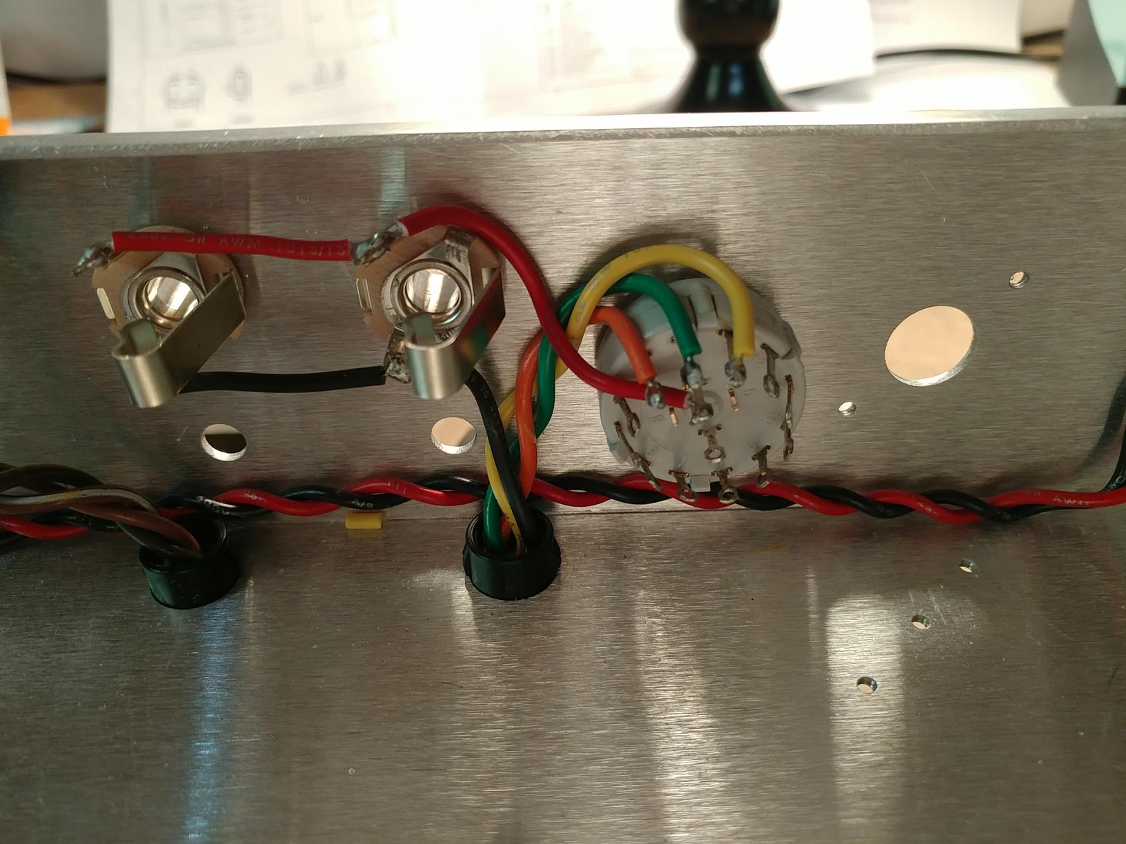

LH, I'm not saying to rewire the the heater wiring, but if you build another amp, try wiring the heaters from the endpoint socket back to the next. It took two AX84 and two Trinity builds for me to figure this out. Once I did I noticed Stephen recommends doing it his way in the Build Guide. It lets you keep the heater wires twisted tighter around the socket area. Your amp build still is looking great regardless. :thumbsup: :thumbsup:

Hi Hank. Thanks for pointing this out. I went back and took a look at the photo on page 32 of the Builder's Guide. I think I understand what you're saying.
Just to confirm: the difference is that I didn't keep the heater wires twisted between the tag strip and the octal tube... I have that big loop of red wire running from the power tag strip to the octal socket. If I had wired it as you suggest, the heater wires would have been twisted tightly the whole way.
Did I understand correctly?

LH, what I used to do was wire from the transformer heater wires>tag board>octal socket>noval socket on the Tramp (and others). Figured out it was better to wire back from the last socket; noval>octal> tag board. That way you can trim, adjust and twist your red and black wire lengths. As I said, not suggesting you go back and redo what you've already done, but give it a try if you ever build another amp. Will post and attachment of second Tramp. You can enlarge the pic and see that I should have left a little more length on the black heater heater where it goes around the noval socket (a little close to some of the other pins). Anyway, it looks better and tighter than some of my previous heater wiring :!:

That makes good sense. Thanks for the clarification. I will do that on my next (?) build. :thumbsup:

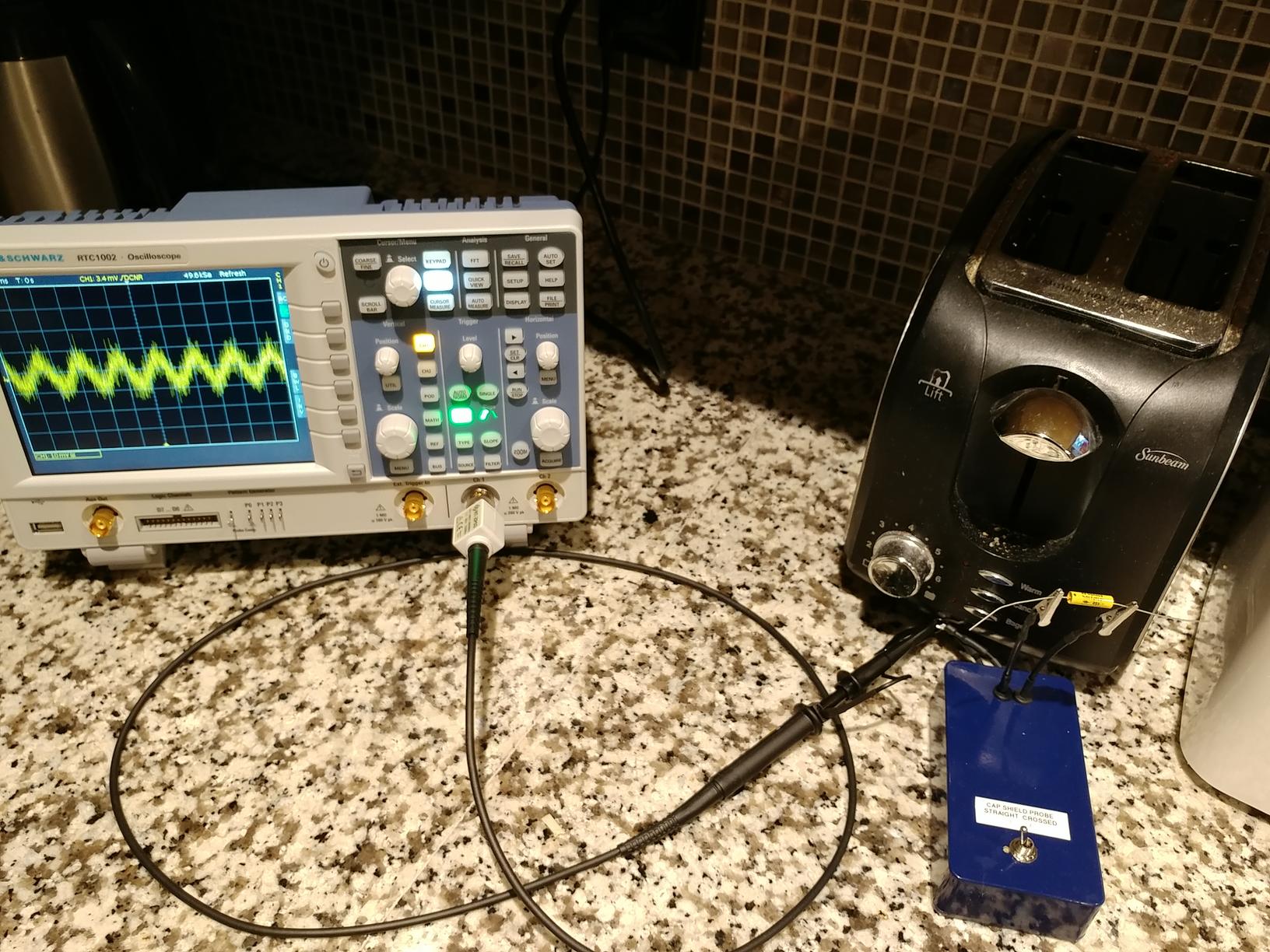

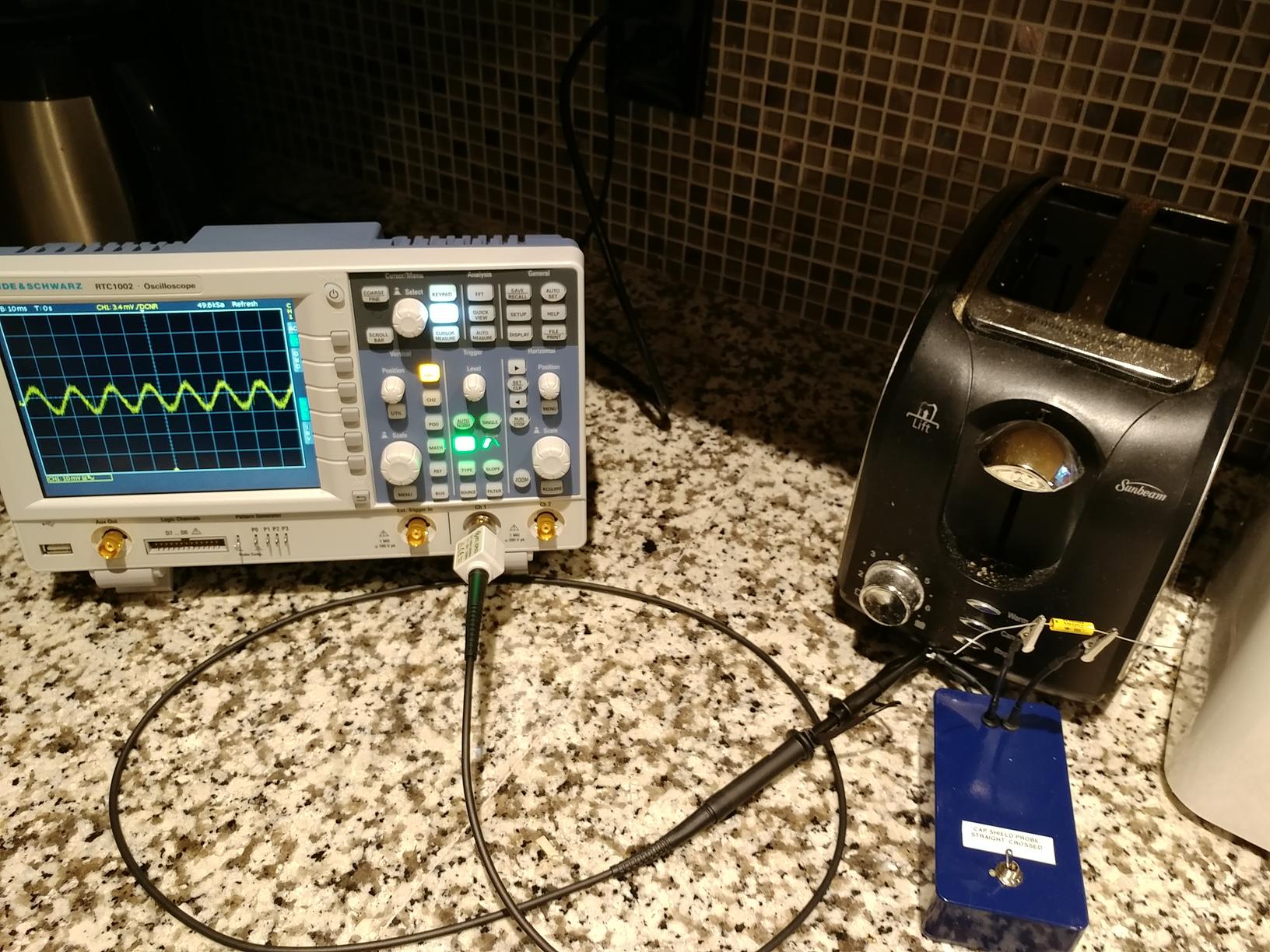

While I was getting ready to build the board, I stumbled on this video (https://hackaday.com/2015/05/20/how-to- ... backwards/). It's long, but you can watch it in fast-forward and skip the repetitive parts. It suggests that you can reduce noise and hum in your amp by figuring out which leg of each tubular cap is connected to the outermost layer of foil, and connecting that leg to the lower impedance part of the circuit so it acts like a shield around the capacitor. It seemed worth a shot!
In the end (see below) I decided the impact on this build will be minimal. It was still a fun exercise, though, so I'll write it up here.
The first thing I did was simply connect each capacitor directly to an oscilloscope probe & ground, then reverse the leads. I didn't take a photo, but I was trying to duplicate what's shown in post #19 of this TDPRI thread (https://www.tdpri.com/threads/lunchbox- ... ed.992175/). It didn't work well. The variation in signal strength just from moving things around was bigger than the effect of swapping the leads. I wasn't able to figure out which lead was connected to the outer foil.
So I decided to build a testing box like the one in the video, but with a mechanical switch instead of a PCB and solid state relays.
File comment: Here's what I was shooting for
where all of the shields and the scope ground are tied to an aluminum case. I had this project box on hand. It's aluminum, and about the right size, so I used it.

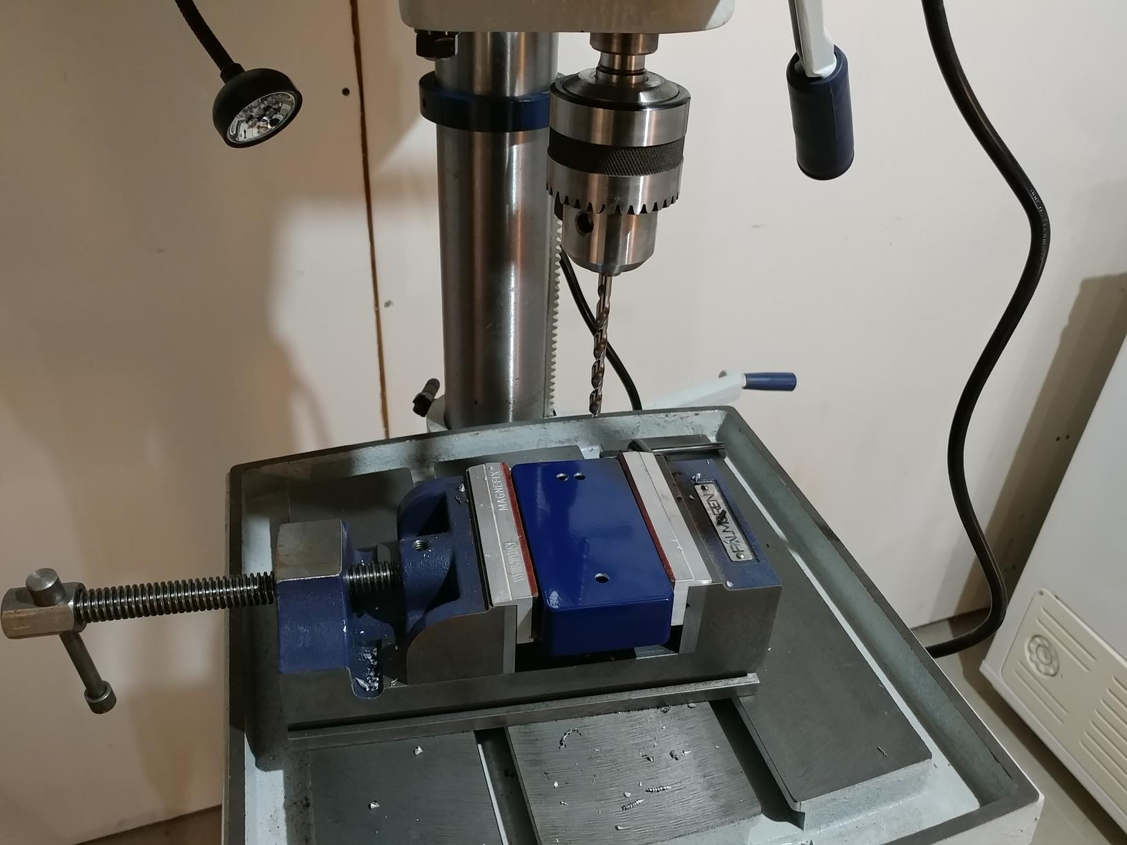

I put the hole for the switch and the holes for wires on opposite ends of the box, so I can work the switch without getting too close to the capacitor and oscilloscope probes.
File comment: A hand drill would have worked fine, too.

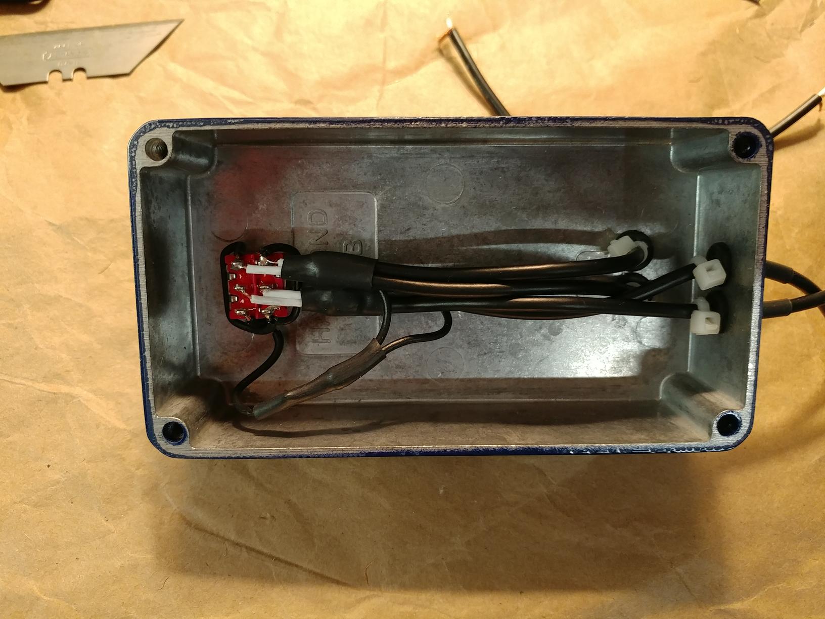

I didn't have any spare shielded cable to use. I thought about cutting up a guitar patch cord, but I didn't want to use cable that thick. In the end I found an old RCA-to-RCA video patch cord and used that. Here's the whole thing wired up.
File comment: Internal wiring
The copper braid on each pair of shielded wires is twisted together and soldered to a piece of single-conductor stranded wire. Those two single conductor wires "Y" together into a single wire that runs to the project box. I connected it to the project box by soldering it to the locating tab on the switch mounting washer.
Here's what it looks like on the outside. To keep the wires from sliding in and out of the grommets I used zip-ties on the inside of the box and heat shrink on the outside.
File comment: Nearly done...
Finally, I put ring lugs and alligator clips on the wire ends. I forgot to tie the scope ground line to the case when I was wiring up the inside, so I simply connected the shield and inner conductor at the ring lug.
If your scope has a low-pass filter or bandwidth limit, it helps a lot to turn that on. Here are pictures at full bandwidth (50MHz on this scope) and with a 20MHz bandwith limit turned on. You can see that the signal with the limit engaged is much cleaner. The toaster is there just as a good source of 60Hz interference.
File comment: Without the bandwidth limit
File comment: With the bandwidth limit
Finally, here's the switch in the other position. With this cap (0.01uF), there's a noticeable difference. With larger caps the difference gets much smaller. I think this is because the larger caps have lower impedance at 60Hz, so the hum simply couples through to the grounded leg regardless of switch postion.
File comment: Less hum in this position
This was a lot of fun, but in the end I don't think it will have much impact on the tramp build. After doing this, I went back and had a good look at the schematic. Only one of the tubular capacitors (C3) is connected to a truly low-impedance part of the circuit, so this is the only tubular cap where I imagine getting the orientation "right" might make a real difference.
Wow, this post got long!
