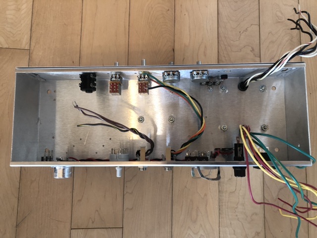

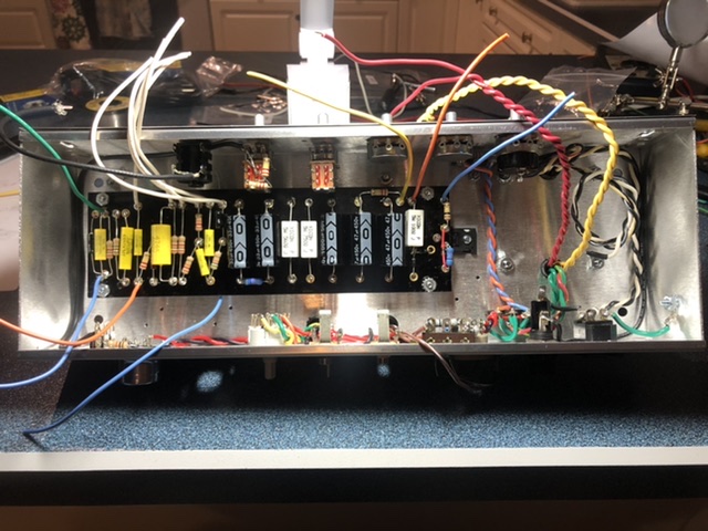

Coming along. Worked on it this weekend.
Wiring this evening.

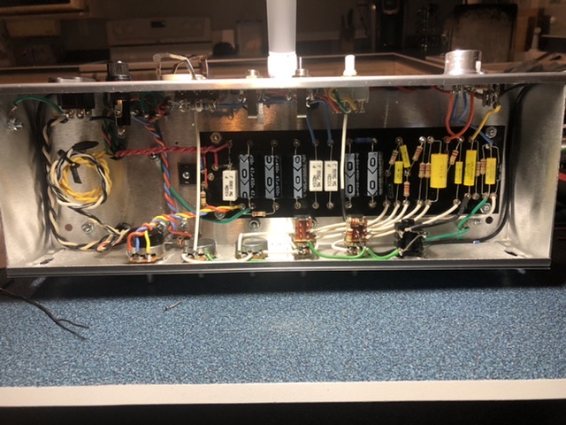

All wired. Now double check everything.
PostPosted: Tue Dec 03, 2019 1:16 pm
Looks good, I can't see it in your final photo, is the blue jumper there between eyelets 3 and 2 on the Bass control? and thanks for the gut shot , always good to see other people's wiring style. Always looking to improve mine :!:

Good eyes.
I just took the pliers & bent pin2 over to touch pin3, so when I soldered the wire on, all in joined together.

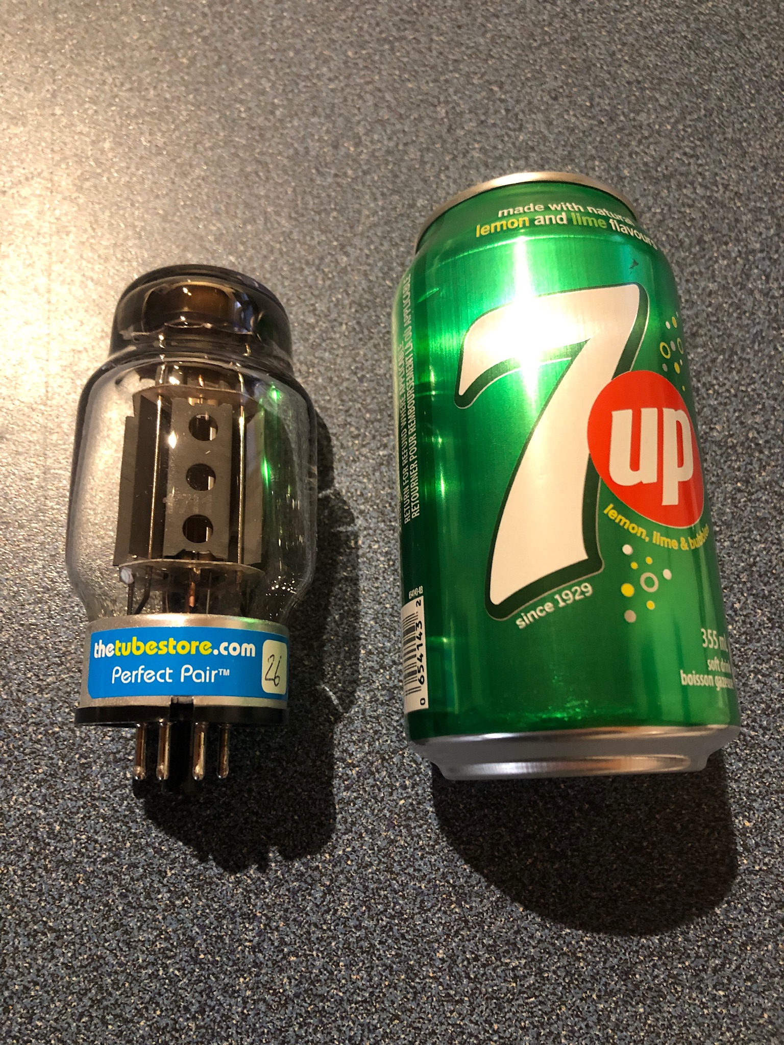

Got some new tubes to play with.
KT88

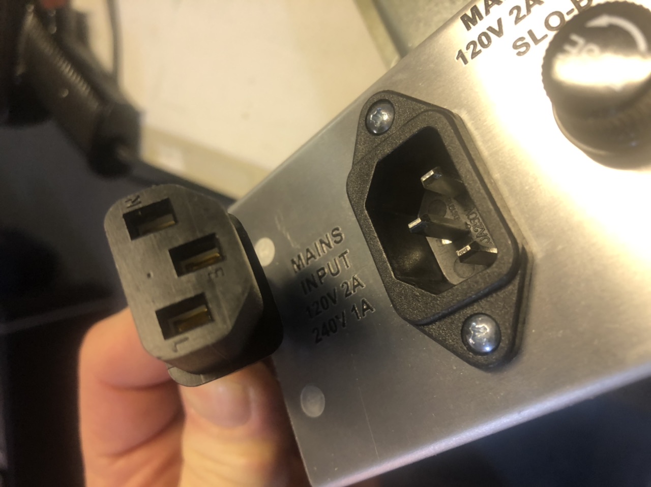

I really like the neat way you laid out your wiring! I'm taking notes...
From the pictures, it looks like you've put the fuse on the neutral side of your mains connection, rather than the hot side. If I'm seeing that right, the fuse won't protect you from hot-side shorts upstream of the power transformer.
Does this match what you see in person?
PostPosted: Mon Dec 16, 2019 2:21 am
Posts: 38
You made me double check things, but it was correct.
The lettering is on the end of the input cable.
Scott

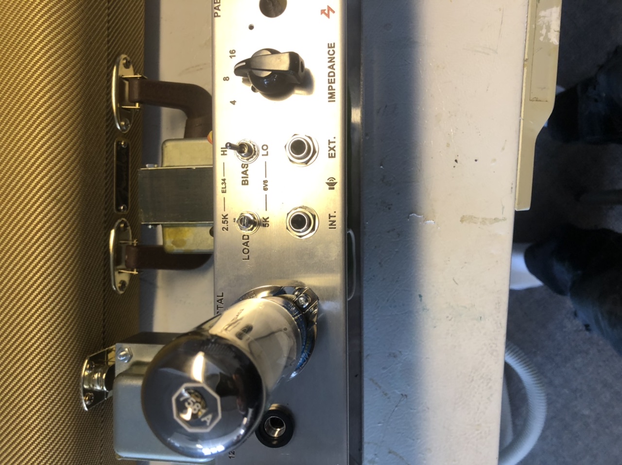

KT 88 works well in the Tramp, but you'll have to remove the supplied tube retainer clip (tube base too large), if you haven't already discovered that :(

Put the 7581 in this evening. Changed the bias switches to 5k & Hi. Sounded great.
Cranked it to the max, it was screaming real nice, then started cutting out, saw a slight bit of the dreaded smoke from the Power tube area, then dead.
Checked the fuse, blown. Replaced & put the tube back in. Glows with a little bit of lightning inside.
No sound.
Bad tube?
Scott
