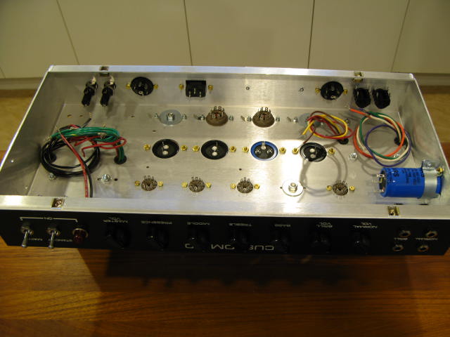

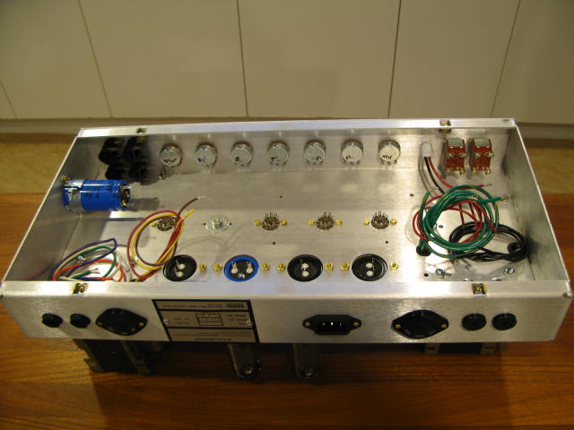

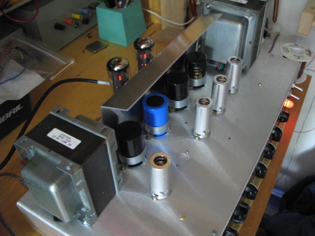

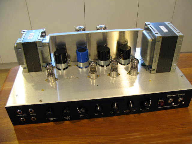

I started the project by assembling the chassis. I installed the tube sockets, transformers, capacitors, the front panel, the pots, and the switches. The chassis is made from 11-gauge aluminum and I also got it from VHR. It included the heat shield that goes between the output tubes and the filter capacitors to help keep the capacitors from getting too warm.

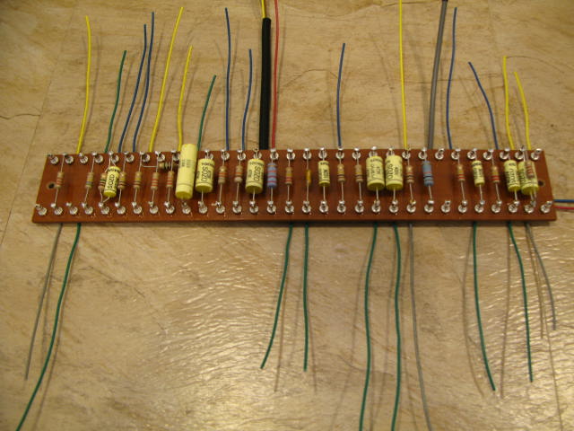

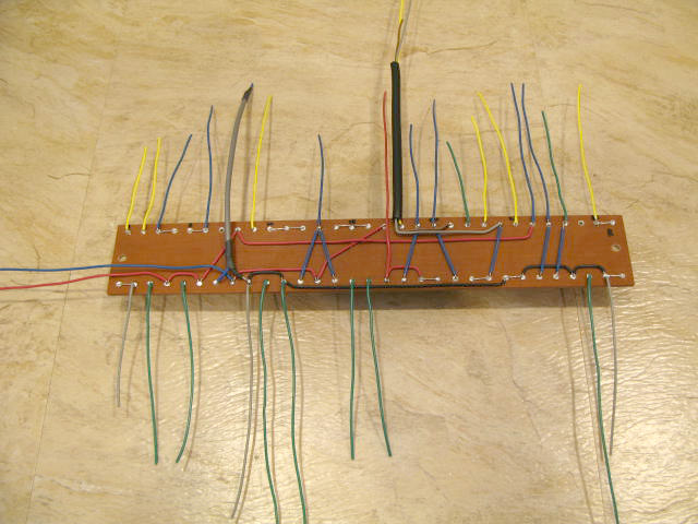

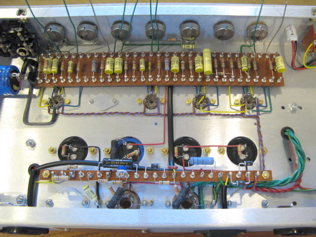

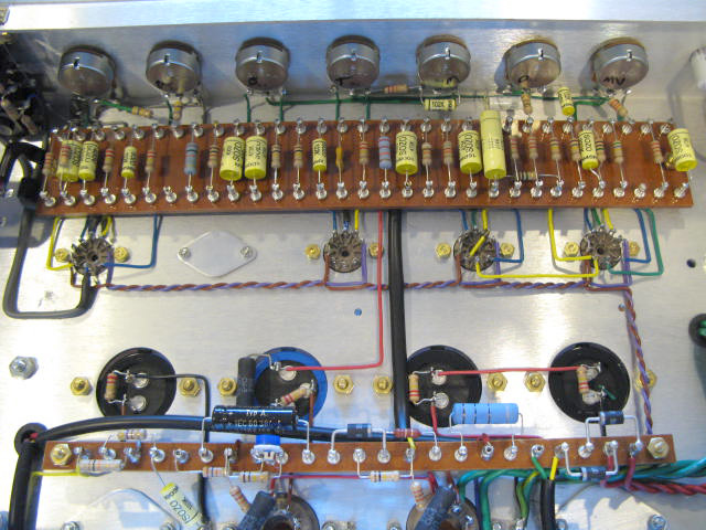

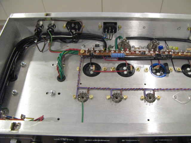

I built the preamp turret board next. The power amp and power supply use another smaller turret board. Some of the wiring in the original Hiwatts runs through plastic tubing to keep it together. You can see tubing on the wires that run from the preamp board to the power amp.
I went with the method Harry Joyce used for attaching the fly off wires to the board. This put them on the bottom instead of the top. It looks neater, but the danger with this method is the wires can end up being too short if you aren't careful with your measuring.

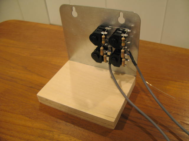

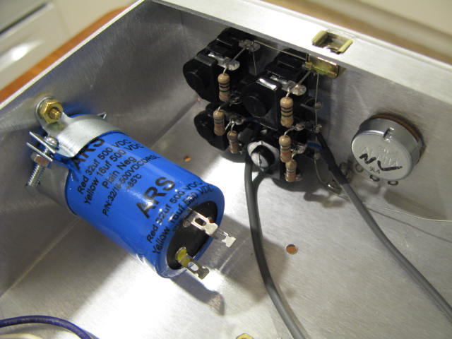

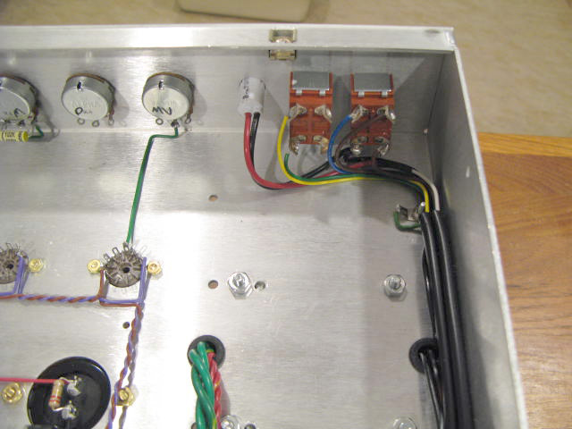

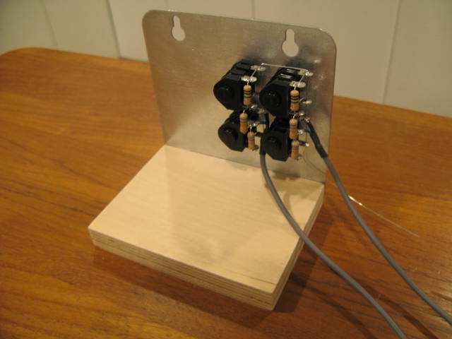

Wiring the input jacks was next. If space inside the chassis is cramped, a good tip is to temporarily install the jacks on the outside of the chassis while you do the wiring. But I went a bit further and made a little jig to hold them in the proper position instead. This let me rotate the jacks into whatever position I needed to install the resistors and wires and it was easier than moving around a heavy chassis.

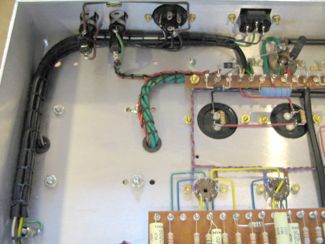

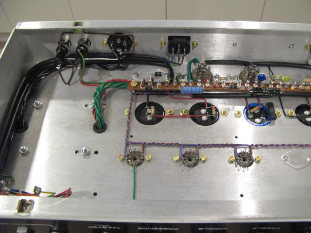

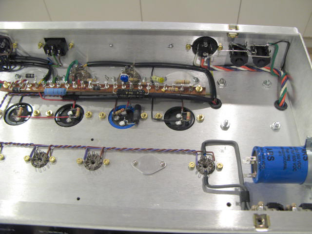

The next step was wiring up the heaters. I did it Hiwatt style where the wires run straight as they pass the tube sockets and are only twisted on runs between the tubes. These twisted runs are short so I just twisted them by hand instead of using a power drill.

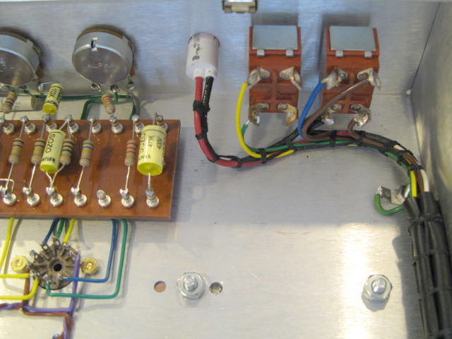

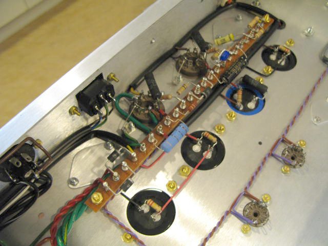

I also assembled the power board, did the AC wiring, and connected the power transformer and the output transformer. More plastic tubing was used to bundle the AC wiring and the primary wires on the output transformer.

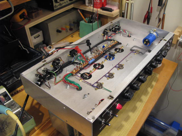

Once I had the power supply wired I was able to test the amp for the first time. I checked all my wiring several times and made sure that the polarity of all the diodes and capacitors was right, then I applied power. The pilot light came on and I watched for smoke. I wasn't expecting smoke and there wasn't any. I measured the voltages and my meter showed the B+ was a healthy 481 volts. I also checked the bias supply and the heaters and found them to be OK, too.

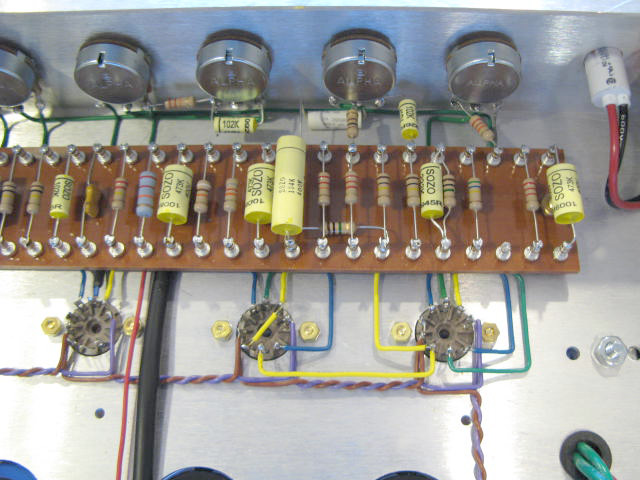

I installed the preamp board next and wired it to its tubes and the power board.
Then I wired the preamp board to the pots and put in the last of the resistors and capacitors.

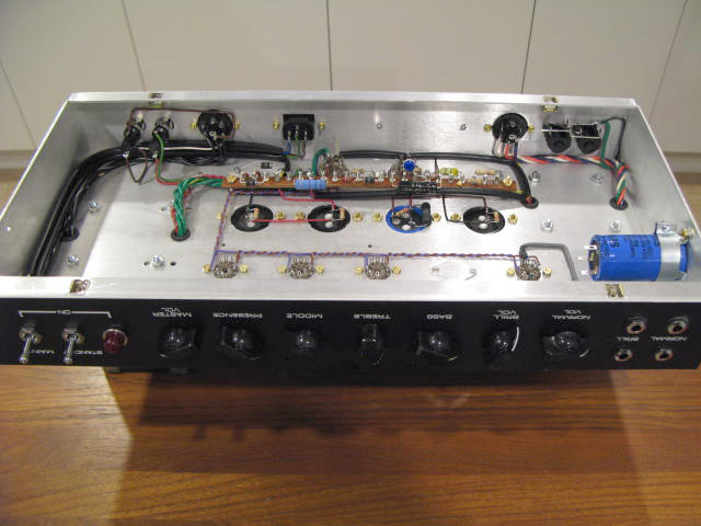

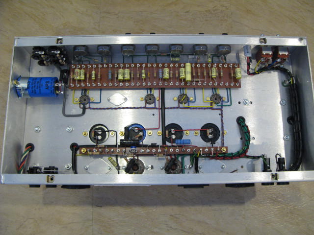

The wiring was now finished and it looks very much like a Hiwatt!

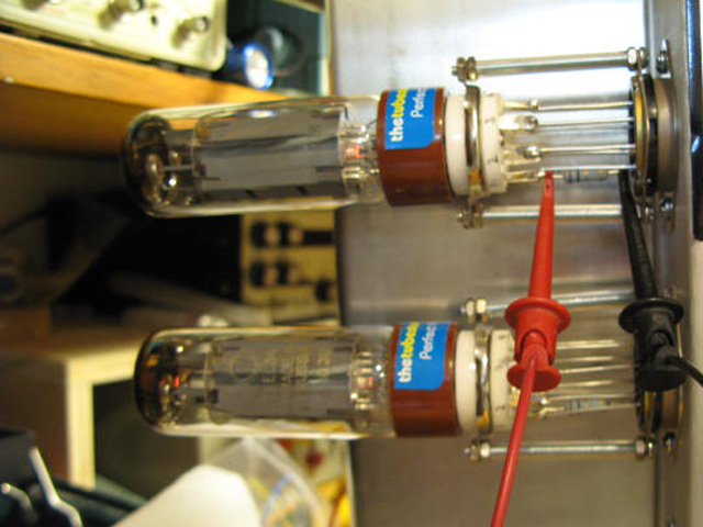

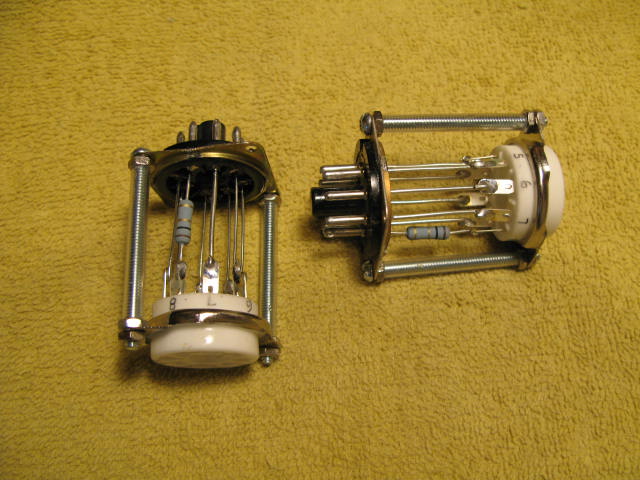

The bias for the output tubes had to be adjusted next. The original Hiwatts don't have built-in bias test points and neither does mine. So I rigged up a couple of "bias probes" using the 8-pin plugs from a couple of old relays, a couple of 8-pin tube sockets and a couple of 1-ohm resistors. These aren't as fancy as the commercially available probes, but they let me measure the cathode current and the anode voltage easily from outside the chassis.
The bias trimmer was set to minimum resistance and I found that the cathode current was 72mA. There was no red plating, but this was way too high. It's typically around 36mA for EL34s in circuits like this. A detailed description of setting bias is beyond the scope of this post and there are several methods that can be used. So to make a long story short, for each tube I measured the voltage at the anode and the voltage across a 1-ohm resistor in series with the cathode and applied Ohm's law to calculate the cathode current and how much power the tube was using idling. Using a 1-ohm resistor makes the math easier. I ended up setting the bias so the cathode current was 39mA.

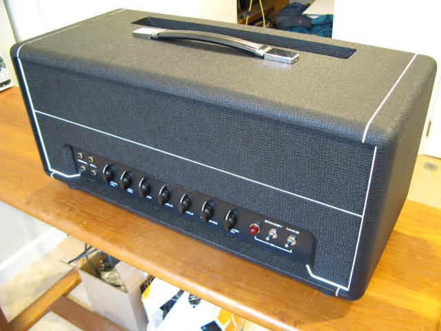

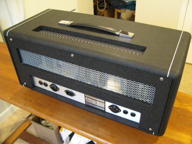

The last thing was to put the amp in its cabinet. I almost hated to do that, though, because it hides the beauty of the chassis and its wiring!
I wish I could take credit for making that beautiful cabinet, but at the time it was just easier for me to order it from VHR. Since then I have made cabinets like that with Tolex and piping. And no corner brackets needed to hide bad Tolex joins on the compound curves! I have also made several cabinets using hardwood, including the one I made for my Trinity TC-15 using an African wood called padauk.
