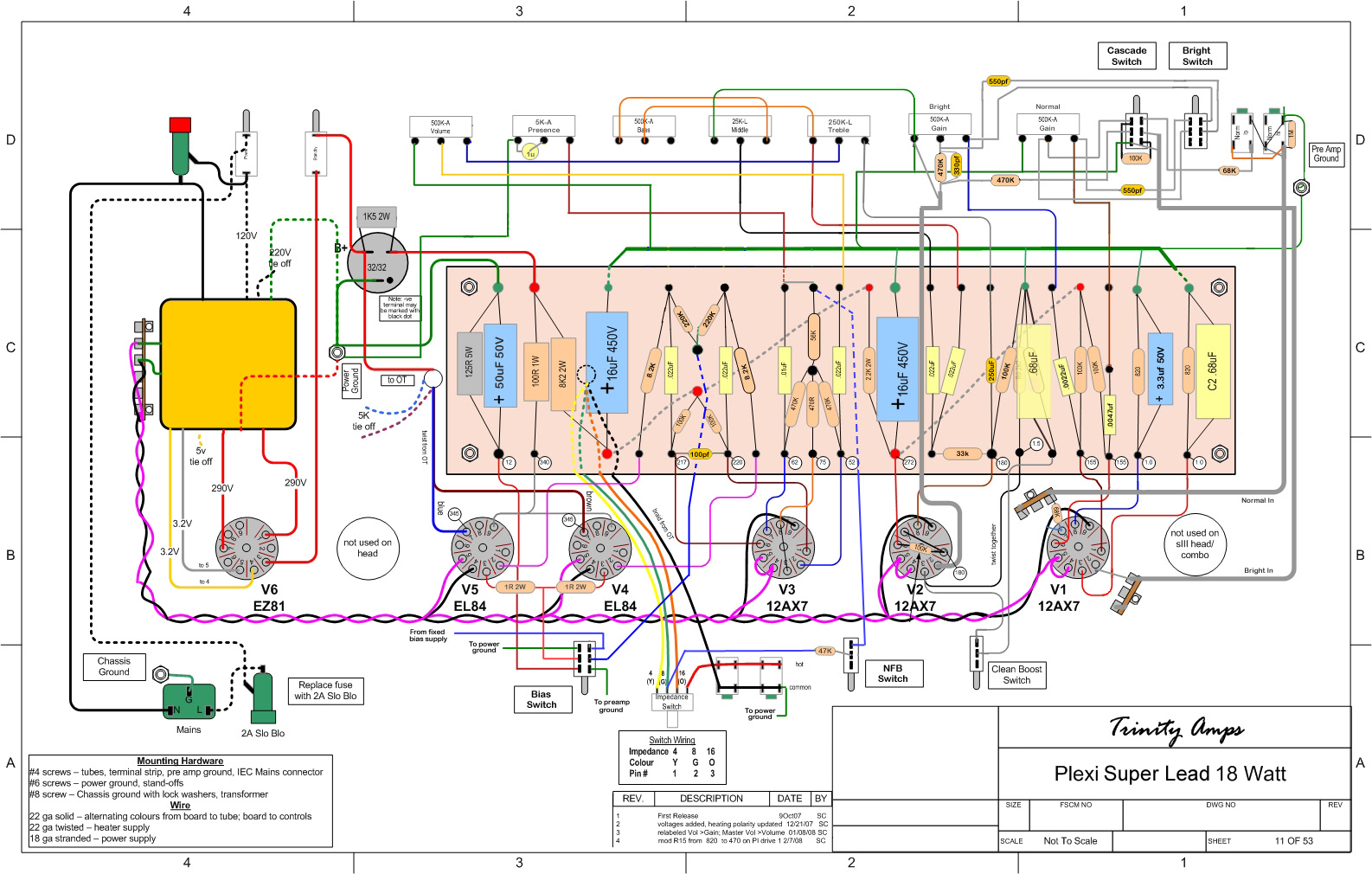

Here are the mods I have done.
V1a coupling cap .0022uF
V1a mix resistor/cap 470K/330pF
V1b coupling cap .0047uF
VR1 bright cap 550pF
V1b bypass cap 3.3uF
V1b mix resistor 470K
VR3 bright cap 550pF
V2a bypass cap on boost .68uF 160V
V2b tail resistor 100K
Tone stack 250pF/33K
Negative feedback 47K off 8 ohm tap
Presence 5K/.1uF
PI 100pF across plates
PA grid leaks 220K
PA cathode cap 50uF
Rectifier switch
Bias switch
NFB switch
Cascade switch
Bright switch
http://www.unimind.us/images/Trinity18_ ... Layout.jpg
http://www.unimind.us/images/Trinity18_ ... ematic.jpg
(my changes are in red)
I have been having problems with the VRM on the diode rectifier so I have not been using it. But to be honest I did not really notice a big difference in the feel (i.e. tightness) with the diodes. This amp is pretty tight even with the EZ81.
Here is a clip of the TMB channel with everything dimed, tube recto, fixed bias (about 75% diss), NFB on, boost on, bright on.
http://www.unimind.us/TrinityPlexi2.mp3
This amp is very versatile from clean to dirty and I am planning on making more clips showing the range of sounds I can get out of it.
Presence 5K/.1uF
Rectifier switch
Bias switch
NFB switch
Cascade switch
Bright switch
I'm totally loving those clips!!! The cascade mode works so well. :D
BTW you can't use a VRM with fixed-bias, as you end up having to scale the boas and screen voltages as well.

zaphod wrote:
What you're hearing is the tone of a cascaded 18W.
...I'm totally loving those clips!!! The cascade mode works so well. :D
Actually those clips are not the cascaded channels. Just the dimed Bright(TMB) channel. I will make some cascaded clips and post them later. The cascade sounds quite different . It sounds 80s ish not like the classic amps.
I have a VRM setup just to scale the diode B+ down to match the tube B+ so that the fixed bias would not be altered when switching between rectos.
Les

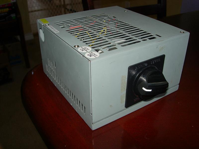

Unimind wrote:
+ 1 homemade $50 attenuator
I've been looking into building an attenuator. Any chance of seeing the attenuator schematic?
** b0b0 **
- This Space For Rent -
 Post subject: Re: New Plexi Build
PostPosted: Fri Mar 18, 2011 1:52 pm
Posts: 226
Location: Dallas, Tx
This is the one I built. http://www.regiscoyne.com/coppertone/ Mine is not as pretty.
The schematic is on this page. http://www.regiscoyne.com/havanatone/ Scroll down toward the bottom for the schematic.
The main part is the 100W Stereo LPAD which I got from Parts Express.
http://www.parts-express.com/pe/showdet ... er=260-264
Here's mine.
Les

Using an old computer power supply case & fan is a great idea. One thing concerns me a bit about the schematic.....the switched jack on the spkr out. If the unit is set to bypass & nothing is plugged into the jack, wouldn't it be a dead short to the amp? :shock:
I guess it would be but just like the amp I would never run it without a speaker plugged in.

You can read up on this. It's better for a tube amp to see a short at the speaker output than an open circuit. It's counter-intuitive since it's not the same for solid state. The tubes end up limiting the amount of current they can pull with the output shorted, whereas with the output hanging open circuited you're likely to blow the output transformer.
True-dat!
I did not know that.....excellent info.
Presence 5K/.1uF
PA grid leaks 220K
PA cathode cap 50uF
Rectifier switch
Bias switch
NFB switch
Cascade switch
Bright switch
-Les

is the Bias switch to run the 6v6's?
what is the purpose between the two 1R resistors going to V4 and V5?
