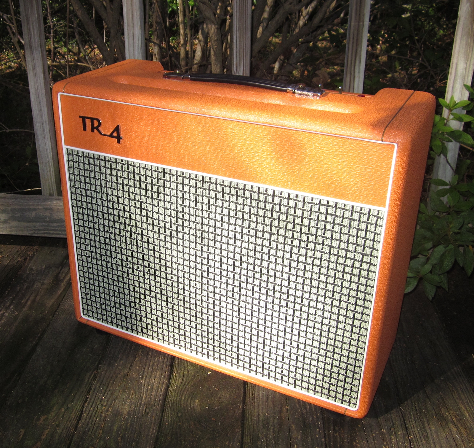

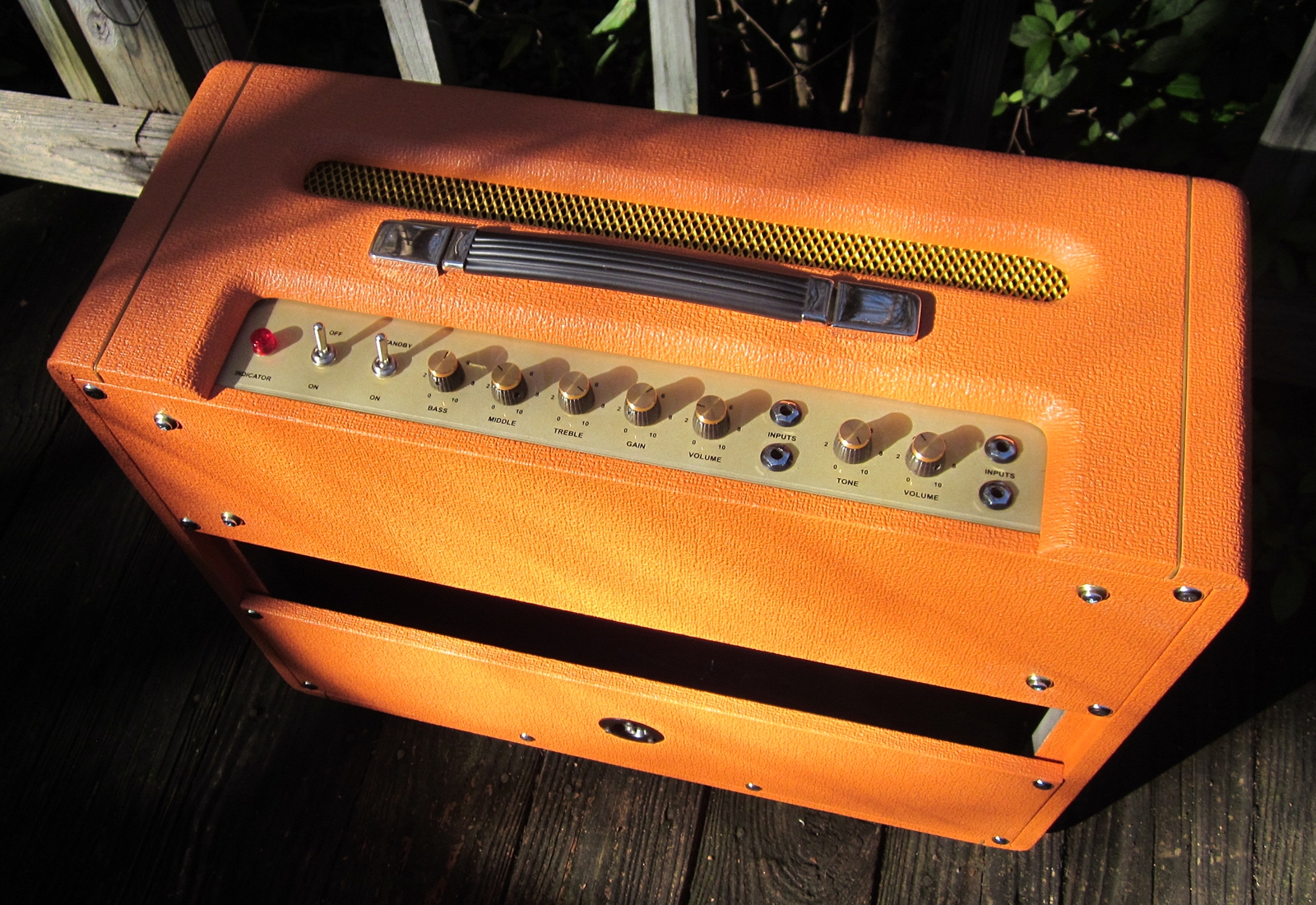

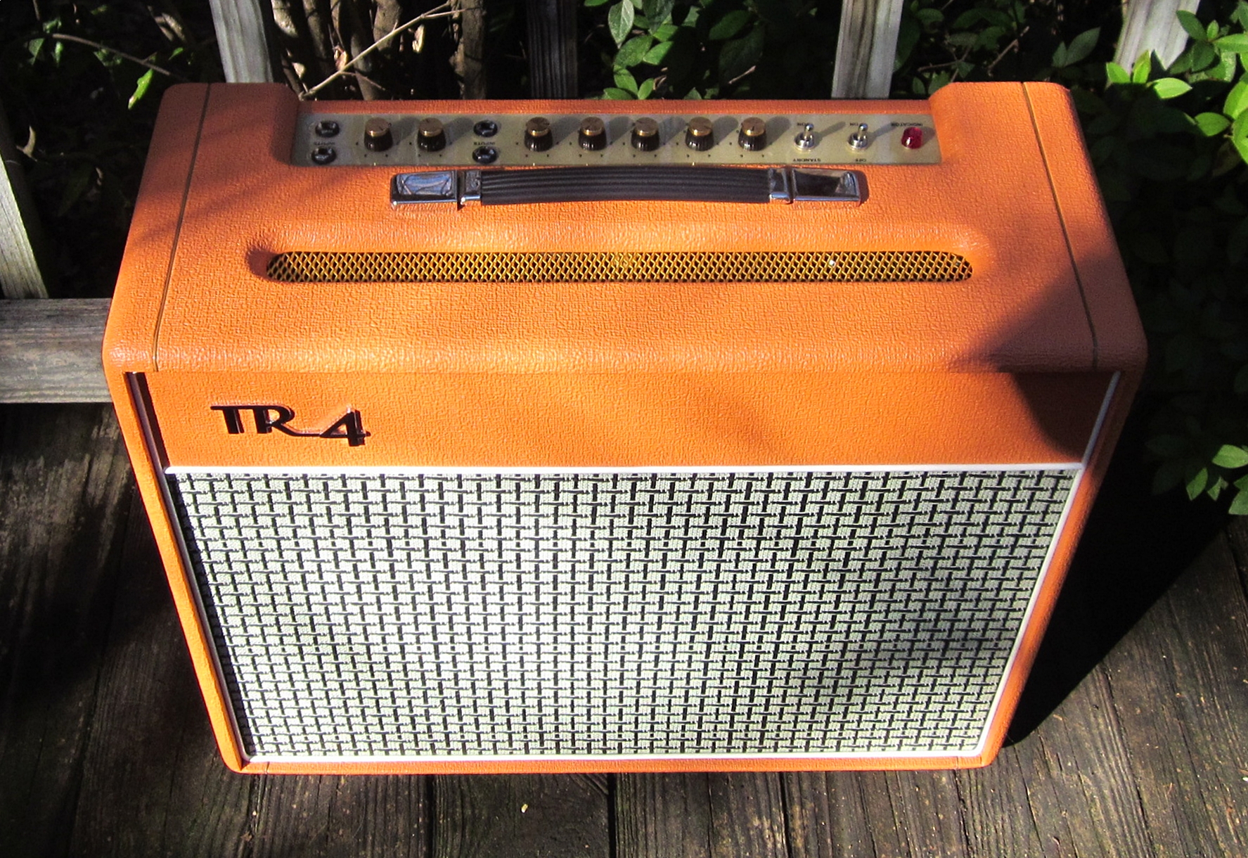

Here's the amp in its case; it is a 2 x 10 rig.
The color and grill cloth scheme are accidentally
(I only realized this after the fact) the same as
the Marshall Mercury series from c. 1972.
I just went for something that said "c. 1972!"
File comment: Cabinet by Sourmash in Florida.
I added the logo from the boot
of a Triumph TR-4.
File comment: Blue Pup and Silver 10

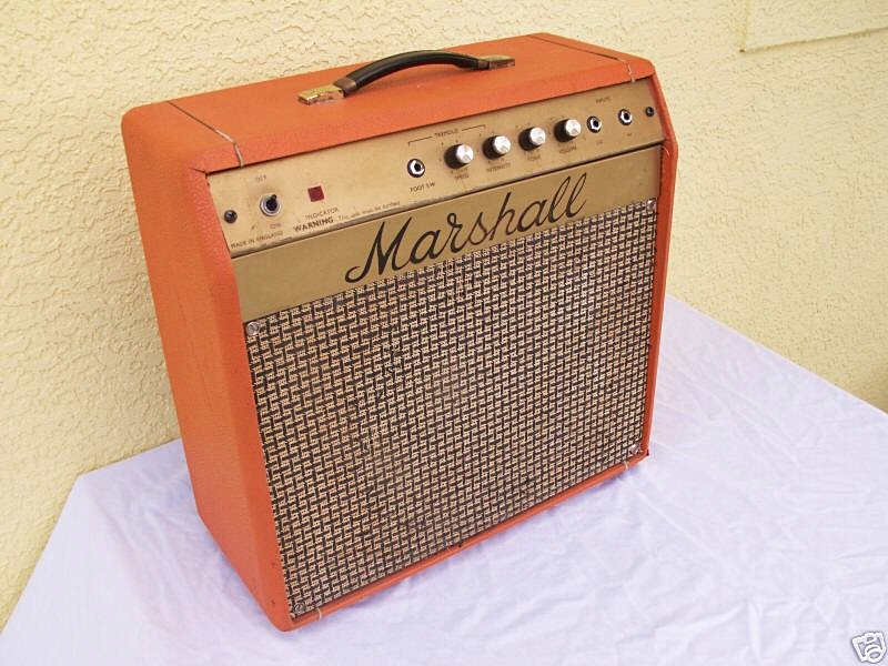

(Attached pic of Marshall Mercury--similar color scheme as my cabinet).
File comment: This was a small amp made by Marshall c. 1972
