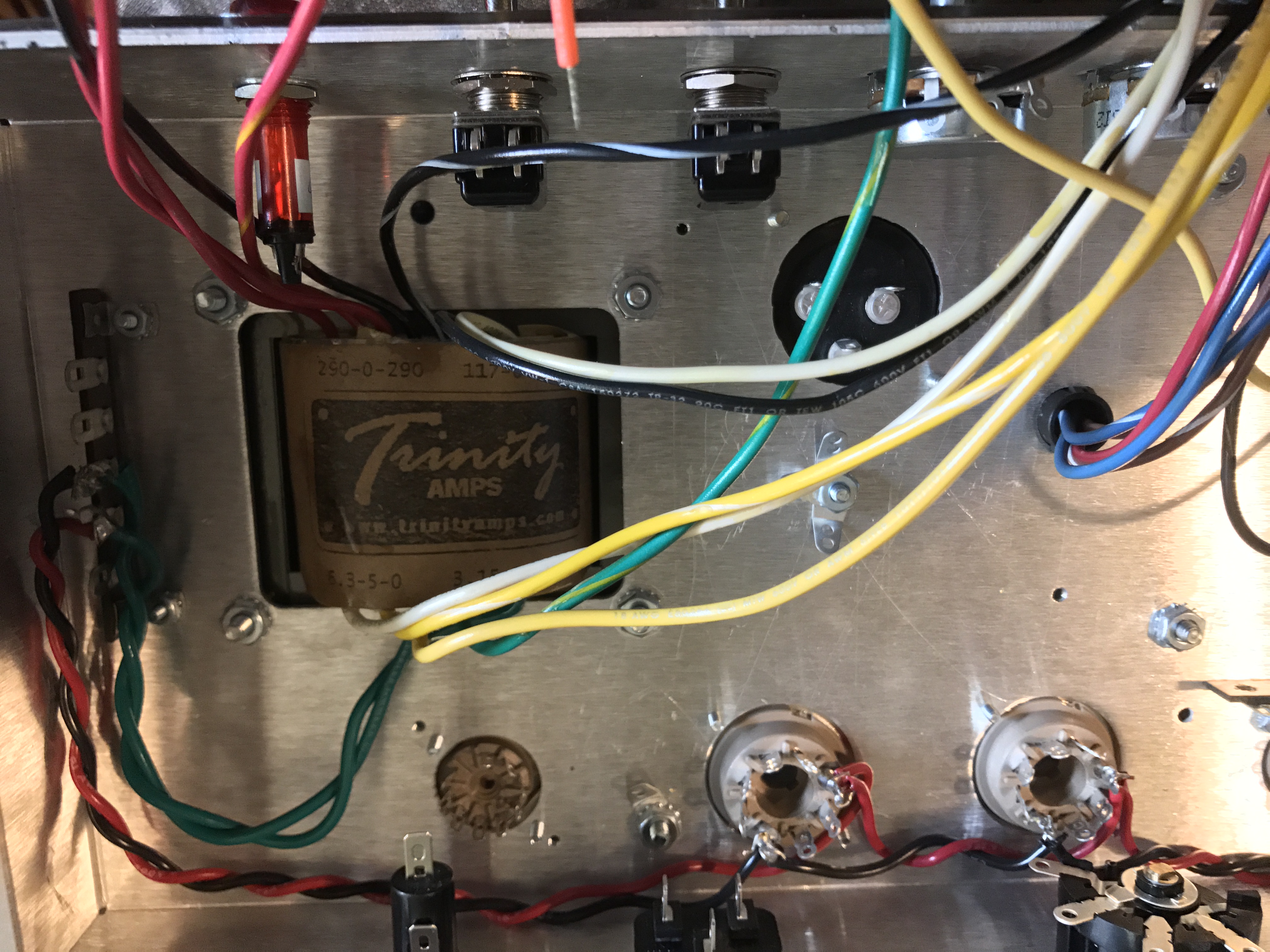

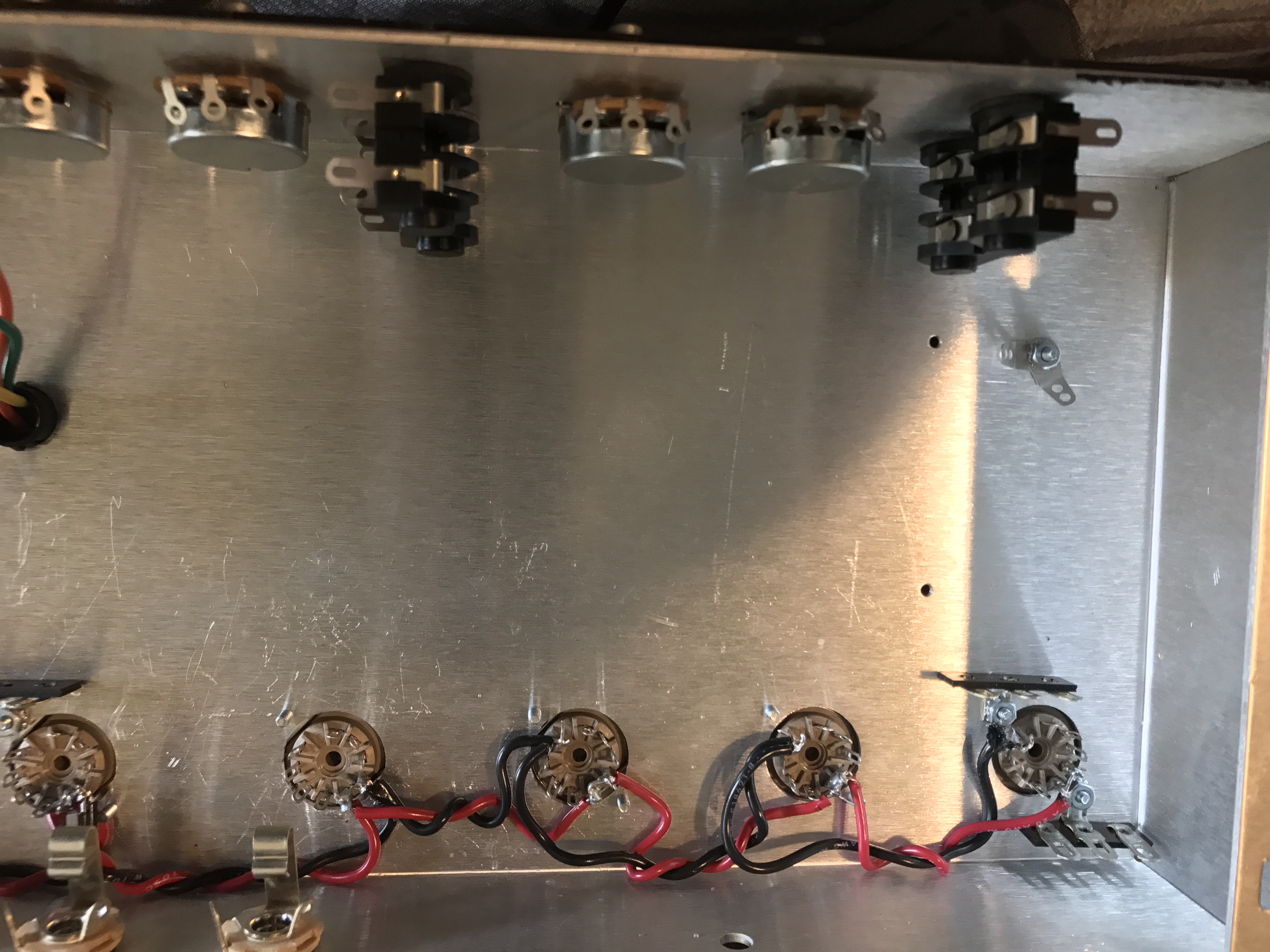

This is my first amp and after a busy few month or two I was able to start.
I am not a complete beginner when it comes to any of the skills needed and am well versed in how tube amps work . Anyway all help/comments/suggestions are welcome if you see anything wrong don't be afraid to call me out. I will be adding the VRM module after completing the amp
 Post subject: Re: 18watt v6 slll build
PostPosted: Tue Sep 05, 2017 9:53 pm
looks fine so far.

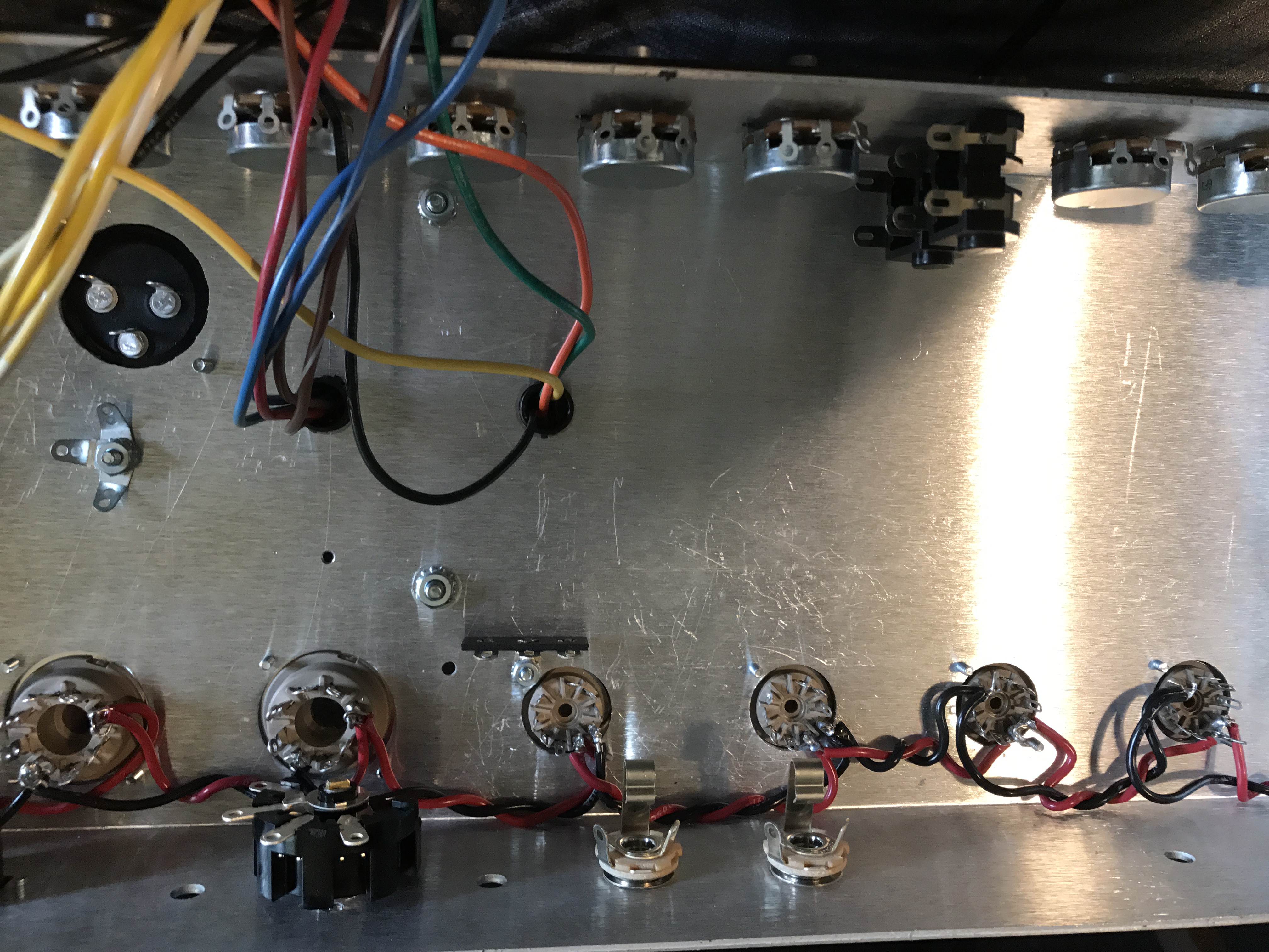

Took a break because this year was busy for me but I’m back at it and I have almost finished the power section
PostPosted: Wed Sep 05, 2018 10:52 pm
good tome to test the raw ac voltages!

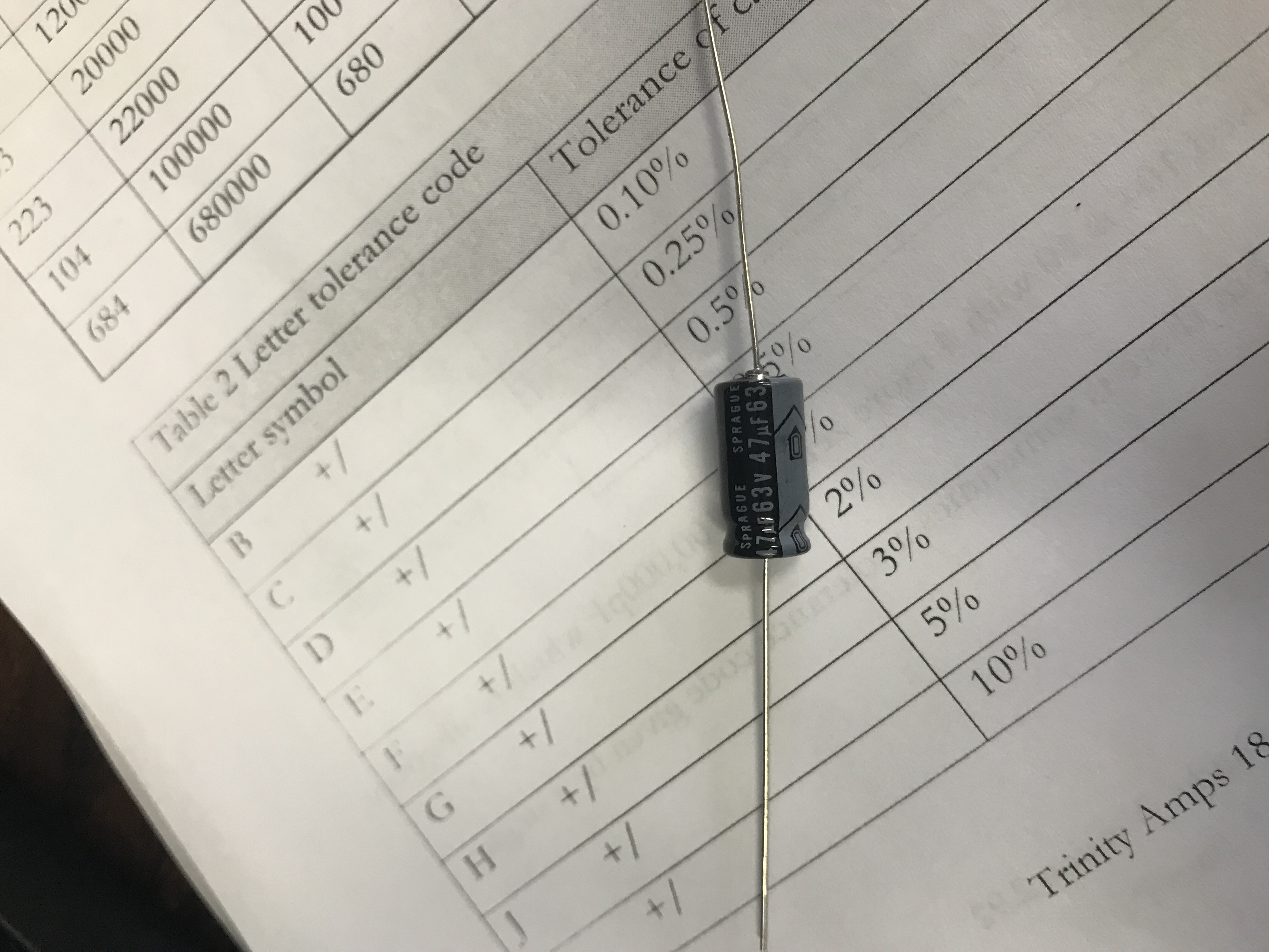

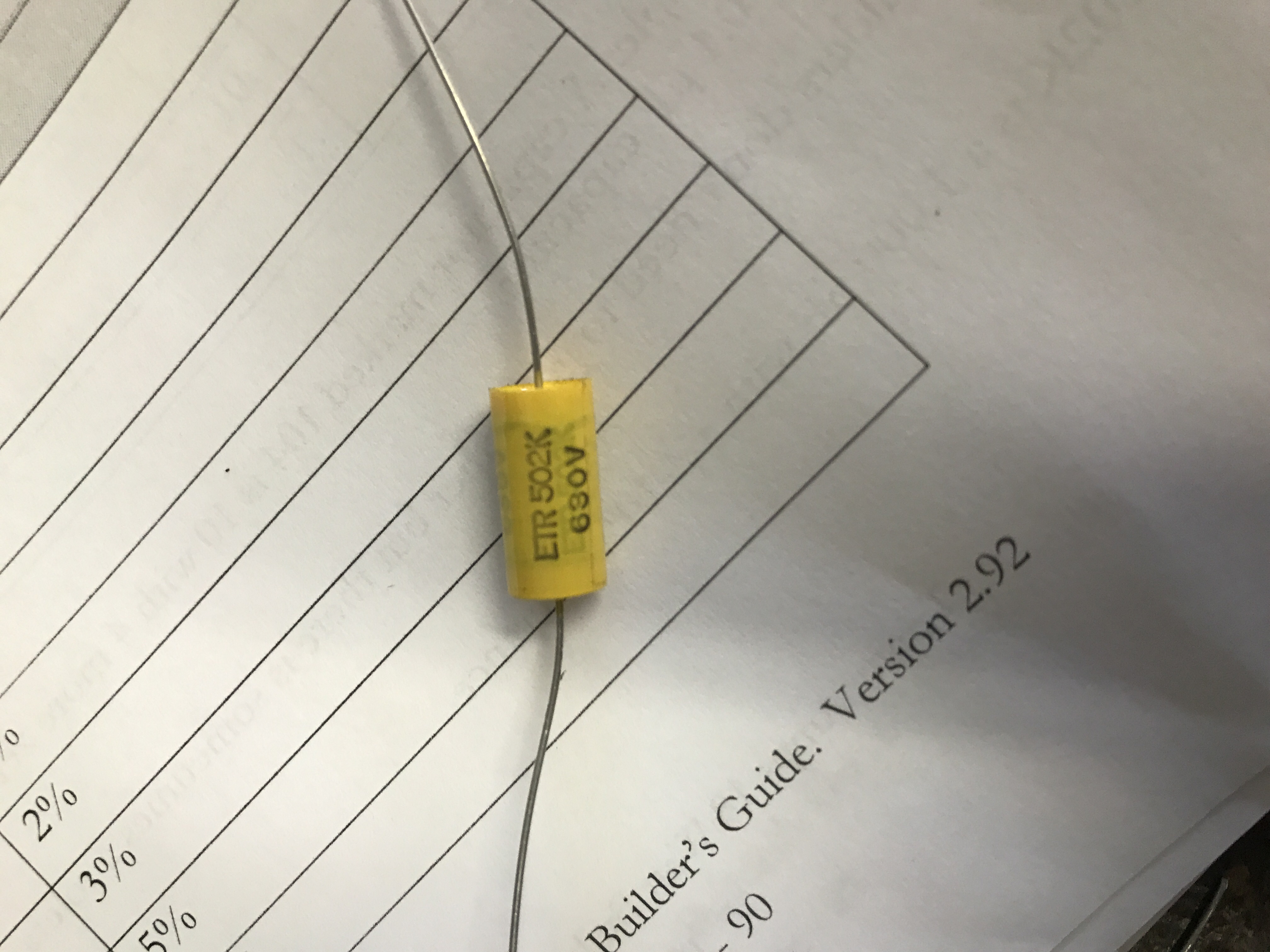

Yep checked the voltages though I ran into something that confused me slightly the schematic call for the c10 capacitor to have a value of 50uf and I don’t have any of those but I do have 47uf capacitors are those what’s supposed to be used in that spot also are the non polarized 502 code capacitors supposed to be the .0047 capacitors

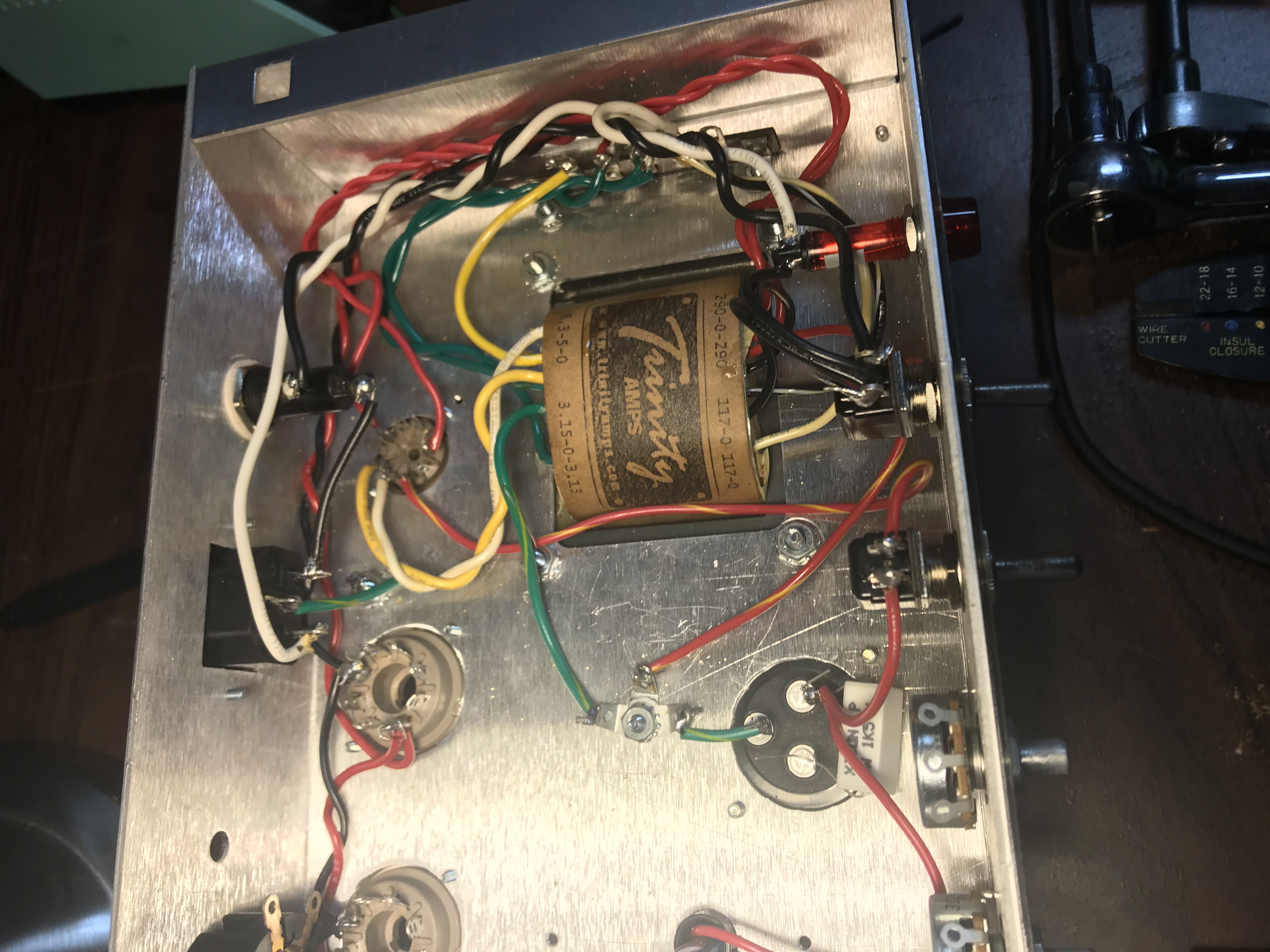

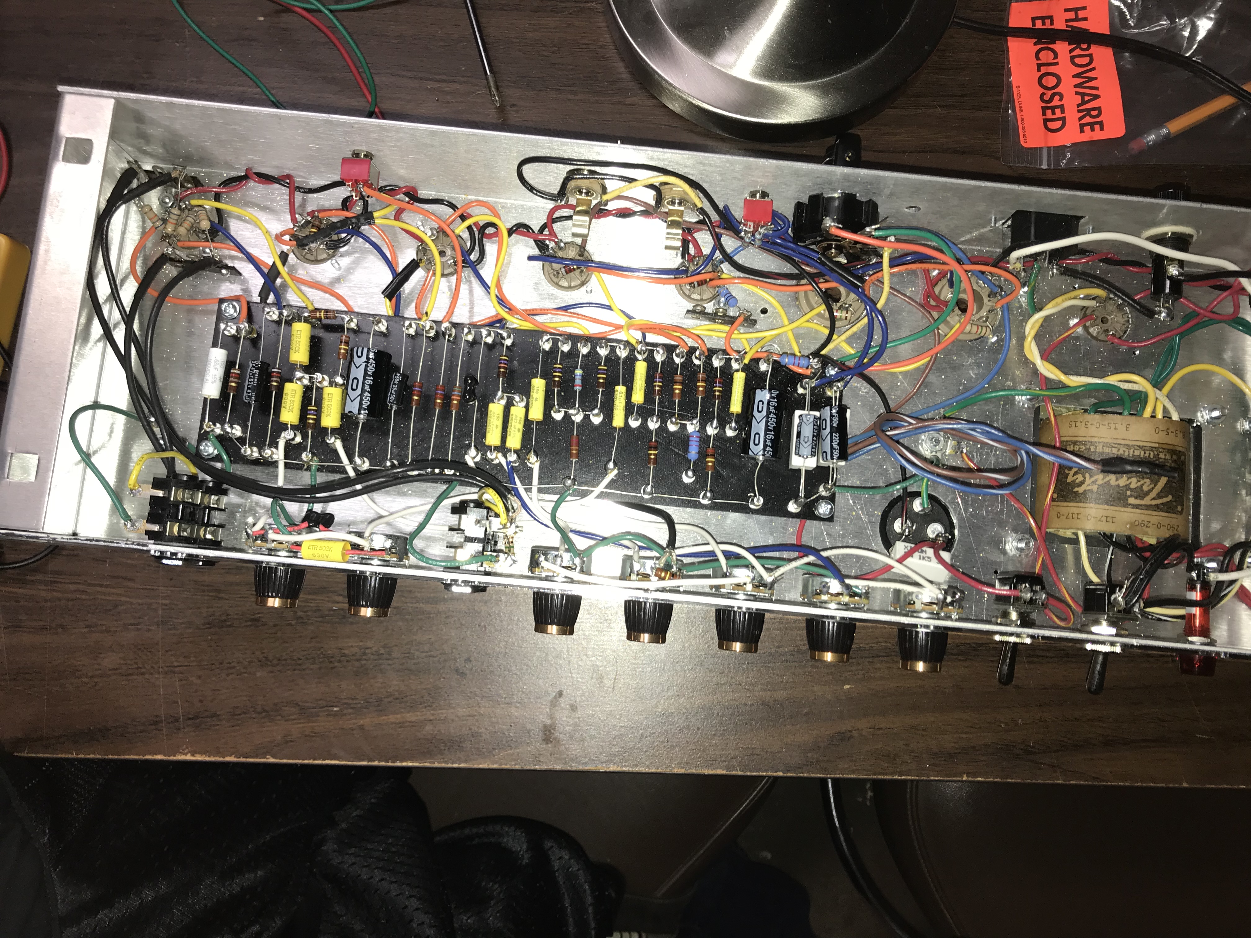

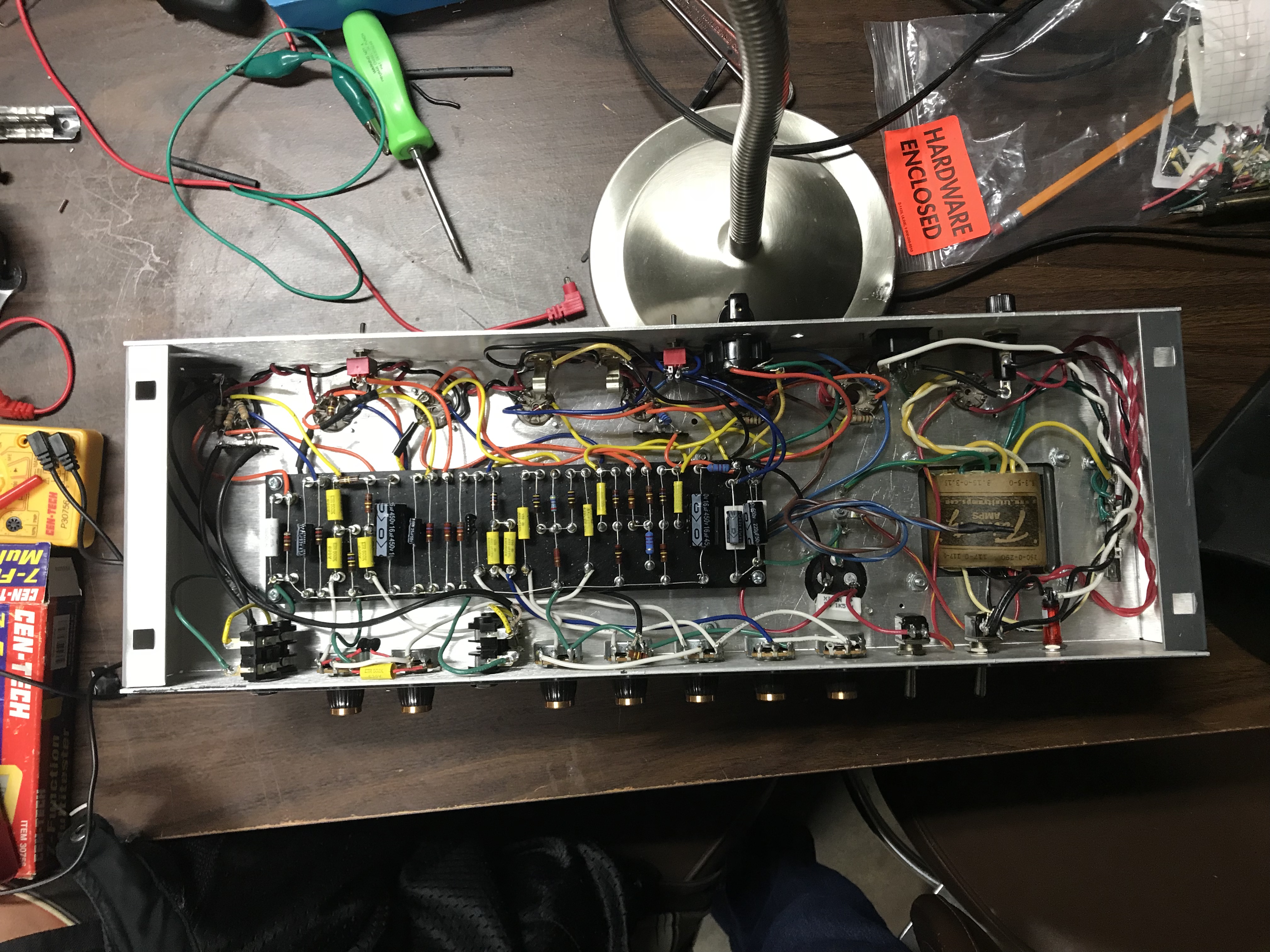

Finished the amp now having some troubleshooting issues the volume on the normal channel is really quiet and there is no volume on the tmb channel. What I was going to do to start was check all my connections and make sure everything is in the right place
PostPosted: Wed Sep 19, 2018 1:05 pm
Meaure all the voltages. Compare to the chart.
Check all grounds and jumpers and connections to/from the board.
Make sure all the above board turret jumpers are in place correctly.
