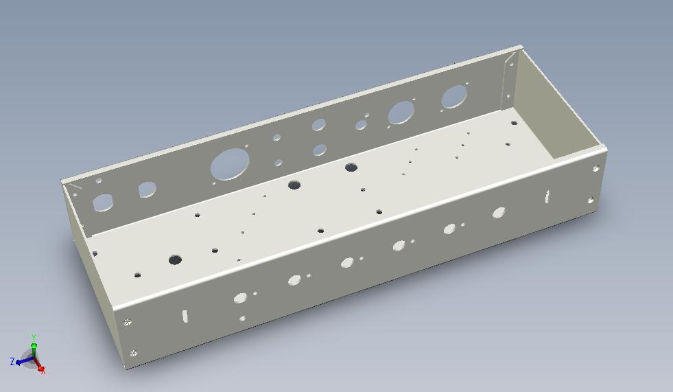

PostPosted: Fri Apr 23, 2010 9:26 pm
Here's a view of the final revision of the Tramp Chassis (by Peerless Design).
