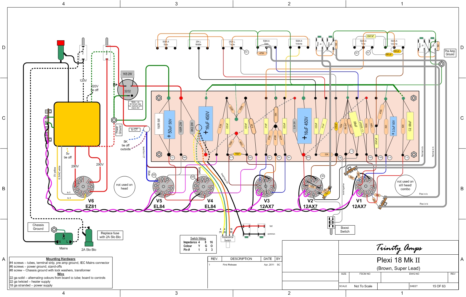

Updated Layout added with R10 @ 100K

Stephen, I have been following this thread but I have lost track of which version of which mod. you have decided on. Can you point me to the schematic that relates to the layout above?
Stew
 Post subject: Re: Plexi Brown Mods
PostPosted: Tue Mar 29, 2011 9:43 pm

First Layout added
coco, in the layout, V2B cathode resistor R10 still says 56K. It should be 100K. It is correct in the schematic. Otherwise everything else looks good. 8)
Les
PostPosted: Wed Mar 30, 2011 8:40 am
fixed & re-posted
