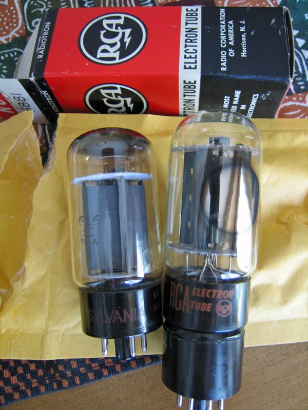

Just received two old 6L6GC in the mail
One is a RCA black plate and the other is a Sylvania.
The RCA is plugged in a socket saver because it has lost it's keypin. I use the saver because it's easier to plug it in correctly in the amp.
I started with the Sylvania and haven't tried the RCA yet because the Sylvania sounds so good I don't want to take it out. :)
As someone posted before, you get a tone similar to a 6V6 but with more clean headroom. You also get more volume, the speaker works harder and the amp seems to become more alive and the tone seems wider, fuller. You can also choose to throttle it down with the VRM and Master volume and that more powerful beast stays very manageable.
So in conclusion I can say that I like the 6V6 tube but the 6L6 (Sylvania or RCA, we'll see) will stay in the amp because it's like a 6V6 on steroids (in a good wholesome way).
The price for used old american tubes can be as low as 30$ or 40$. The trick is to buy single tubes. As was posted earlier, the price goes up when they are offered in pairs or 4 at a time. The buyers are then looking for matched tubes which we, Tramp users, don't need.
