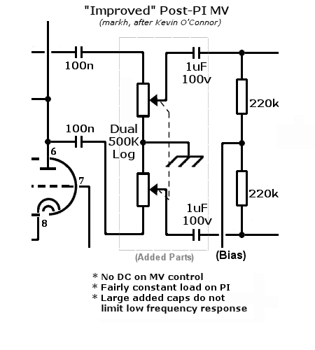

"even the PPIMV now"
What PPIMV design did you put in there and how did you fit it? Did you use the MV hole so now the MV controls both channels?

PostPosted: Wed Dec 07, 2011 3:01 pm
Docs updated in resource section.
Schematic download/file.php?id=575&mode=view
Let me know if it is correct per your latest build, and how well the PPIMV works.

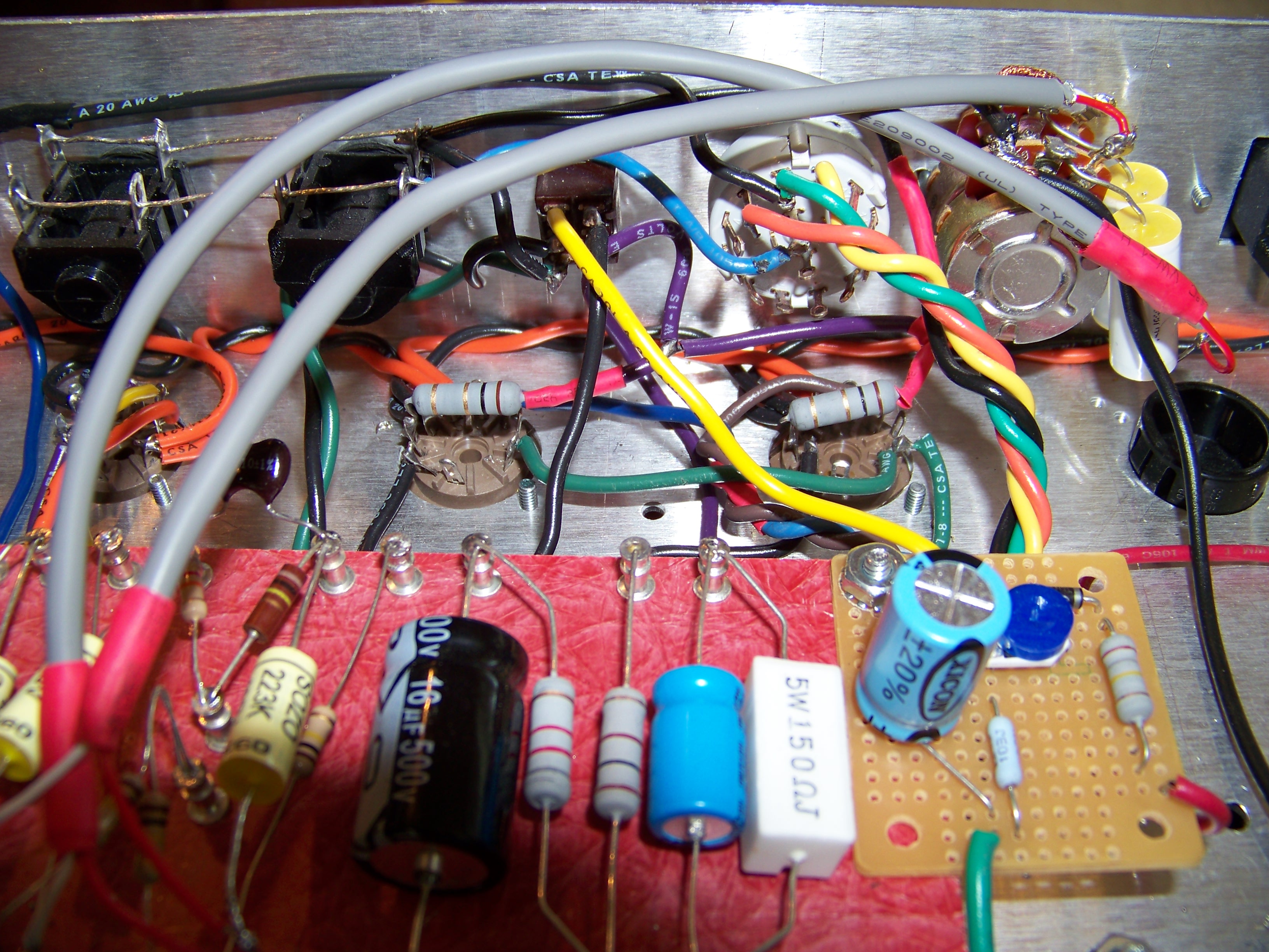

Here is the PPIMV design I used: download/file.php?id=396&mode=view
I drilled a hole on the back next to the impendence selector as seen in this pic: download/file.php?id=476&mode=view
Schematic looks good.
The PPIMV works very well. I have been using it for months now without any issues.
