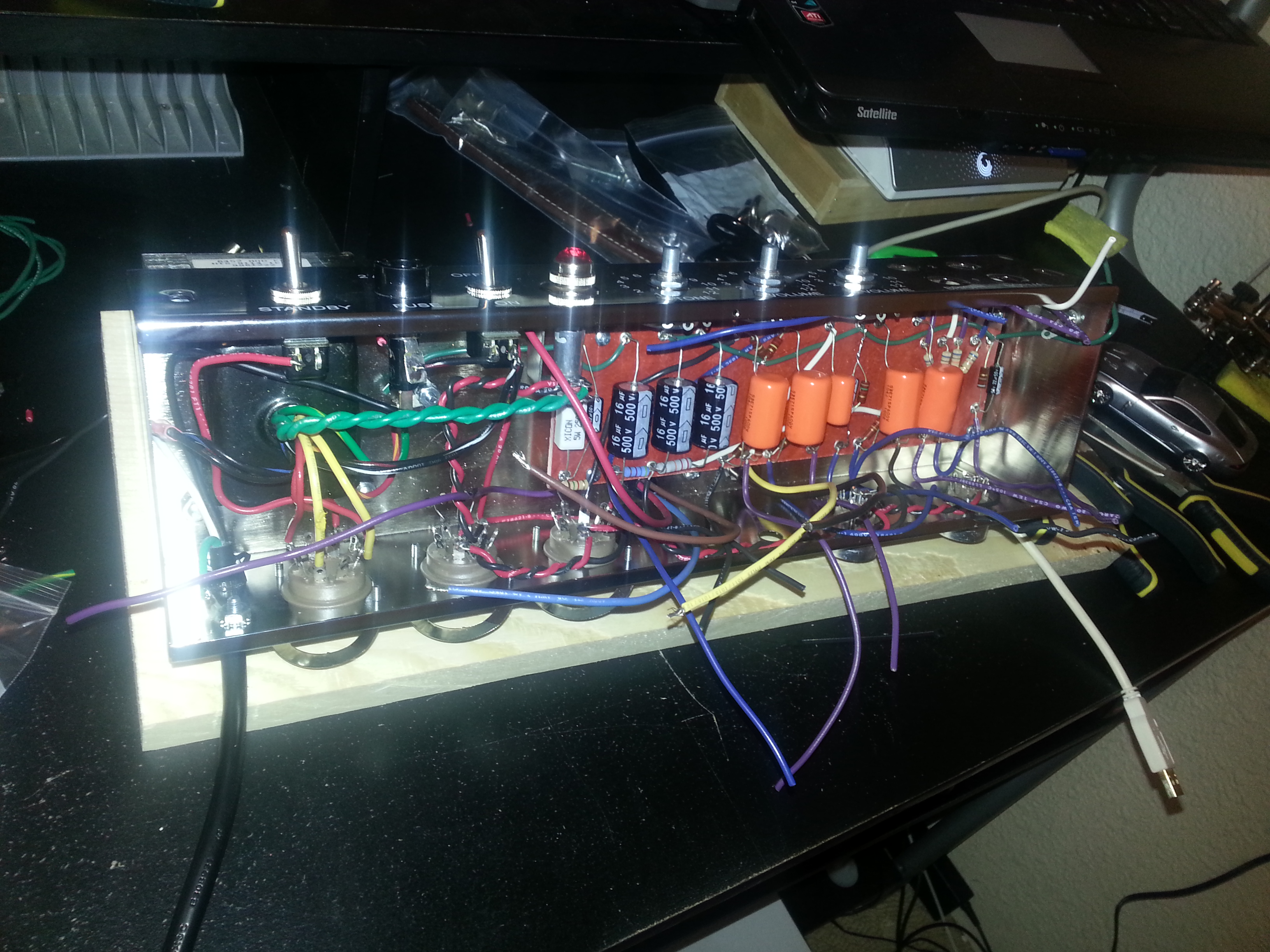

Finely got it rite :shock: I hope ;; it looks good

PostPosted: Wed Oct 24, 2012 3:31 pm
One of your filter caps is backwards!
PostPosted: Thu Oct 25, 2012 12:13 pm
Posts: 204
Location: Vancouver BC
Actually,there are 3 backwards,the small 25uf on the far left and the 3rd 16uf and the middle 25 uf, if I'm not mistaken.

thanks guys i have it now caps flow north south do the resisters have a inline flow

Your resistors are not polarity sensitive.
PostPosted: Sat Oct 27, 2012 12:03 pm
Caps look good now. The rest are'nt polarized. Practive your soldering and get a good hot, shiny solder joint. Very important. 25W iron, .032" flux core solder.

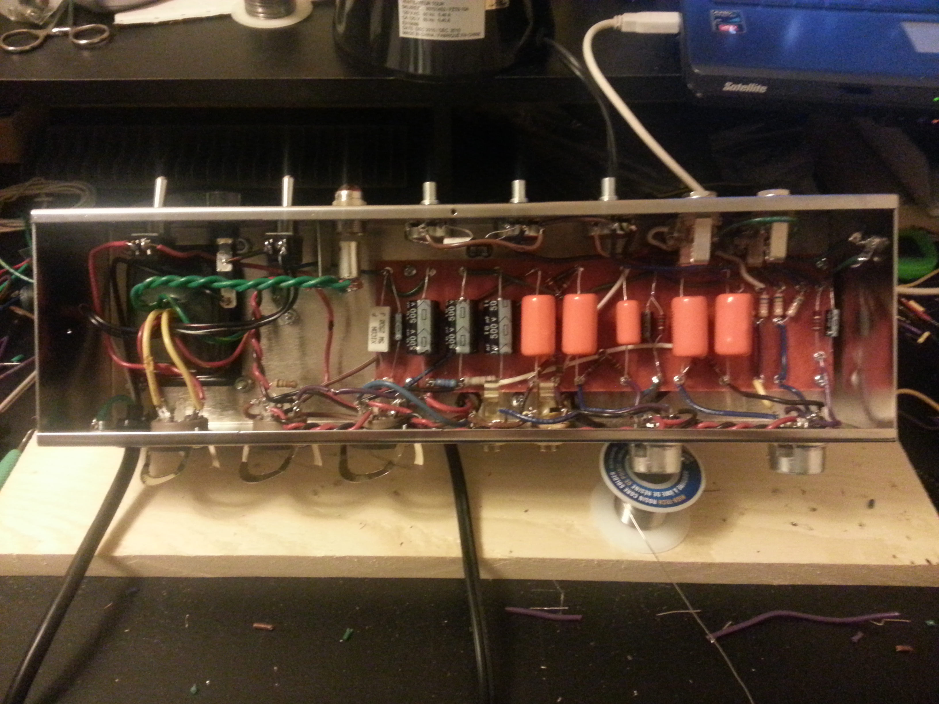

heres where im at today picked up my tools yesterday 15 hr of work and !!!
PostPosted: Tue Oct 30, 2012 7:41 pm
Looks good. And a healthy snack to boot!!
Keep it neat and it will be fine! Short wires!

well i dont know ... im going to chase the wiring down at least 2 more time just to make sure im
tired and more tired ;;;
good night
