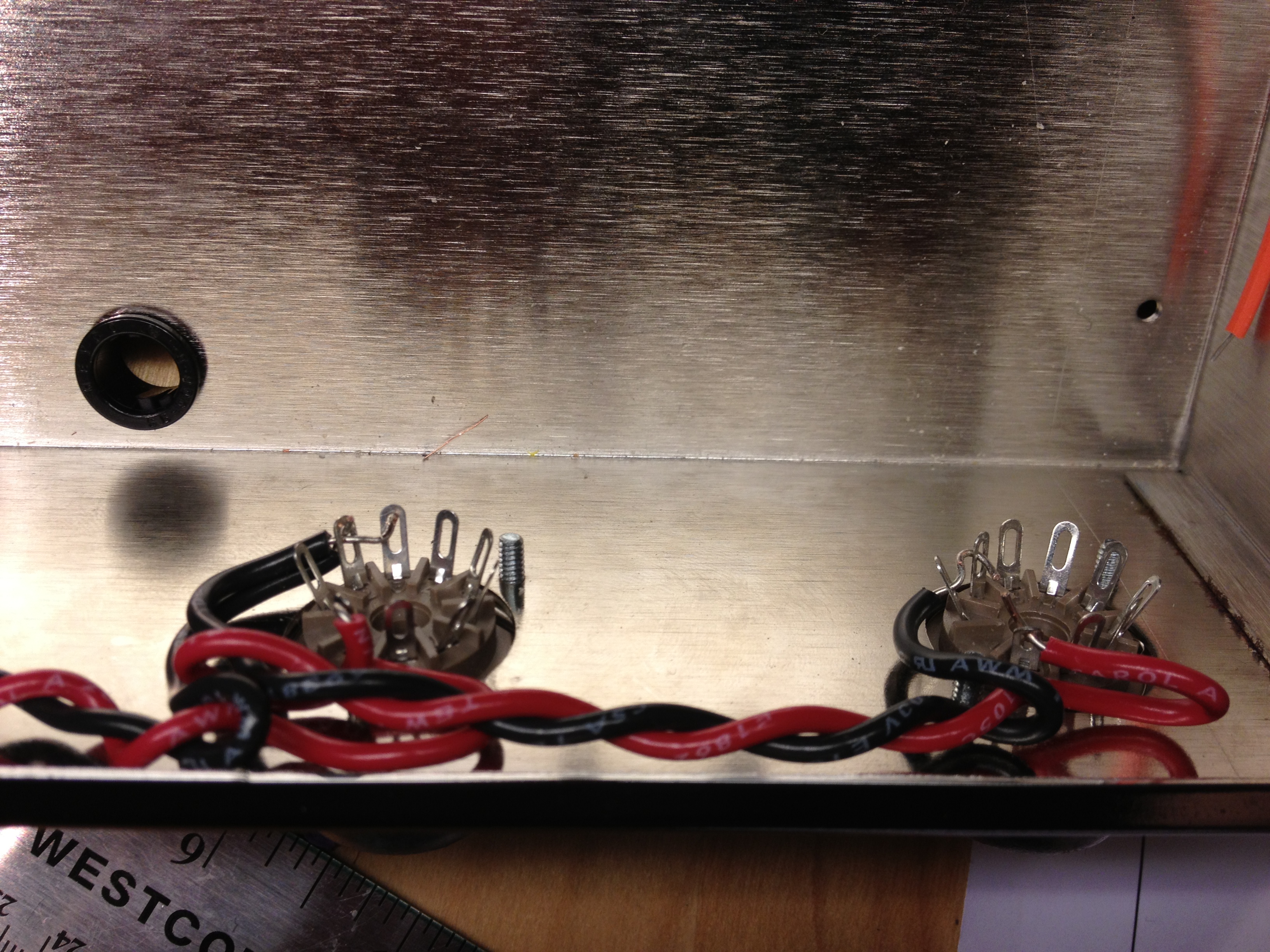

Stephen:
Hmm.. could be the lighting some appear shinier than others due to the angle of light. Some solder points on the board had the solder "crater" into the hole so they look different than the joints that "puddled" on top. Perhaps you could tell me which ones are suspect? Thanks.
A had a set back on Sunday :( as I discovered a mistake in the heater wiring pins for V1 and V2. Pins 9 for both sockets were Ok but where I should have had pins 4-5 I had pins 3-4 by mistake. I think i was thrown off by the diagram as my sockets are orientated 25 degrees different than the diagram. Maybe the diagram could use updating or maybe it is my lack of experience dealing with tube sockets on the business side. :damntech:
Before I resolder them perhaps a comment on keeping the signal wires out of the way of the heater wires. See my V1 setup.
