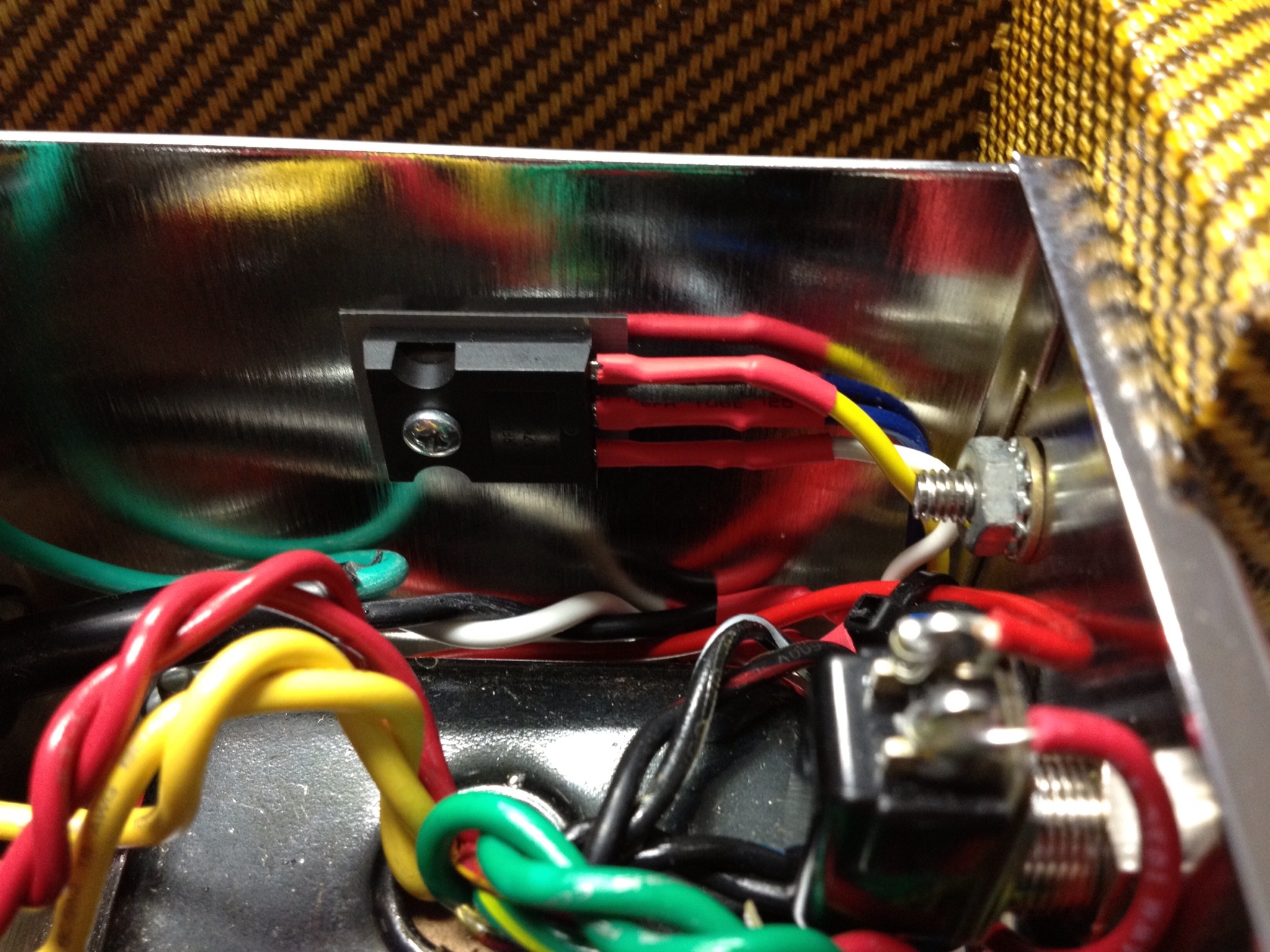

PostPosted: Fri Jan 18, 2013 9:13 am
You don't need the isolating insert. The MOSFET Trinity uses is designed in such a way that the insert does not make contact with any of the MOSFET's active elements.
PostPosted: Fri Jan 18, 2013 9:29 am

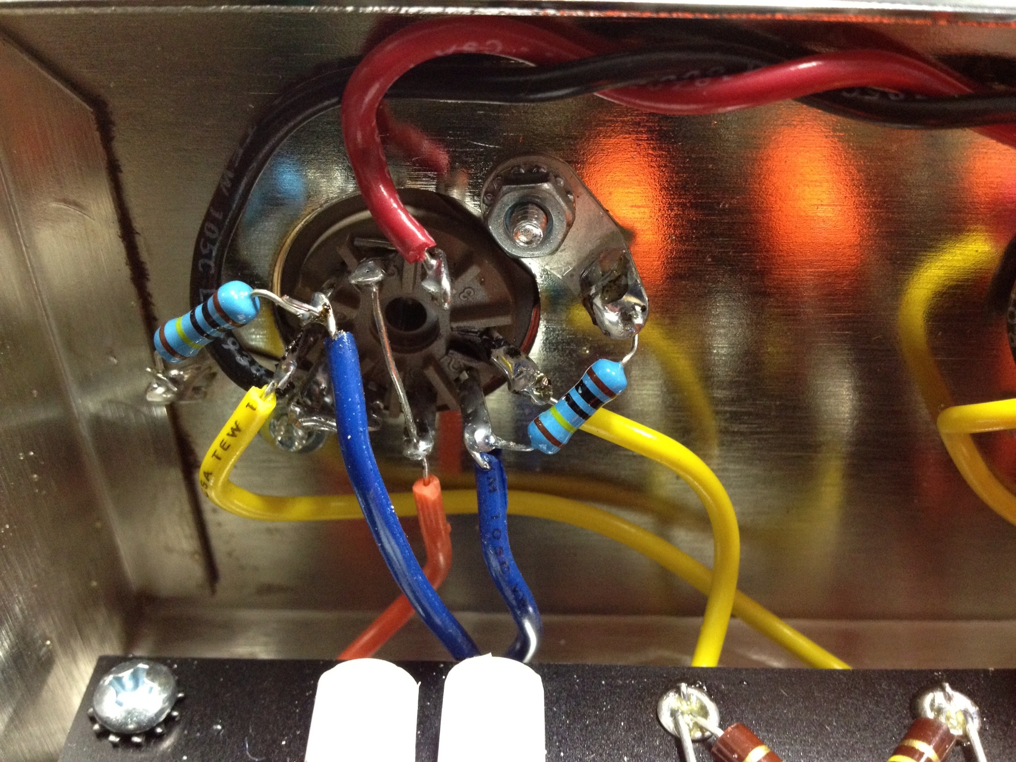

PostPosted: Wed Jan 23, 2013 12:43 am
I see the 1M is on the jack and that is OK if there are no DC blocking .1 uF cap. They should really be on the other end of the .1 uF cap to ground.
It will work, but not ideal.
The blue resistors are the 1M moved to tags on the chassis.
Looks like a good build.

Posts: 40
Why should the 1M be on the other side of the capacitors? What could be a result of me putting them where I did?

PostPosted: Wed Jan 23, 2013 2:24 pm
The bias of the first stage my be messed up. The 1M resistor won't be able to provide a ground reference to the tube's grid if it is on the input jack being blocked by the cap.
Not a big deal, but I would move it.

I can easily do that. How can I tell if the bias is messed up?
PostPosted: Thu Jan 24, 2013 9:43 am
The sound will be "spitting, blatty, farting out". You'll notice, it doesn't always happen, depends on the tube.

Posts: 40
OK, I'm going to install them on the tube socket then, just to make sure. I'll have to drill a hole for the solder tab. I don't want to have to modify this amp again in future.
PostPosted: Thu Jan 24, 2013 10:09 am
Don't drill the chassis, just add the little ground/solder lugs like Coco did in the post above.
PostPosted: Thu Jan 24, 2013 10:22 am
Posts: 40
I don't think I have nuts for the tube sockets' bolts. I'll have a look, maybe I will have. The hardware stores here only sell metric sized nuts and bolts so the imperial sizes are not easy to get.

You can run the 1M from the other side of the .1uf cap to the ground right on the board if you want. I had the ground lugs handy, but you can just run them beside the cap to ground.

PostPosted: Sun Jan 27, 2013 10:05 am
Plastic insert is not required.but the grey sil pad underneath it is required. The plastic insert is for transistors with metal tabs (e.g. TO3 package). There is a pre tapped hole in the end of the chassis to mount the MOSFET..
