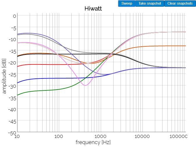

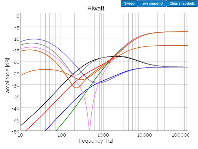

Two response graphs for you to peruse!
STANDARD TRIWATT TONE STACK C6 at 1n
TRIWATT TONE STACK WITH C6 at 47n
