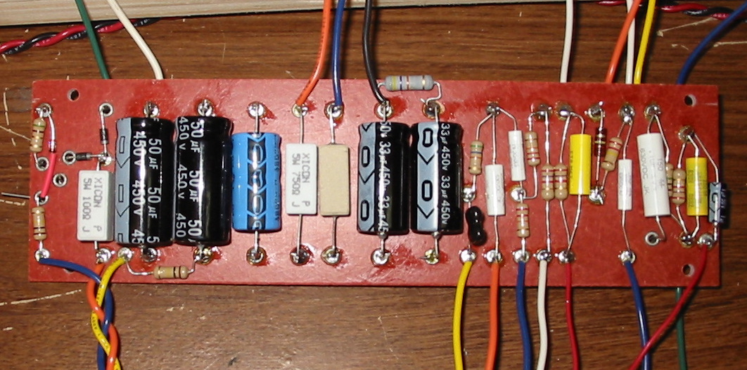

I won't post more than a few pics, as snowy already did a fantastic pictorial AND his work looks a bit better than mine! :oops: I went a little bit out of sequence from the instructions, as I'm waiting for my IEC connector to show up today (OUT FOR DELIVERY, WHOO- HOO! :happydance: ) I figured it was a good idea to not install the transformers or anything else not easily removed in case of any "metalworking" that may be needed to fit the IEC nicely.
Tag board assembled:
[img]
[/img]
Pots are wired except for the flying leads. Really, all I have left to do is install/wire the transformers, do the heater wires and mount/wire the board. Should be testing today. This is a 3 day build! :P
My sincerest thanks to Stephen for a well thought out package/kit. I am soked to hear this little brute!
Thanx Again,
Gene

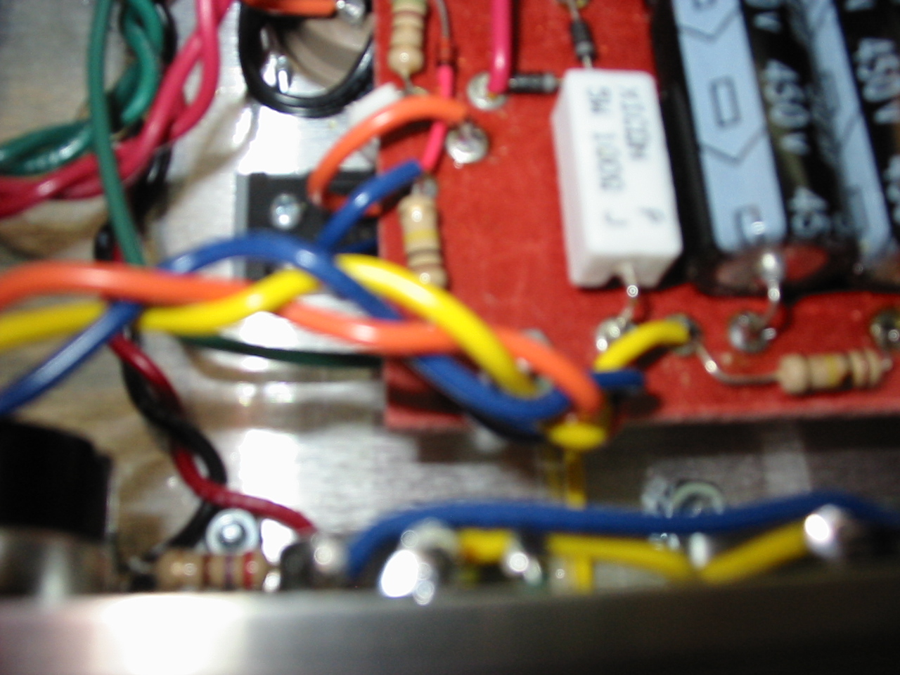

PostPosted: Sat Oct 19, 2013 11:55 pm
Posts: 43
Location: Las Vegas, NV
I had the terminal 2 & 3 wires reversed at the pot. Fixed that and now with the pot at "idle" I get 457 VDC and as I turn the pot clockwise the voltage "drops" to about 430 VDC.The picture I'm attaching could not be gotten any clearer. If you look at the pic in my first post of this thread, it is clearer. The black band of the Zener is attached to the 100K resistor and the other end is to the junction of the 5R & positive of the first filter cap. Is there a chance that the pin-out order of this MOSFET is different than on the on the layout. Being an idiot, I simply went by the layout for orientation rather than actually looking at the MOSFET for G, D & S markings. :damntech:
Thanks,
Gene
PostPosted: Sun Oct 20, 2013 4:30 am
Posts: 43
