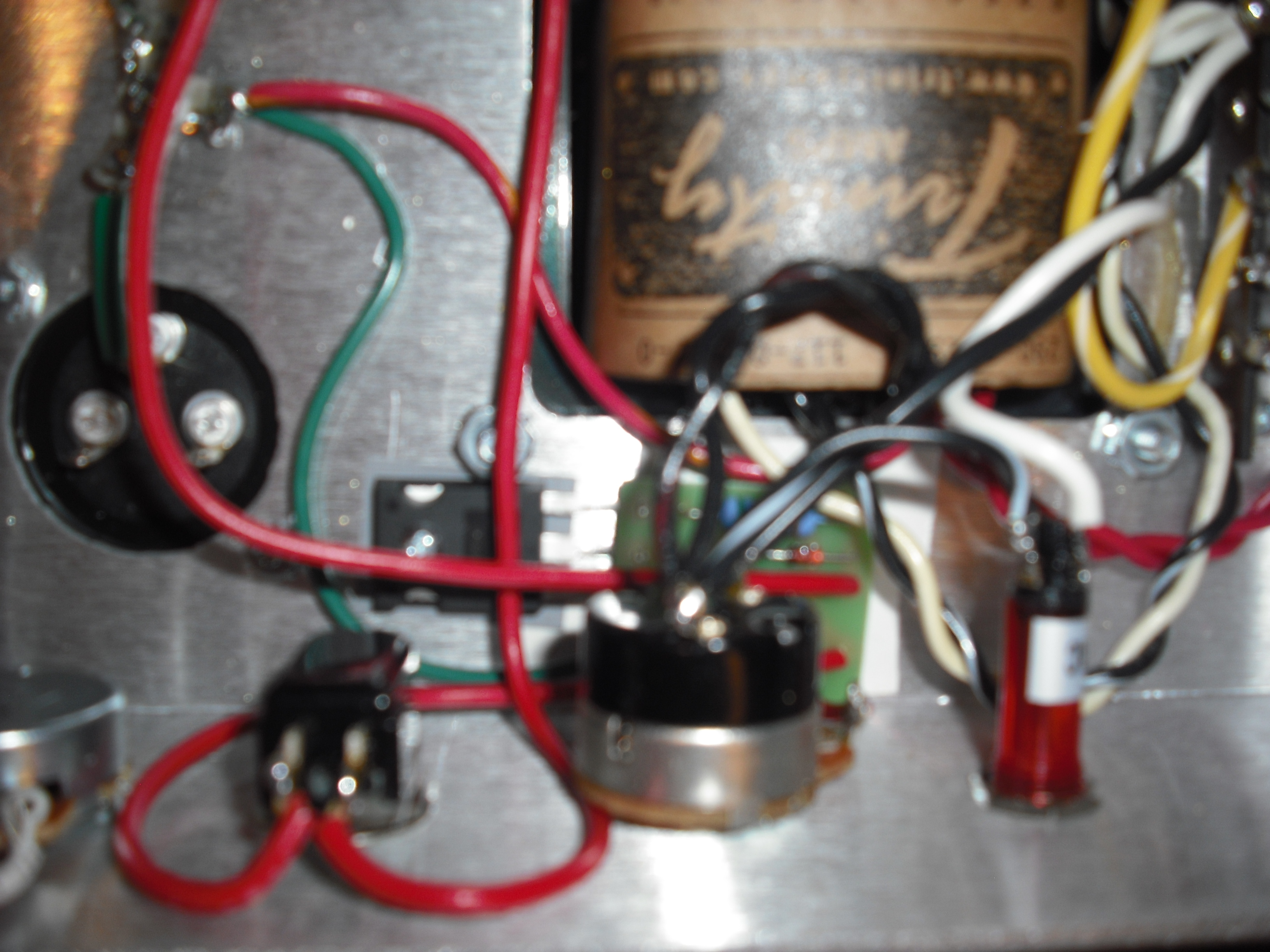

Wired up the Heaters.
Connect up the VRM.

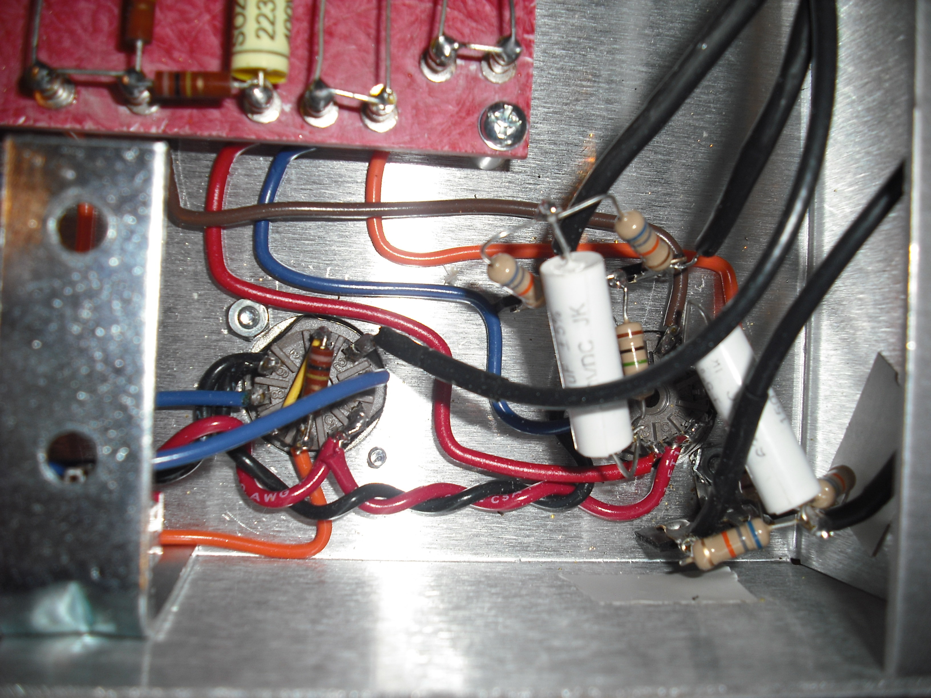

Note : Originally I was connecting up the boost and cathode switch boards, but, I had an issue and went back and removed these and went back to the stock design to make sure everything works correctly... I am in the process of debugging some voltage issues and once they are solved, I will go back and try to get the boards working..

V4 & V5 EL84's an the output jacks.
V6 & V7 6V6's

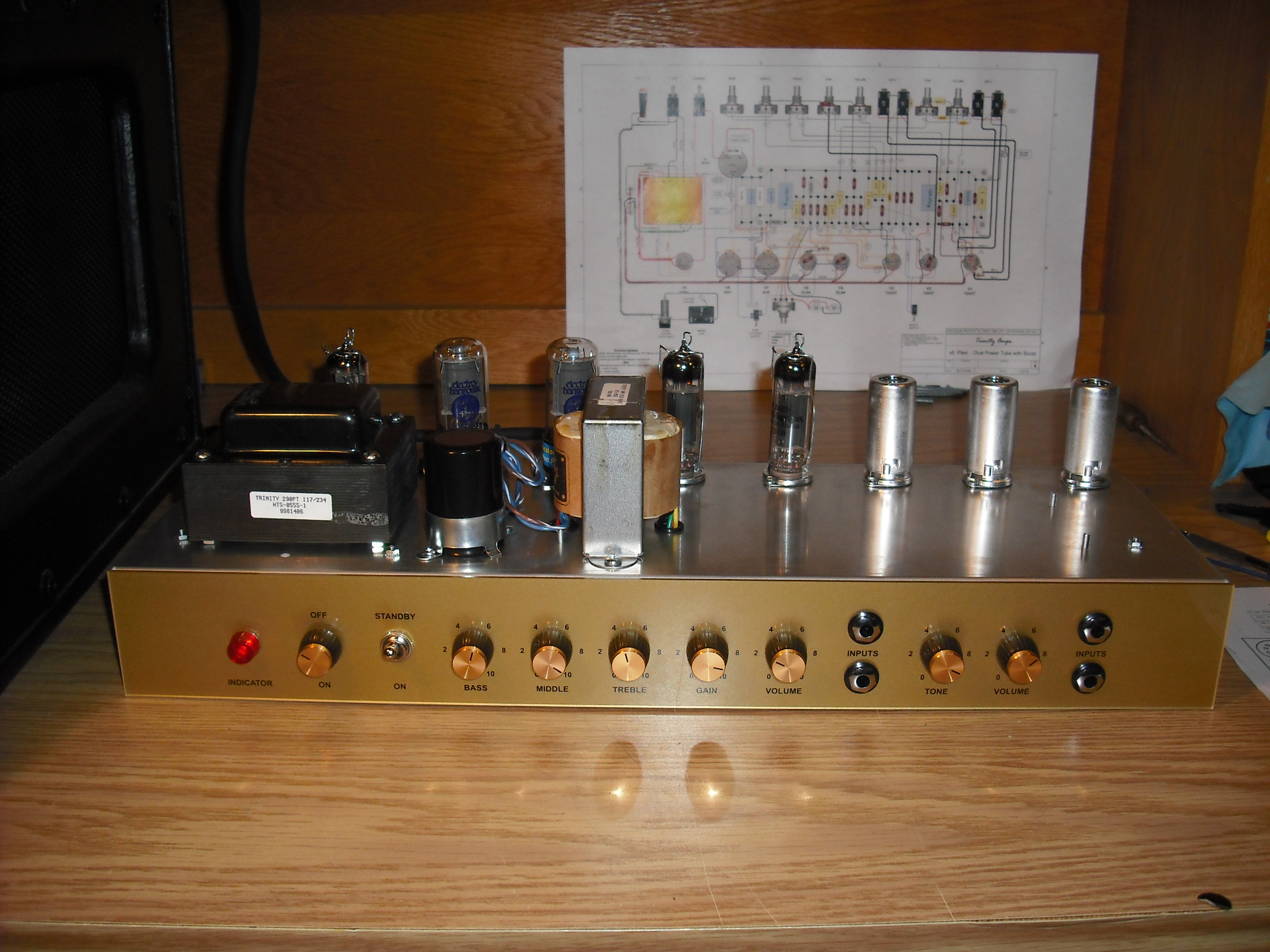

Tubes in ready for a voltage check.
Current state of the build.

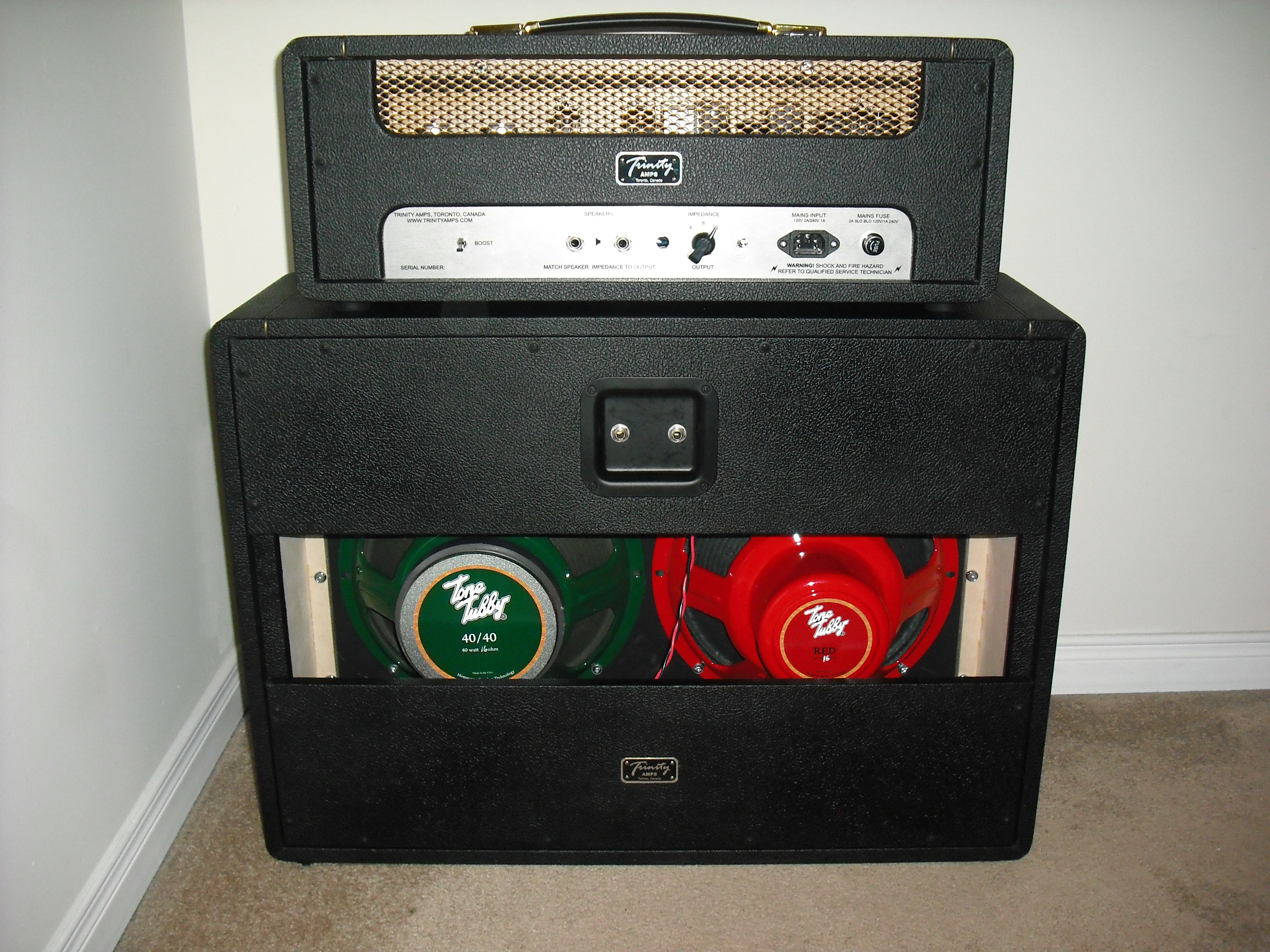

Head and Cabinet.
Back of the Head and Cabinet.
