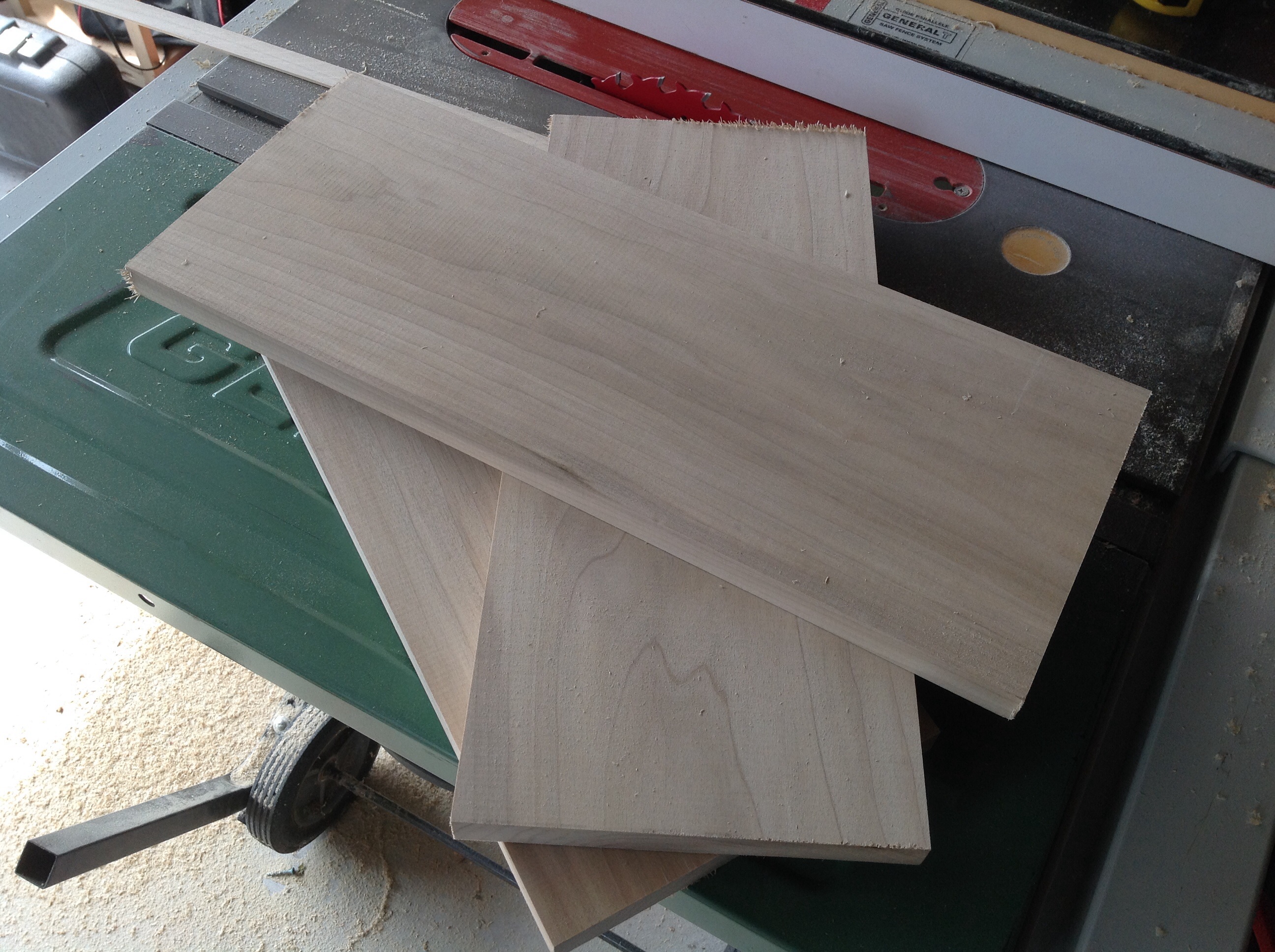

Decided to start on a cab while waiting on Canada Post to deliver my kit.
My initial plan was a cherry cab but I had this flawless poplar board and thought I'd make use of it.
I have added 1/2 inch to the cab all around in order to avoid any issues with a 12" speaker fitting in there. The depth of the cab remains as the plans suggest.
Poplar is a very underrated wood. It sands beautifully and properly conditioned takes stains perfectly. I plan on going for the tweed look. Kinda looks like a pile of lumber right now.

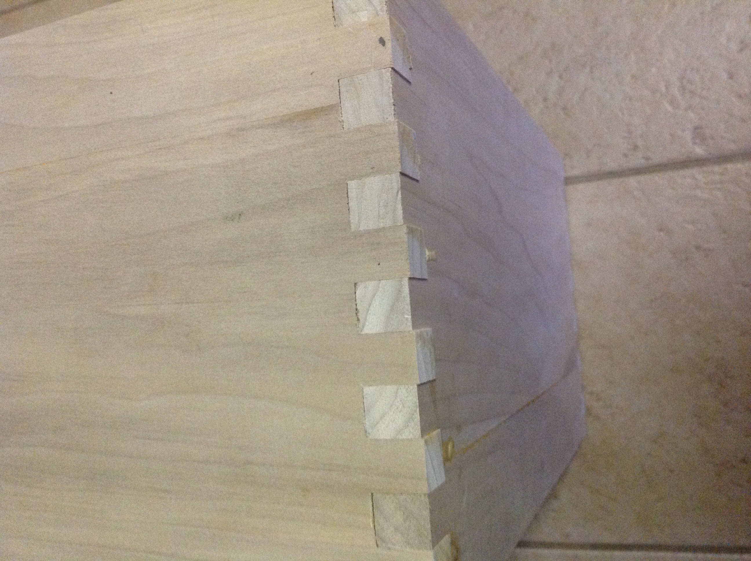

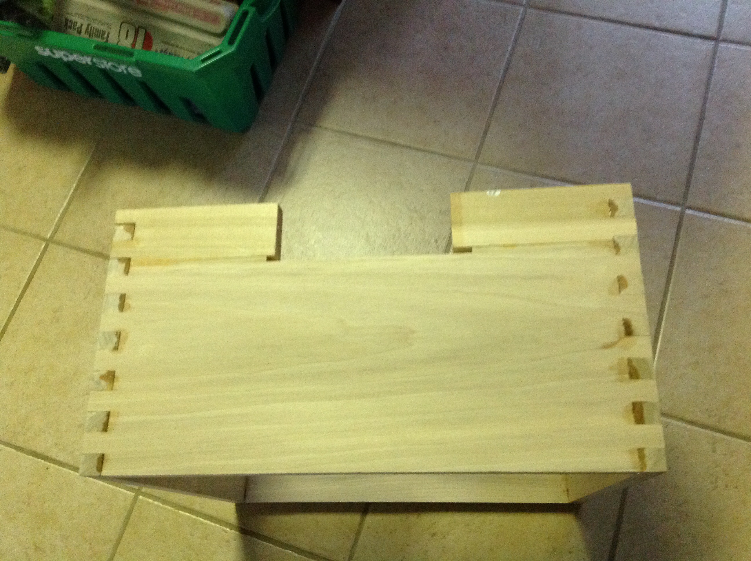

Got my cabinet together, the ibox jig is amazing!!
Pins were a bit tight with all the humidity but a little persuasion got'er done.
Just need to cut the control recess and taper the front. Bit of sanding and it will be ready for tolex. Seeing as this is for my daughter, I may get creative with the finishing. Haven't decided yet. I like the traditional look but she has more.... Modern?... Tastes.
