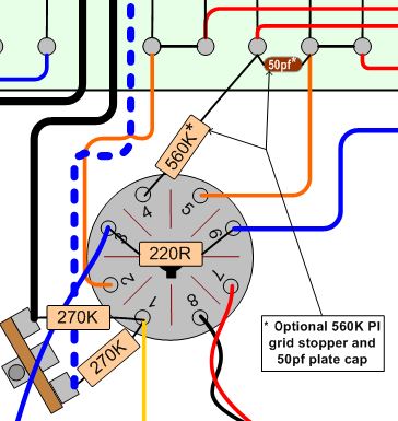

PHASE INVERTER
The Floating Paraphase Inverter design is used in many Ampeg amps. It is very rarely seen in guitar amplifiers, although Ampegs are an exception. It can be thought of as a cross between the long tailed pair and the paraphrase.
In some builds, the Phase inverter CAN introduce some oscillation based distortion. It could just be that the design is 50 years old, a little odd and quite uncommon. Anyway, we have a straightforward mod of two parts to prevent the PI issue. If you need the parts or we can mail them out to you. You may not even notice an issue!
I have tested on our amp and there is no effect on tone or response etc. It is quite transparent and I can see that the waveform of the signal is cleaner as a result.
METHOD: Add a 560K 1W grid stopper resistor to V3 pin 4 where there is a currently a solid wire from the board to pin 4 and also put a 50 pf cap from the .022uf cap (that now feeds that grid stopper) and the adjacent 510K that connects to the plate of V3 pin 5.
You may be able to use just the 50 pf cap, but the grid stopper is good design and primary defence against such problems.

1 560K PI grid resistor V3, pin 4
1 50p plate cap V3, pin 4-5 (or from .022uf to plate as in the picture)
