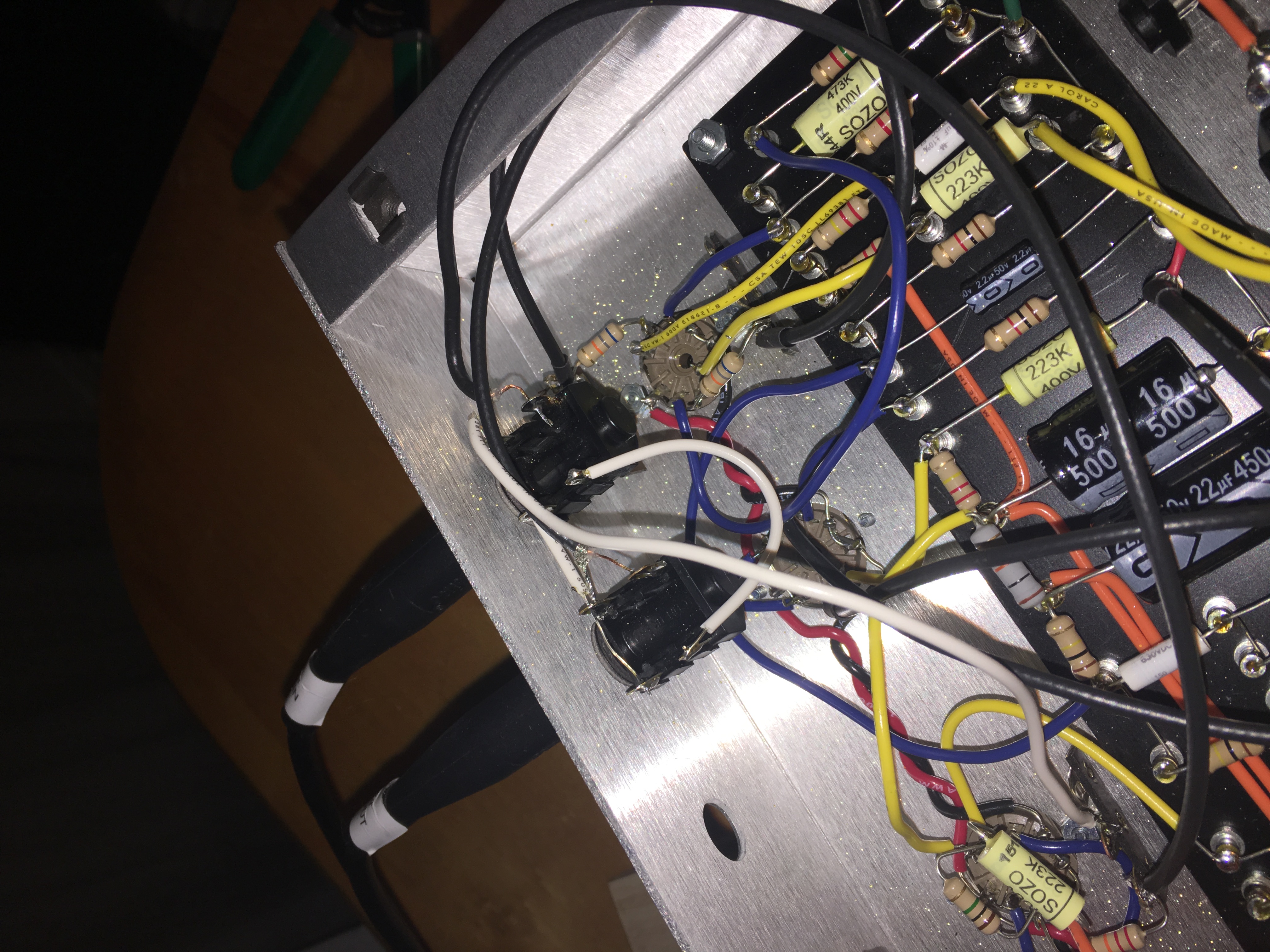

Just hooked the loop, From SEND to Master Volume middle pin and RETURN to terminal strip shared with R17 22K
but forgot to remove the existing wire from MV-pin2 to R17 on the terminal strip !!! Double feed CARNAGE!!! lol.
Now without the previous wire it's working like magic!!!
Thanks Stephen

I did drill 2 more holes just in case I wanted to upgrade for the OD footswitch... (once I'm done with my OD problems...)
