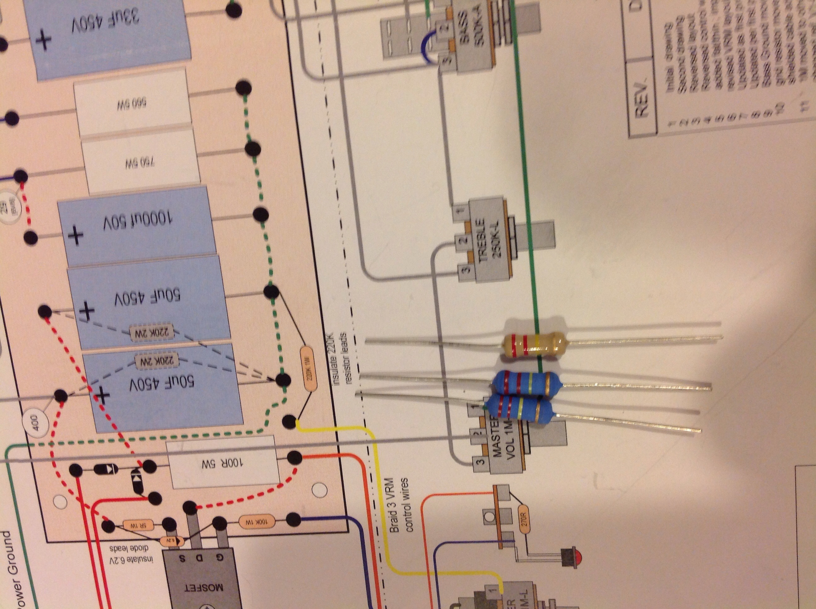

Both three measure 220kohm. How do I know which is the 2W vs. The 1W. Thanks

Hi Chris, the two Blue ones are Metal Oxide resistors (2W on my BOM list), it's been a while and the layout may have changed a bit but on my 2012 layout they are R19 and R26 bleed resistors to assist draining the caps at shutdown. The other is a Carbon film type. Here's where they all go (according to my layout and notes).
Hope that helps.
