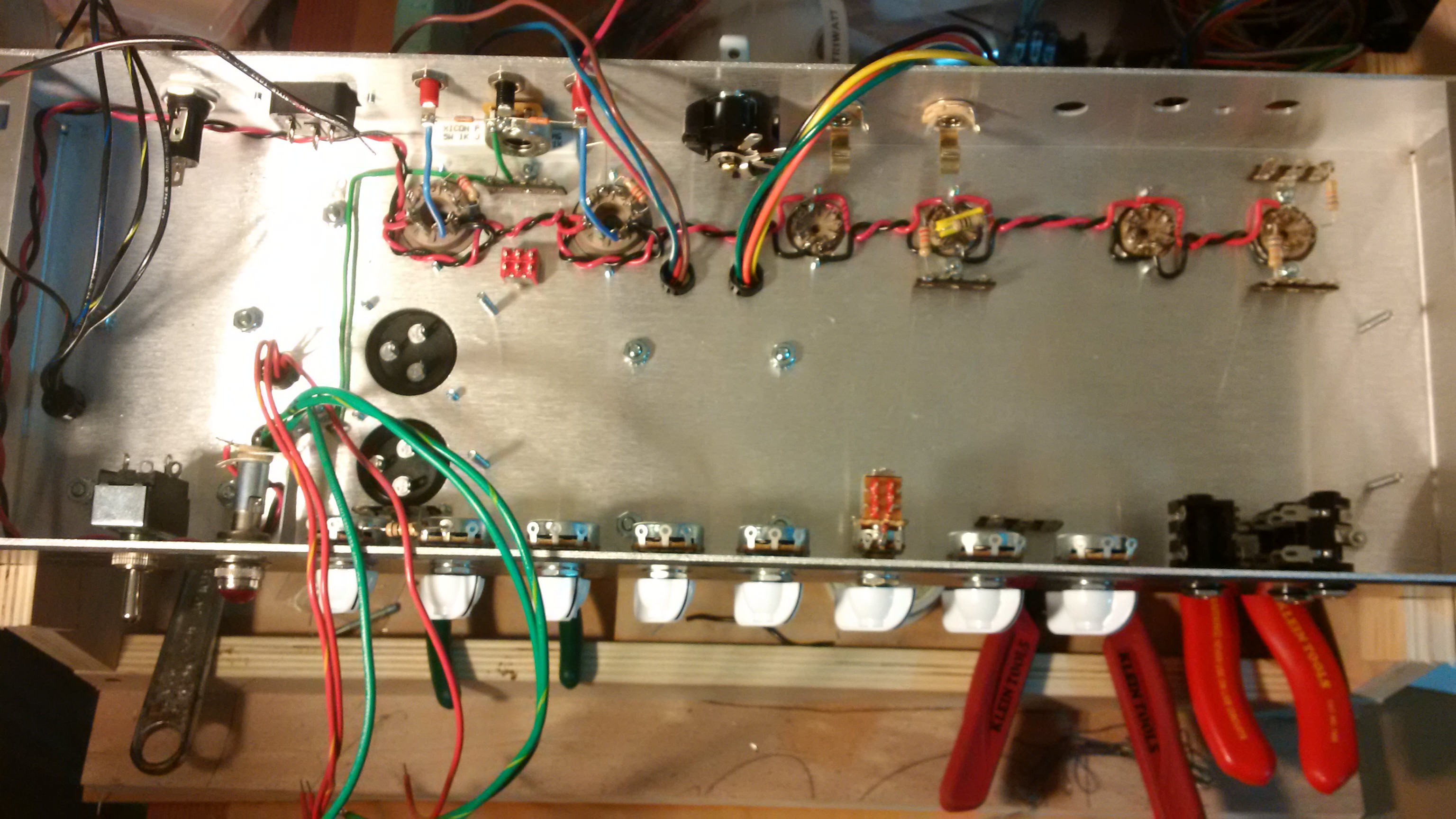

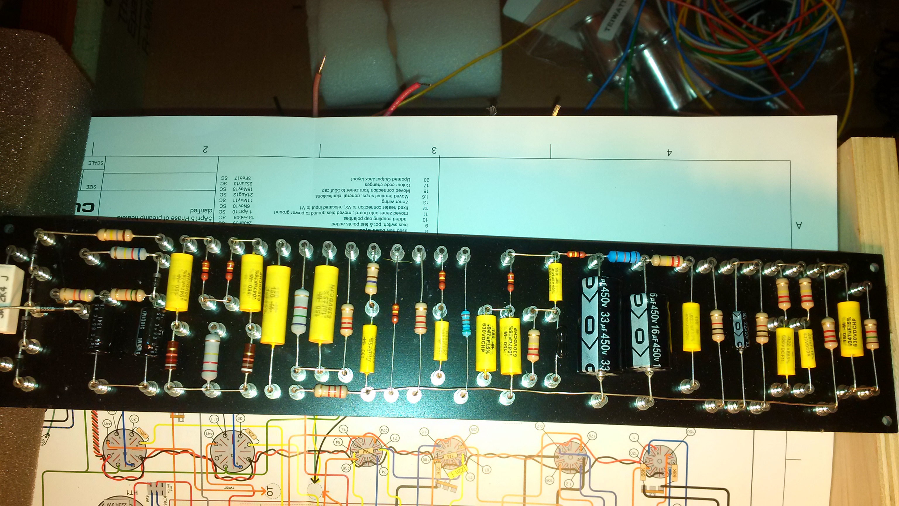

Some pics so far

 Post subject: Re: triwatt build
PostPosted: Sun May 13, 2018 9:02 am
Looks good so far. Didn't check the values on the board tho.
