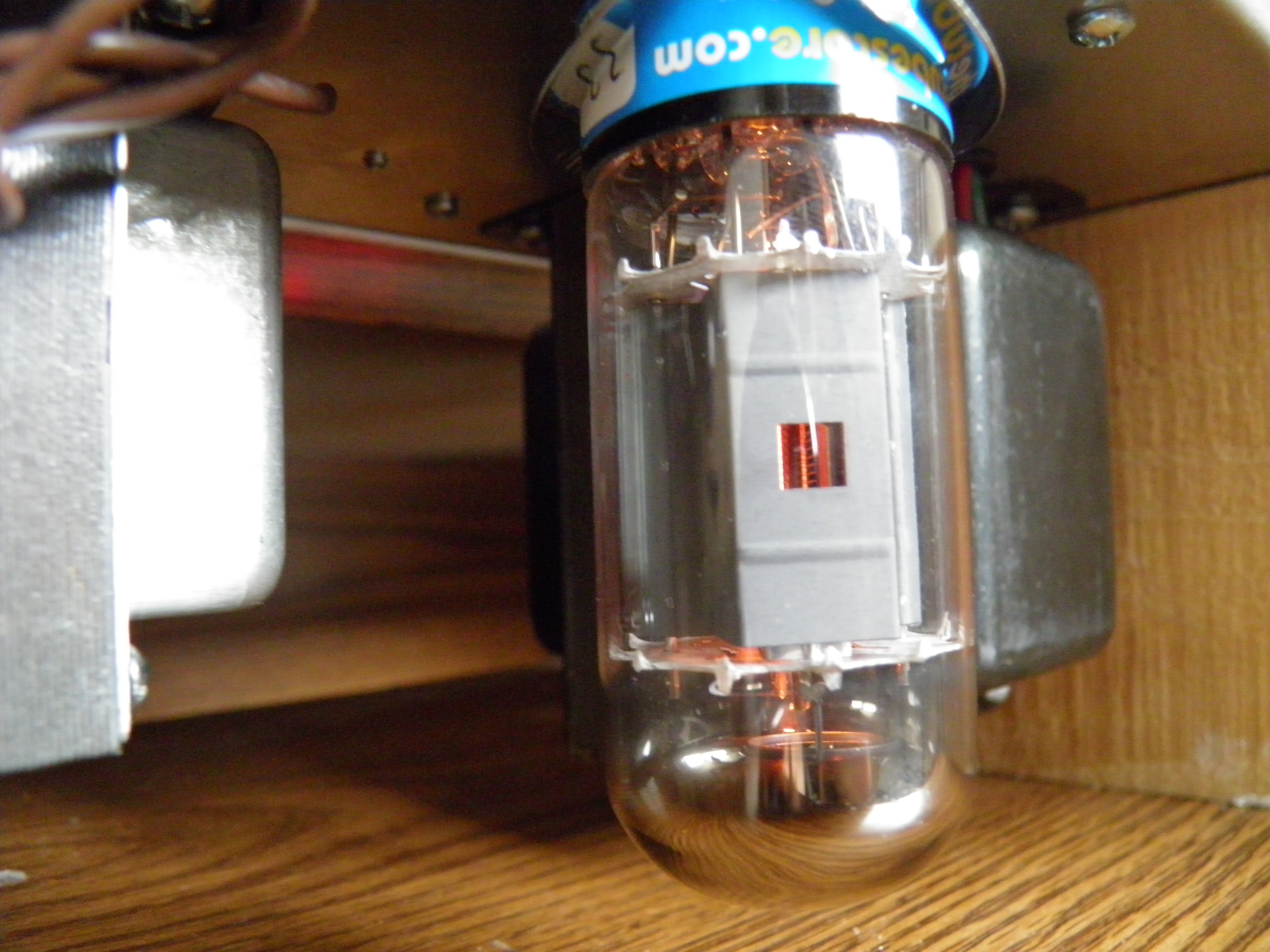

Just in case, I've attached a picture of the glow on the 6v6 which initially caught my eye and prompted me to recheck the filament voltage. In particular, it's the orange glow at the centre of the tube (the plate I think?) that concerns me. Does this seem a bit abnormal?

looks like the filaments to me.. I was worried about that once before, too.
but it's ok.
