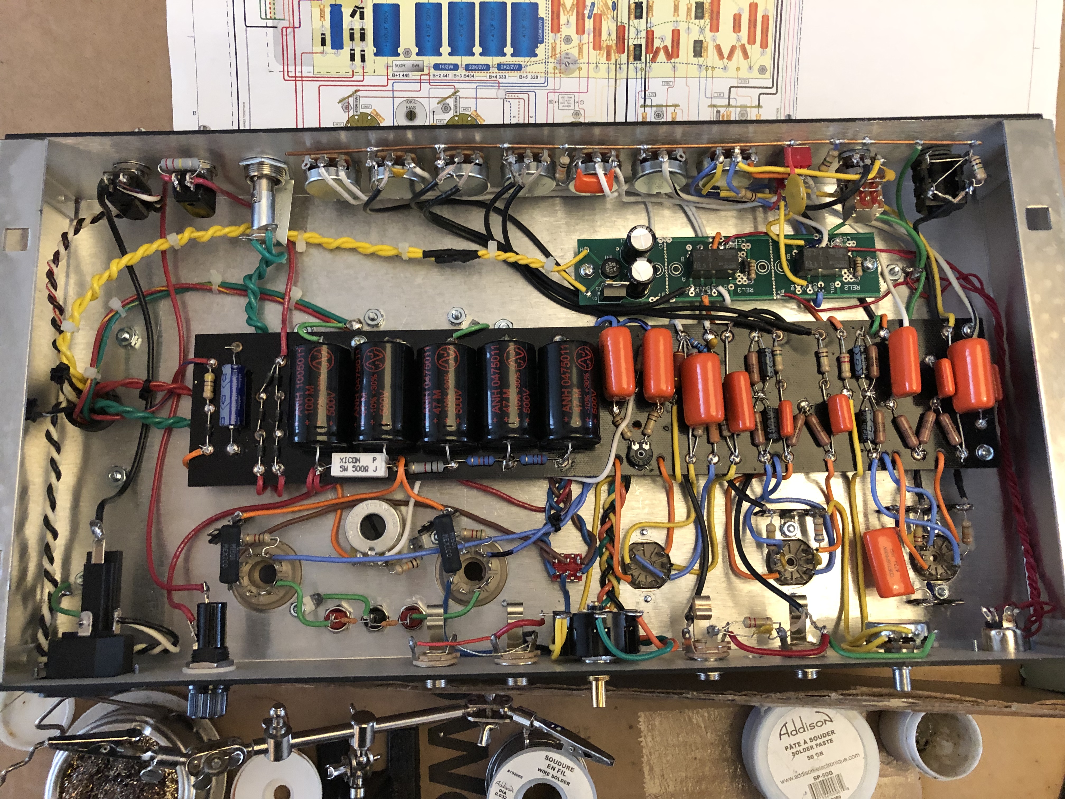

I’ve been moving very slowly though the kit. Here’s where I’ve ended up today. All done except for the heaters and the foot switch. So far so good (I think!). The only hiccup I ran into was that I found it difficult to complete the connections on the jazz/rock and mid boost toggle switches with components already mounted. I ended up stripping some off to get better access to the terminals then re connecting everything from the bottom up.

All done, now time to check it over.

It's alive!
Just finished checking the amp over and going through the voltage checks ect.
Everything seems to be ok. The amp fired up right away and sounds fantastic! Even through the test cab I used which is very dark and mid range heavy.
What a great feeling!
