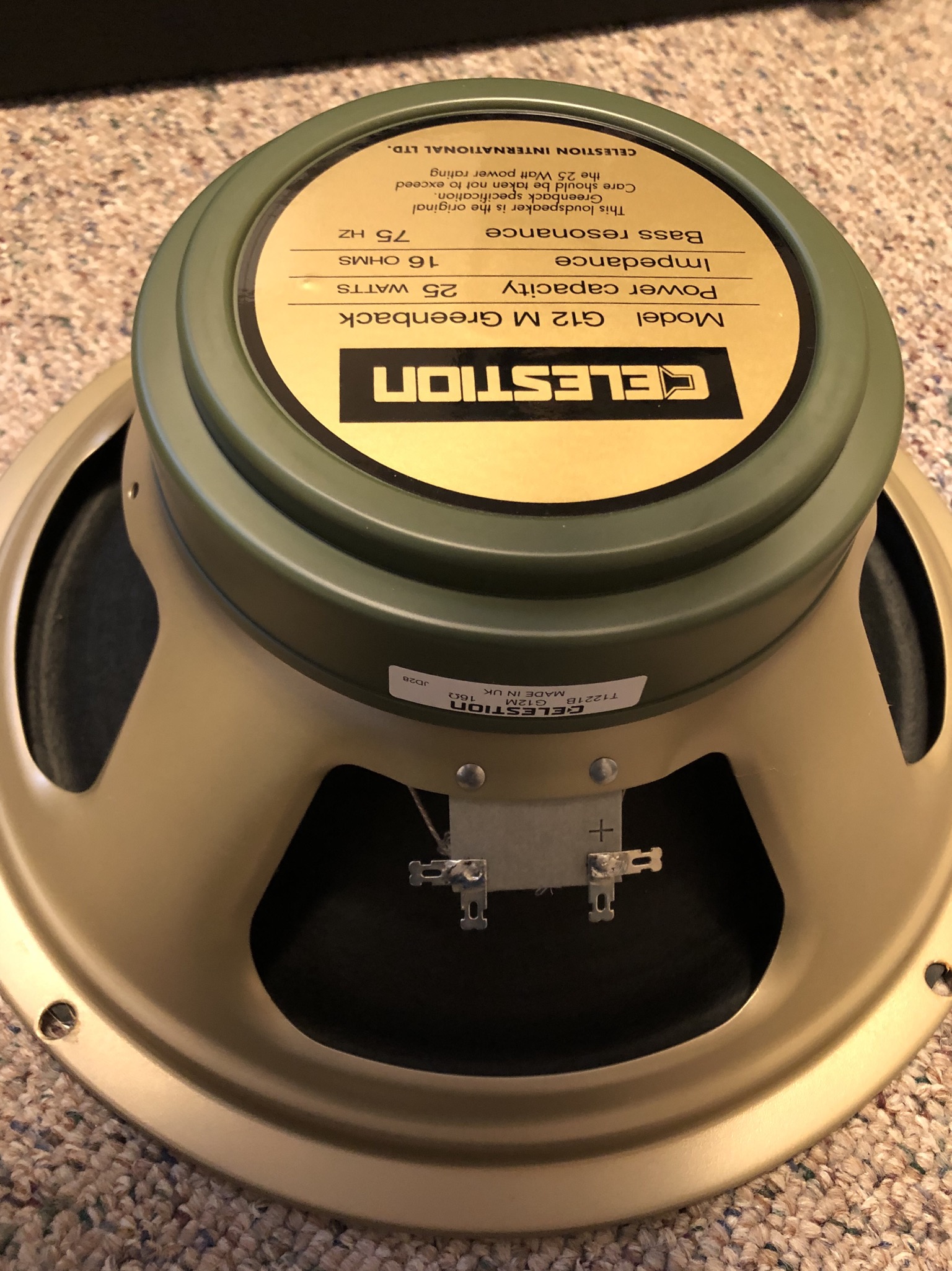

Posts: 91
Location: Ontario, Canada
I bought this one in January.

I just sent an email to zzounds asking if their current stock for the celestion g12m 25 watt is the Made in China or the Made in UK/England speaker. Waiting to hear back from them before I purchase. Thanks for the pictures.

PostPosted: Sat May 04, 2019 4:44 pm
Posts: 91
I’m in Canada. I bought it from https://qcomponents.ca/12-guitar-speakers.html
JD28 equals September 28, 2018.
https://celestion.com/speakerworld/guit ... _speaker?/
