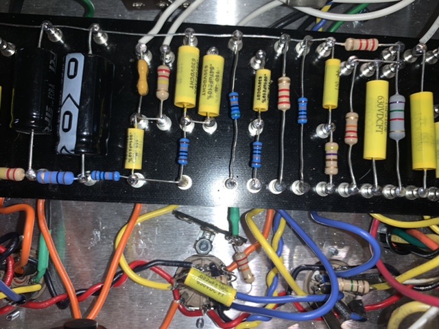

I just finished my build and I’m not getting the bias readings I should. I measure 4mv regardless of how I set the bias adjustment. I am also not getting any sound, hiss, or any kind of noise out.
I’ve checked connections, looked for shorts, tested continuity, I’m getting 350v from each side of the transformer, but after the first diode on each side the voltage is 146.
Any help or ideas would be greatly appreciated,
Thanks,
Kevin
PostPosted: Mon Oct 26, 2020 11:58 am
K, Are your voltages (VDC) on all the test points for tubes close to correct or all showing voltage w/o the tubes in? Are you measuring voltage after the diodes using VDC range on multimeter? Can you post gut shot pictures using the upload attachment feature? I will look on the schematic again (haven't find the B+ test point, yet). According to docs, B+ should be around 442VDC (higher w/o tubes), so should be around 221VDC on each side after the diodes if those are correct spots for B+ voltages (it's my understanding that Hiwatt circuits are considered to be somewhat different than "normal" guitar amp circuits). If Mitch or Coco chime in, they would probably be able to help more. Hank S.
PostPosted: Mon Oct 26, 2020 12:29 pm
Continued looking at your board photo and am wondering if you may have switched D5 (1N5355B) for D6 (1N4007)? The four diodes (D1-4; 1N4007's) should be feeding into D5 (1N5355B) in that 5 diode network near the right end of the board (looking at the layout). The lonely diode (D6) near the electrolytics a little farther up should be a 1N4007 diode. I really couldn't see the markings, but D6 looked fatter than the other 5.

Thanks for your help, yes I did swap the diodes. I would not have caught that. I can wire up a guitar and do residential wiring, but this is my first time building an amp.

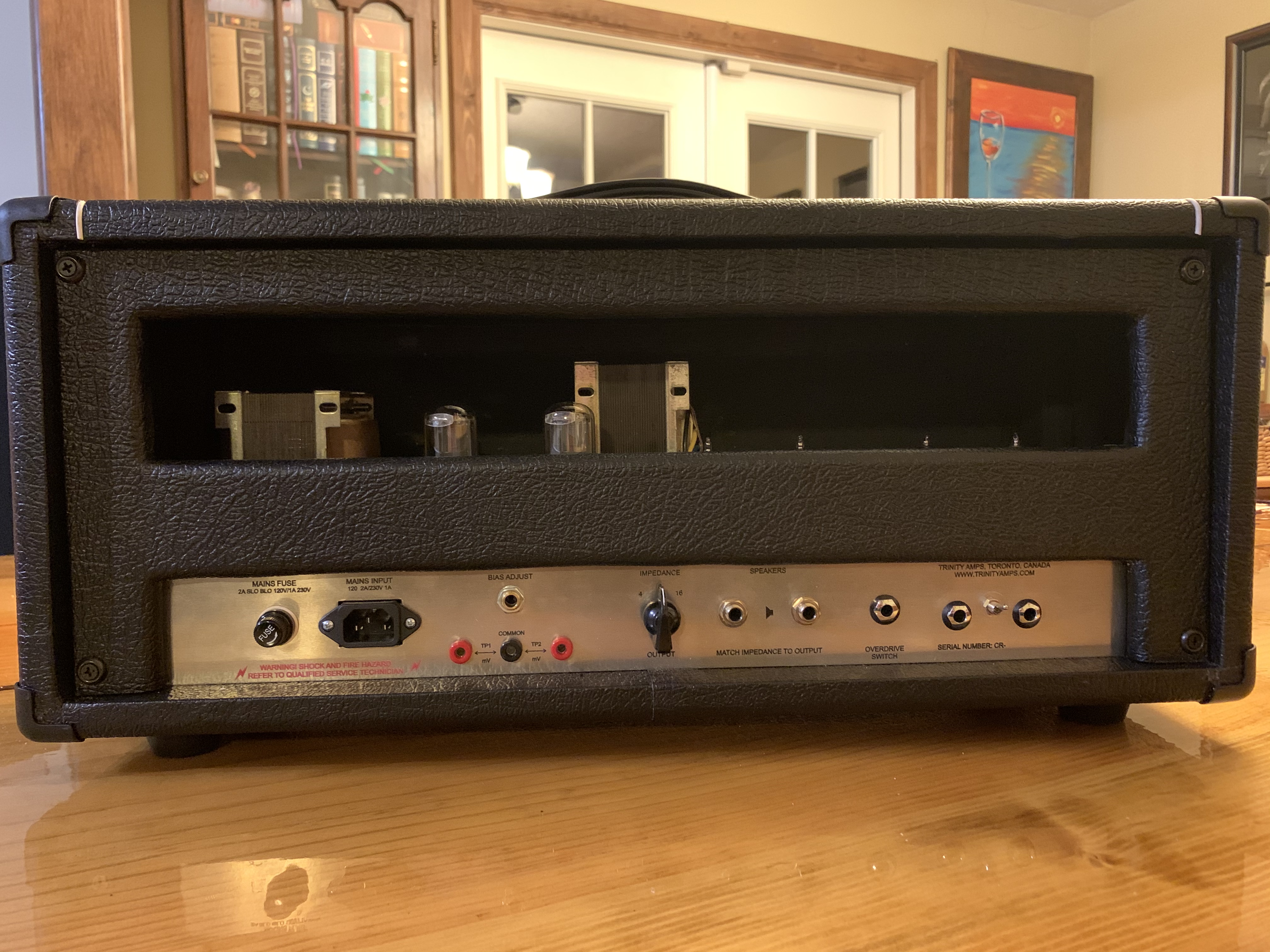

All done!
