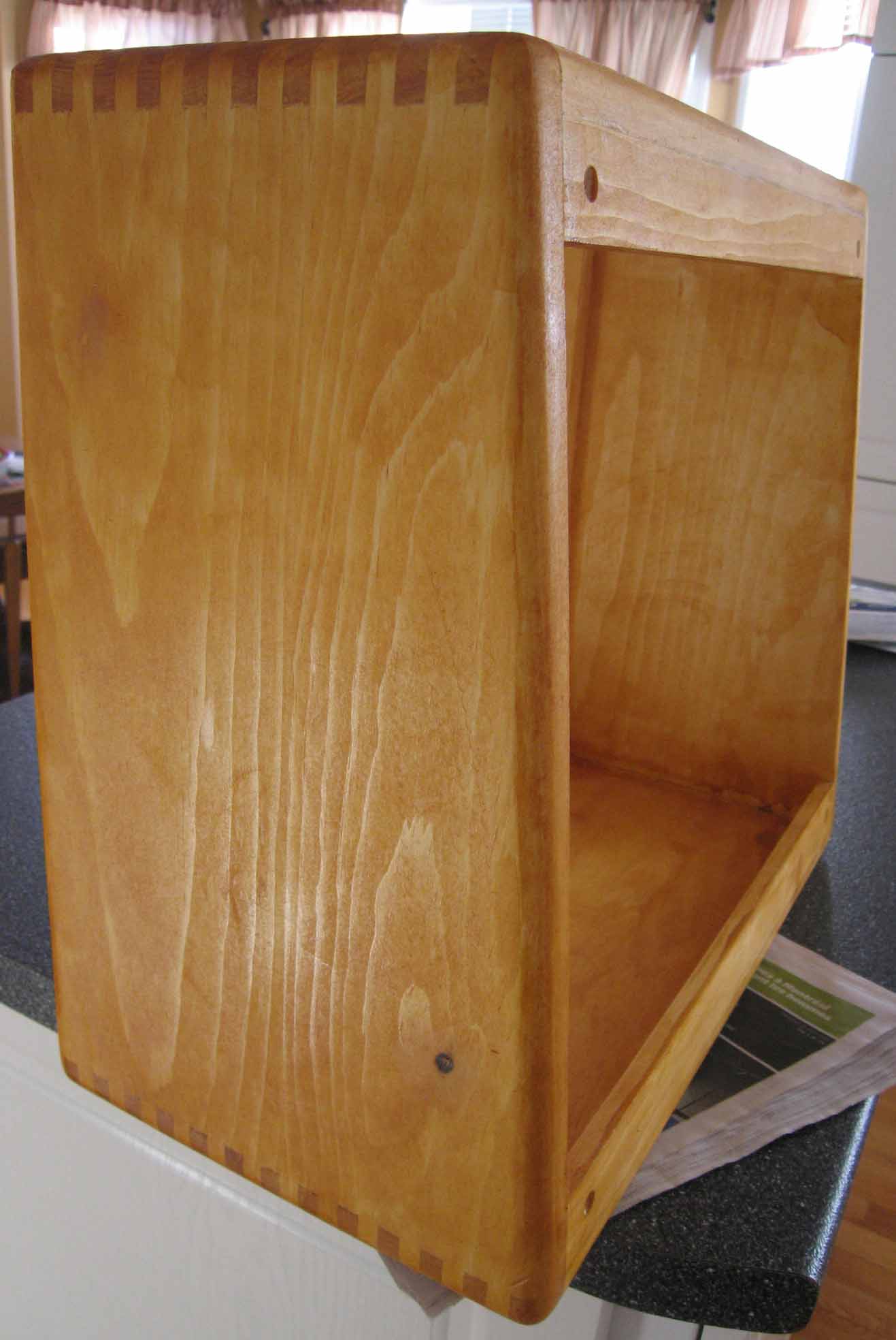

Some more progress on the cabinet. Sanded, corners router and 2 coats of shellac applied.
File comment: Round over on edges and sanded.
File comment: Two coats of shellac applied.

Great looking cabinet Dave.
I envy your woodworking skills. My unfinished cabinet comes from Trinity Amps.
I plan to use shellac like you. Could you tell me what make of shellac you used and is it clear or amber?
I see you have applied two coats. How many do you plan to apply?

I used dewaxed super blonde shellac flakes in a 2 pound cut. I only put two coats of shellac on in total. I am in the process of applying Minwax Wipe-On Poly in Clear Satin now. Three coats of poly have been applied now,will do a few more, will post a pic as soon as I am finished with the poly.

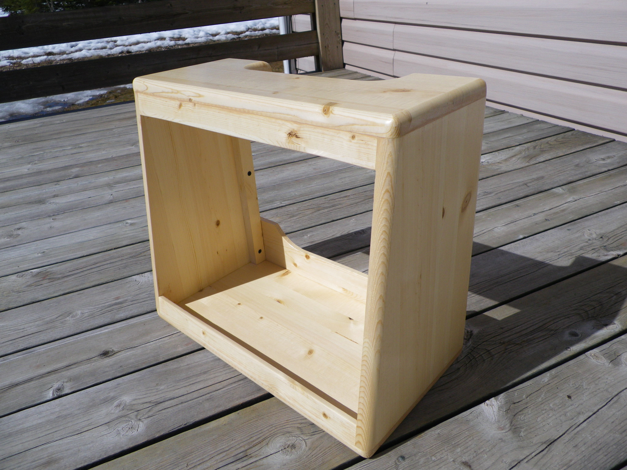

Cabinet with 5 coats of satin wipe-on poly. Only thing left is to get feet and a handle for it. Will do the speaker baffle once I decide on what speaker I am going to use.

Real nice finish.
I like being able to see the beauty of natural wood through the finish. Hope mine will turn out looking as good as yours.

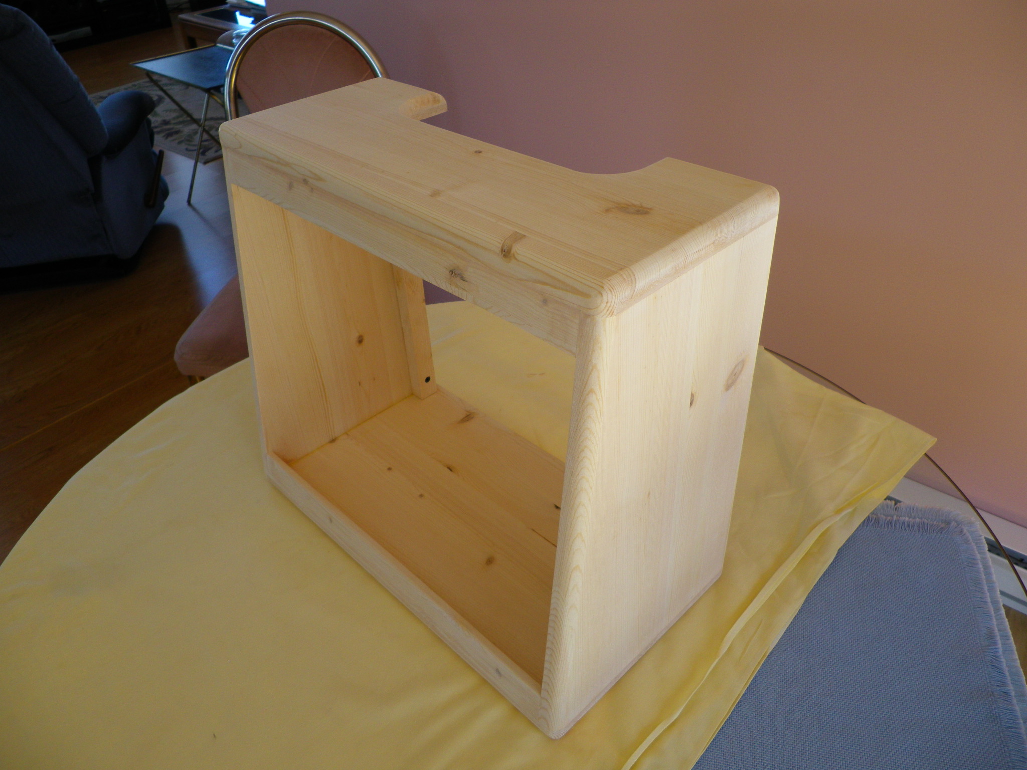

Applied two coats of amber shellac to my cabinet today.
The result is similar to yours, only a little darker. I think two coats are enough.

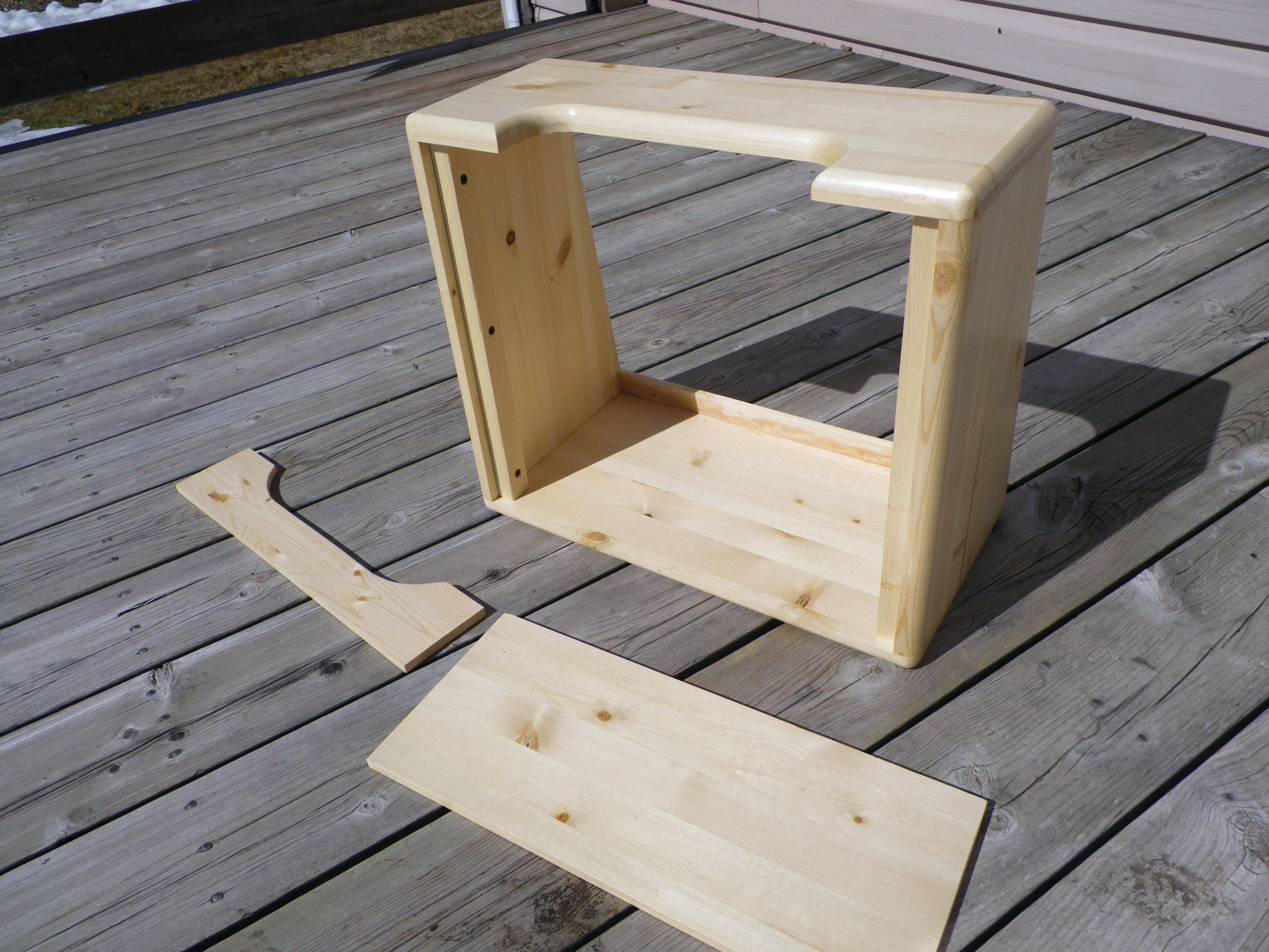

Here are three pics.
I hope they will appear. It's my first post with pics.
As I mentioned before, the unfinished cabinet comes from Trinity Amps
Edited: thank you for your help with the pictures.
