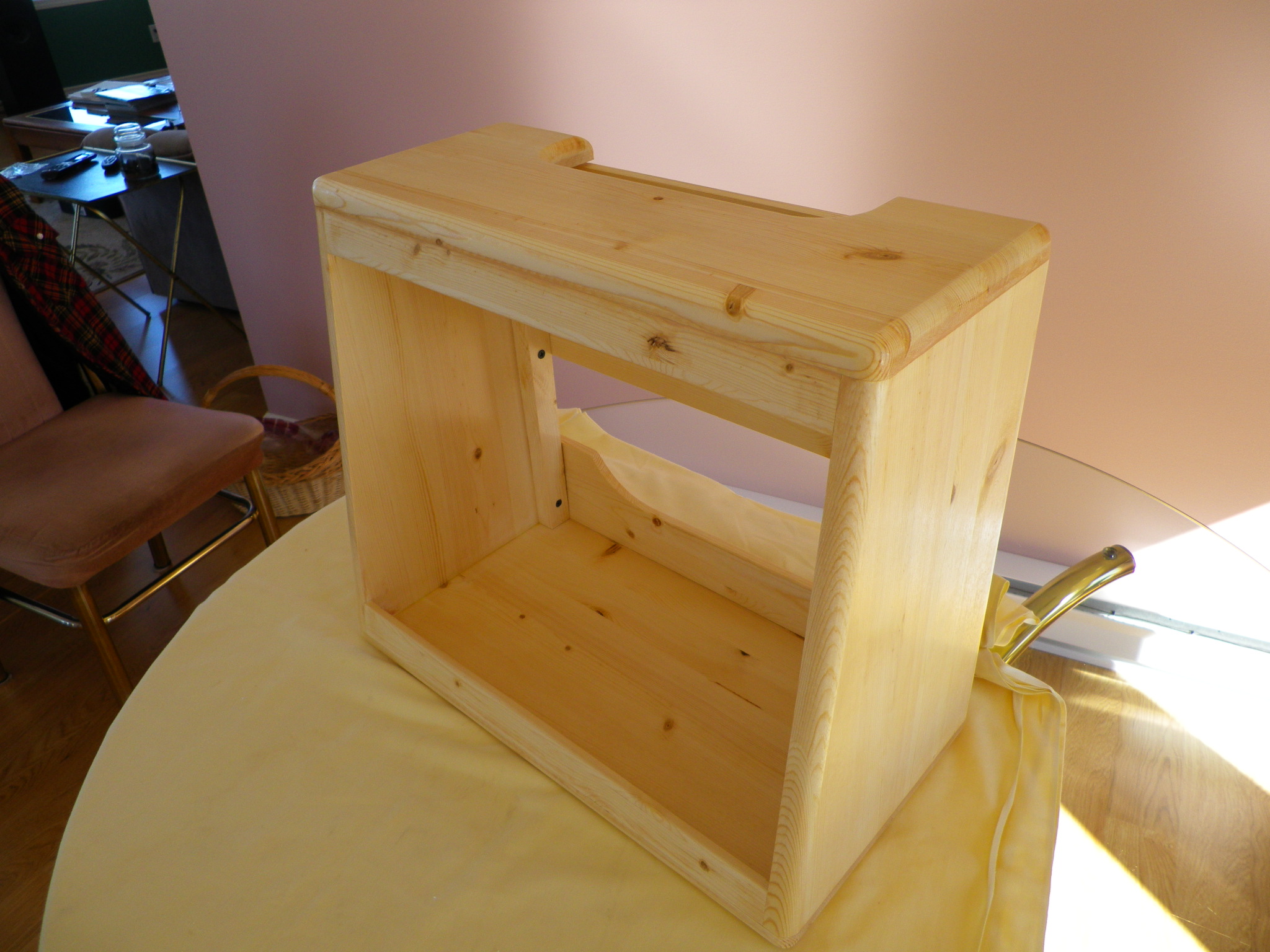

While waiting for Stephen to get more Tramp kits in stock, I started to build the Tramp cabinet.Will post some pics as I progress. What is everyone using for the speaker baffle, 1/4 " plywood?

Some more progress on the cabinet. Sanded, corners router and 2 coats of shellac applied.
File comment: Round over on edges and sanded.
File comment: Two coats of shellac applied.

Cabinet with 5 coats of satin wipe-on poly. Only thing left is to get feet and a handle for it. Will do the speaker baffle once I decide on what speaker I am going to use.

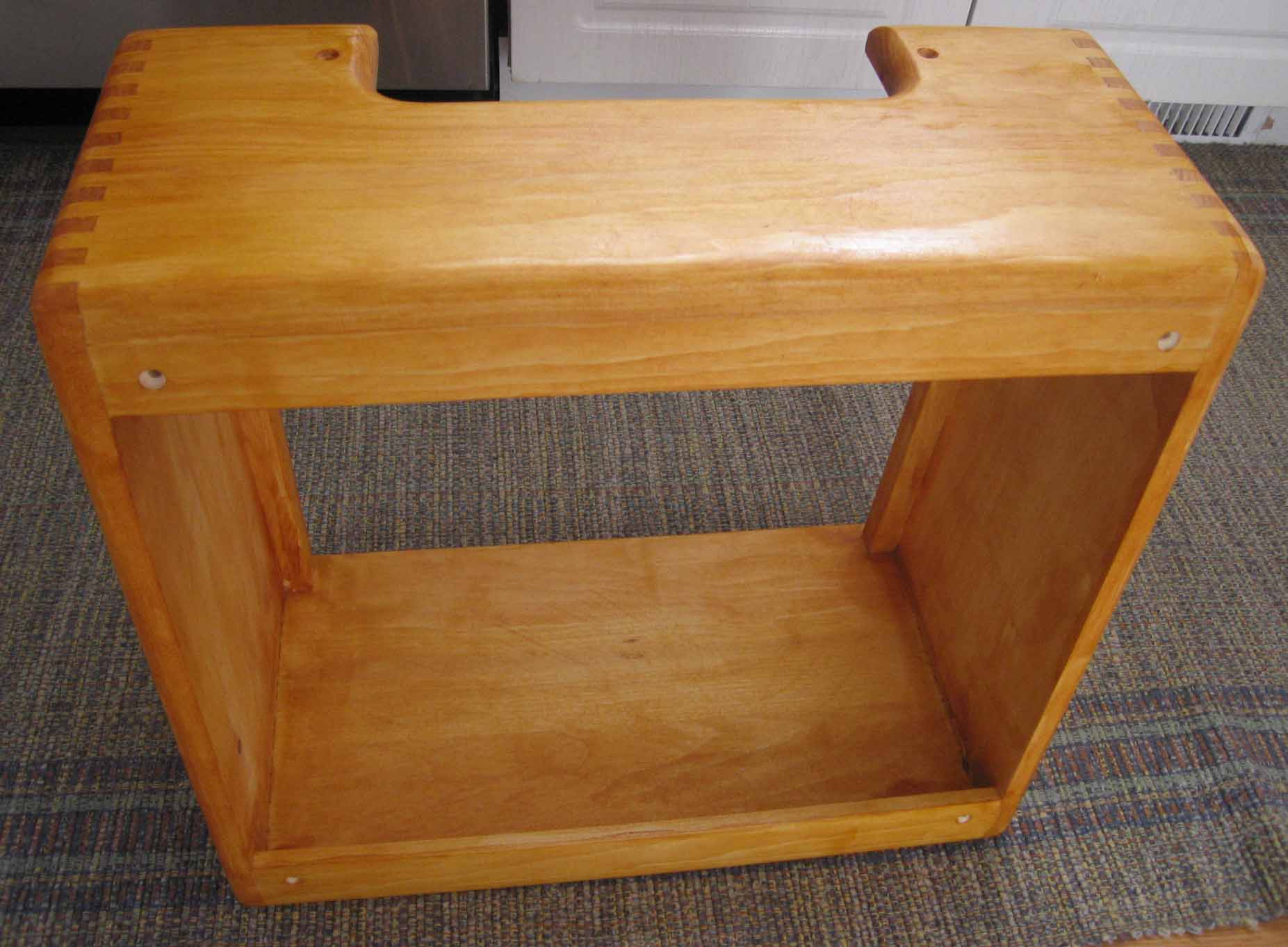

Applied two coats of amber shellac to my cabinet today.
The result is similar to yours, only a little darker. I think two coats are enough.

Here are three pics.
I hope they will appear. It's my first post with pics.
As I mentioned before, the unfinished cabinet comes from Trinity Amps
Edited: thank you for your help with the pictures.

Looks good. :) What do you plan to put on over the shellac?

Cool colour.
What grill cloth are you pairing it with?
PostPosted: Sun Apr 10, 2011 1:00 pm
Posts: 59
Cool colour.
I will receive shortly a piece of Fender Aged Blue White Silver Grill Cloth. This is what I plan to use for the moment although I must say I hesitated before buying it on eBay. I was tempted for a while by the Aged Blue White cloth and also by the Fender Beige cloth. Do you have suggestions?
I already have the Black Grill Cloth that comes with the Tramp kit but I don't think I will use it.
As for the finish, I would like to leave the cabinet as is without a clear coat on the shellac. Pockmarks and scratches would only add character to it I figure and, anyway, a new shellac coat is easy to apply.
On the other hand, a friend has pointed out to me that it would be better to put a varnish on it because, in his opinion, shellac is rather fragile. Dave, who started this thread has opted to put a protecting coat on his cabinet so it seems like a good thing to do.
Thanks for your interest. This is a first time guitar amp build for me (only have build two Dynaco products ages ago) and I am pretty excited by this project. I also find it interesting to get info and share ideas on this forum.

Those are both two very fine examples of great looking craftsmanship. I like both of the natural finishes, but i usually use Bullseye Amber for this kind of thing to bring out the woods grain.
Since these are natural cabinets, in my opinion a grille cloth with more "Earthy" colors might look better like the Fender BrownFace grilles, Oxblood or Wheat. Or they would both would look cool (again...my opinion) with woven Cane, (wicker) grilles.
PostPosted: Mon Apr 11, 2011 3:11 pm
+1 on the oxblood grille cloth. Love the vintage vibe with that stuff. Stephen build a flame maple Deluxe cab for me using that & it looked fantastic. Damn nice on my blonde Deluxe Reverb cab too...
SG + Brit tube head = Nirvana
PostPosted: Mon Apr 11, 2011 4:09 pm
Posts: 264
Location: Thompson, Mb
Yes and no to the fragile part. Put alchol on it and it will soften and leave rings or other marks. Clean it well and re apply shellac and it will become part of the original and can be sanded without leaving witness marks.
It is best for your application to use wipe on poly in either satin, gloss or a mix of the two. I put 25% satin in the gloss, hides the fingerprints and is a nice semi gloss.
Beer bottles and drink glasses have no effect on it. :)
