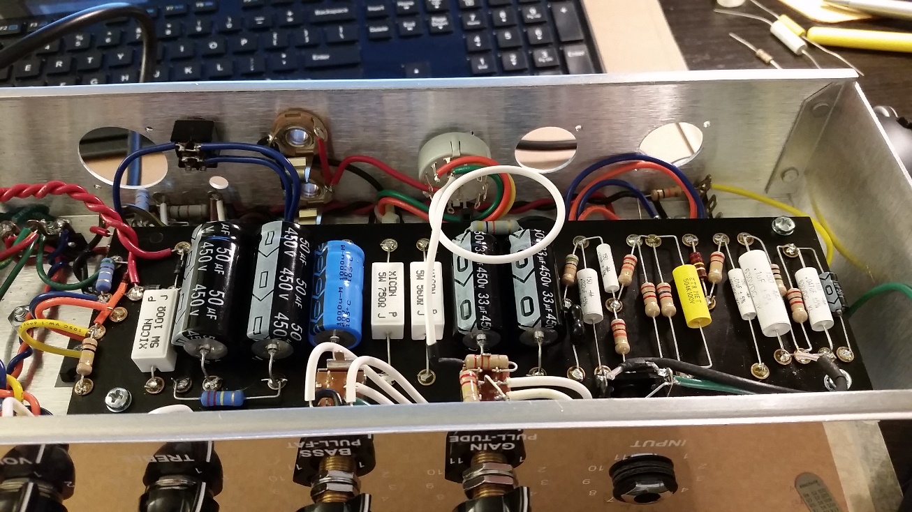

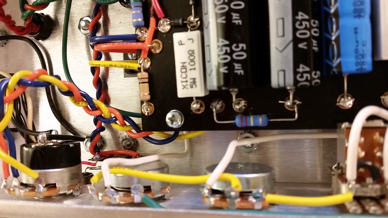

Hi all, Just finished my first build. Will check it over again in the morning before firing (hopefully no pun) it up. I've posted some pictures below if anyone would be kind enough to give it a once over with a different set of eyes. Note, the 220k across the 50u filter caps are on the underside.Thanks,
Mike

Having just finished mine, I feel a special kinship here:
You did such a phenomenal wiring job that I don't believe you it's your first ;)
I did take a hard look and I honestly can't see any errors assuming you've checked all the flying leads below board.
Good luck! It's a great sounding amp.

Looks good from a quick scan. Might want to shorten that loopy NFB wire though.

:thumbsup:
Looks good from here too.

I will probably shorten the NFB wire. I left it long because I was considering swapping it for a different white wire that was shorter than I had liked to make it look neat (my OCD). I'll let you know how it goes. Thanks for looking!
