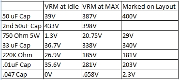

PostPosted: Mon Mar 07, 2011 9:16 pm
Posts: 67
I did some more checking. Nothing jumps out at me.
I re-soldered a couple of connections - but no change.
I measured these voltages at the pints indicated by the layout.
(I tried to relate them to the schematic and didn't get passed B+)
I have some monster-sized pics uploading to photobucket right now.
I'll post a link when they're up.
edit: here's the link
http://s135.photobucket.com/albums/q138 ... 11/AmpFix/
I have more, but I'm done for the night.

PostPosted: Wed Mar 09, 2011 10:29 pm
The switch toggle is opposite to what the connections are. The centre ones are common and you want the two ressitors to be connected in the 6L6 position. So you can work it out from that or measure the cathode resistor value in both positions. Across the 750 it should read 750 in the 6V6 setting and less for the 6L6 setting. If the cathode voltage is around 29 it's in the right position.
We eally should have labelled those. :x
.648V on the cathode is way too low. That tube is hardly working. Resolder the parts in that chain. Check the resistor value on that cathode. Also, 200 vs 283 is suspect on that plate so check the resistor values that feed that voltage because the other plate voltage appears close.
