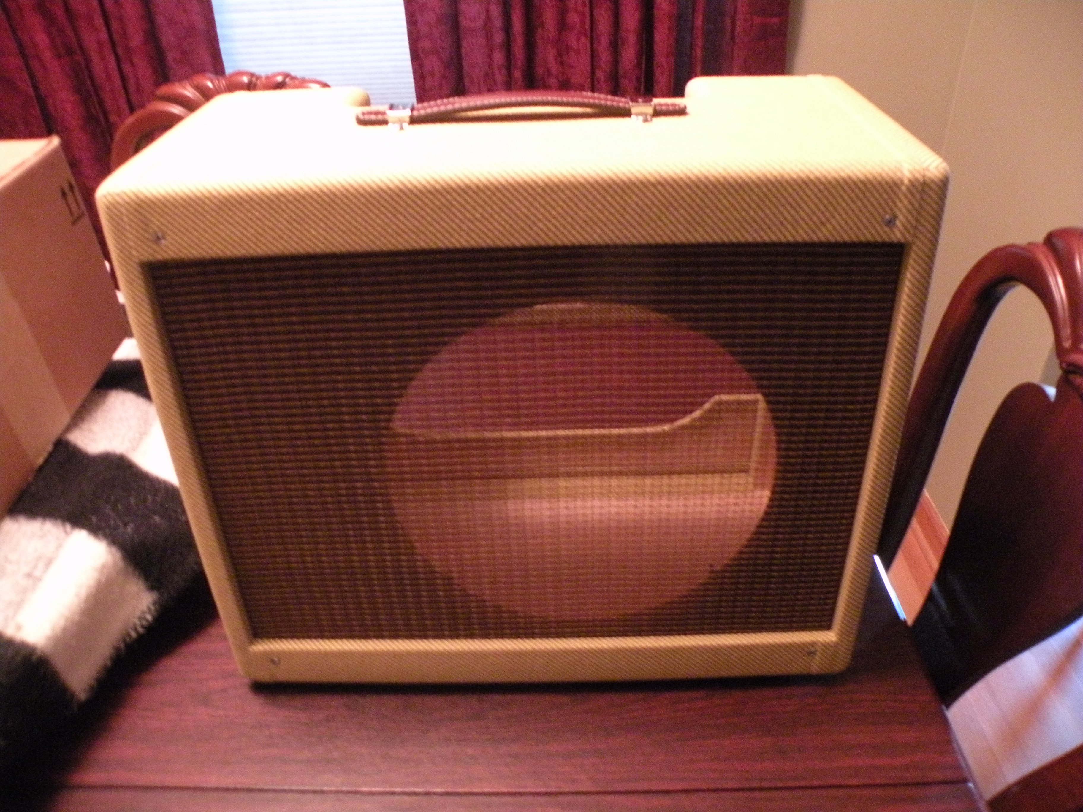

Cabinet arrived today. It is exactly as ordered. The chassis opening is 10x2.5 [10x2.75 including backpanel offset]. I put the chassis panel in to see if it fit and there is no cabinet overlap and perhaps less than a hair gap; so for those building their on cabs I would reduce the chassis opening by about 3/32 for a slight cabinet overlap; still I am very pleased The speaker opening was moved to the right for Tramp design & to fit a KT88 and Blue Dog down the road. Here are two pictures.

The cab looks great. There's actually a lot of leeway/tolerance on the panel for knob throw and clearance of the LED to allow a lot of overlap so the chassis can slide under quite a ways before any "interference" with knobs/LED etc, becomes a problem. Even if you didn't allow the extra .25" for the panel I think you would have been fine.
