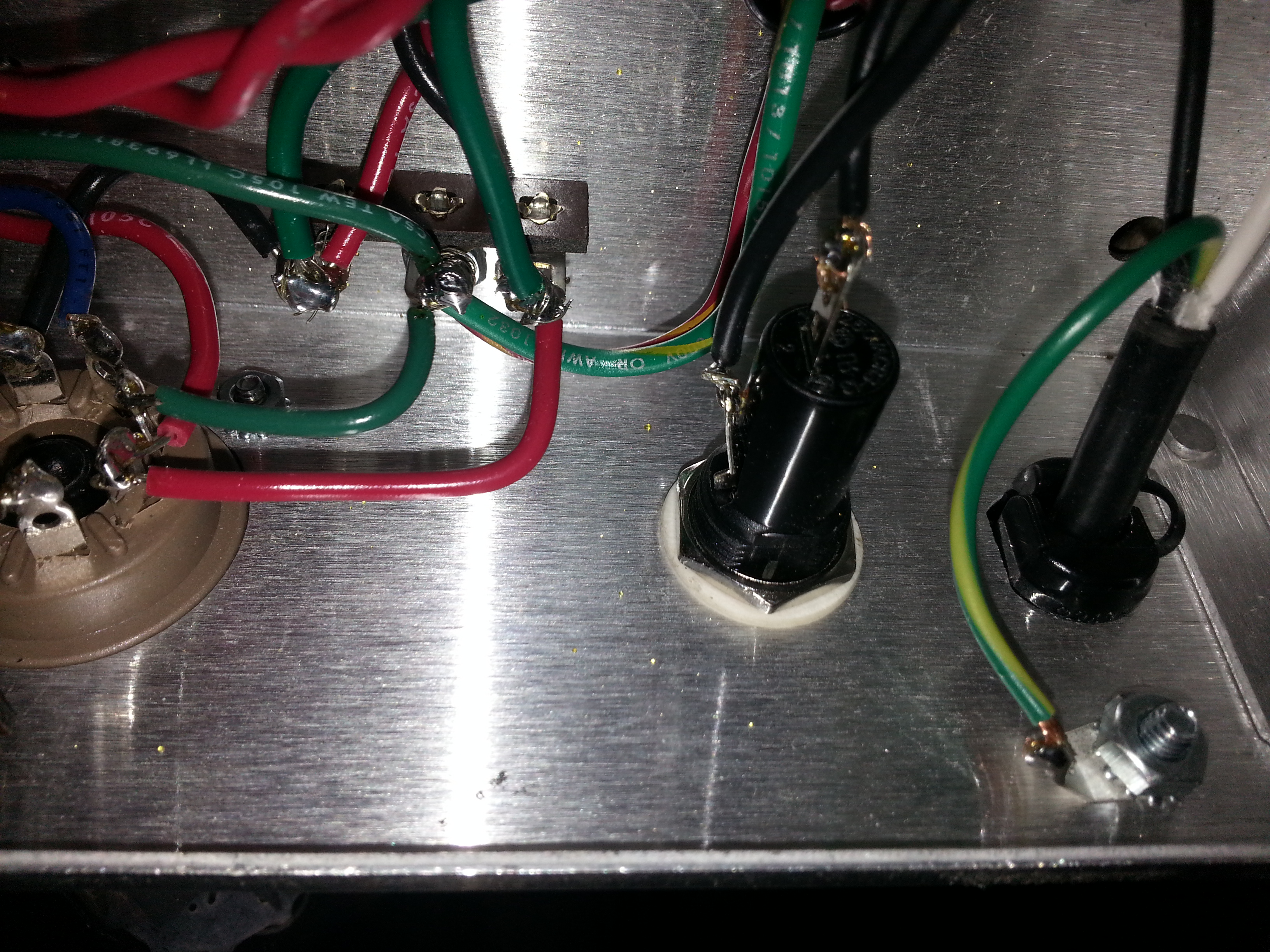

PostPosted: Mon Aug 31, 2015 8:31 pm
Can you post a good picture of your power side wiring?
PostPosted: Mon Aug 31, 2015 10:03 pm
Posts: 41
Thanks for taking a look Stephen.
PostPosted: Mon Aug 31, 2015 10:33 pm
in picture 3, showing the connections to the power switch, is there 124V between the switch terminal and the 3-lug terminal strip? there should be.
PostPosted: Tue Sep 01, 2015 6:00 pm
Posts: 41
Yes, it's 124V from the switch terminal to the 3-lug strip.
PostPosted: Tue Sep 01, 2015 8:24 pm
And what is coming out is half what was expected. If you are getting only half of the expected voltage out, It seems like the Wires to the transformer are labelled wrong. From the picture you posted, they look correctly connected according to the wiring diagram and layout.
