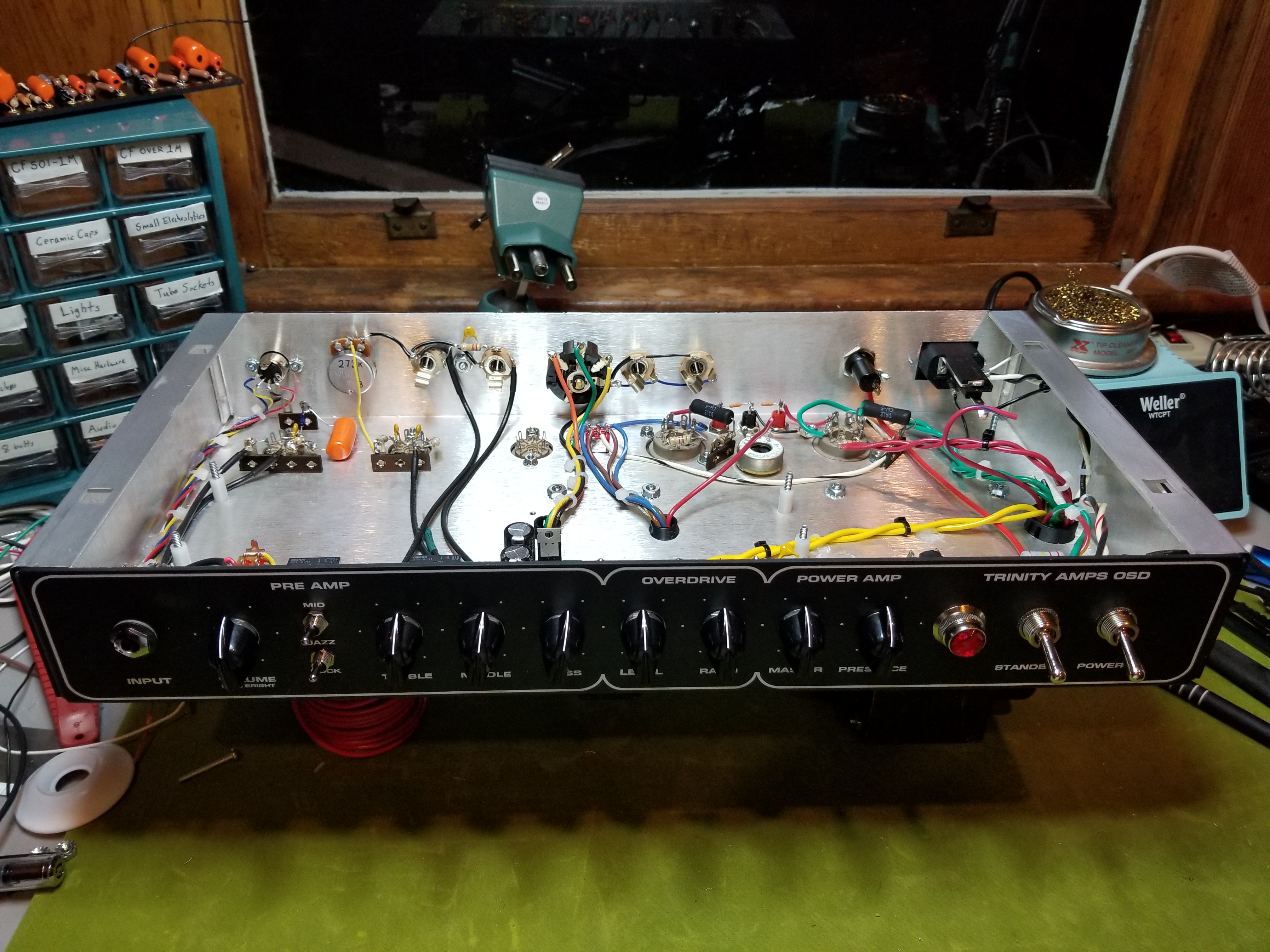

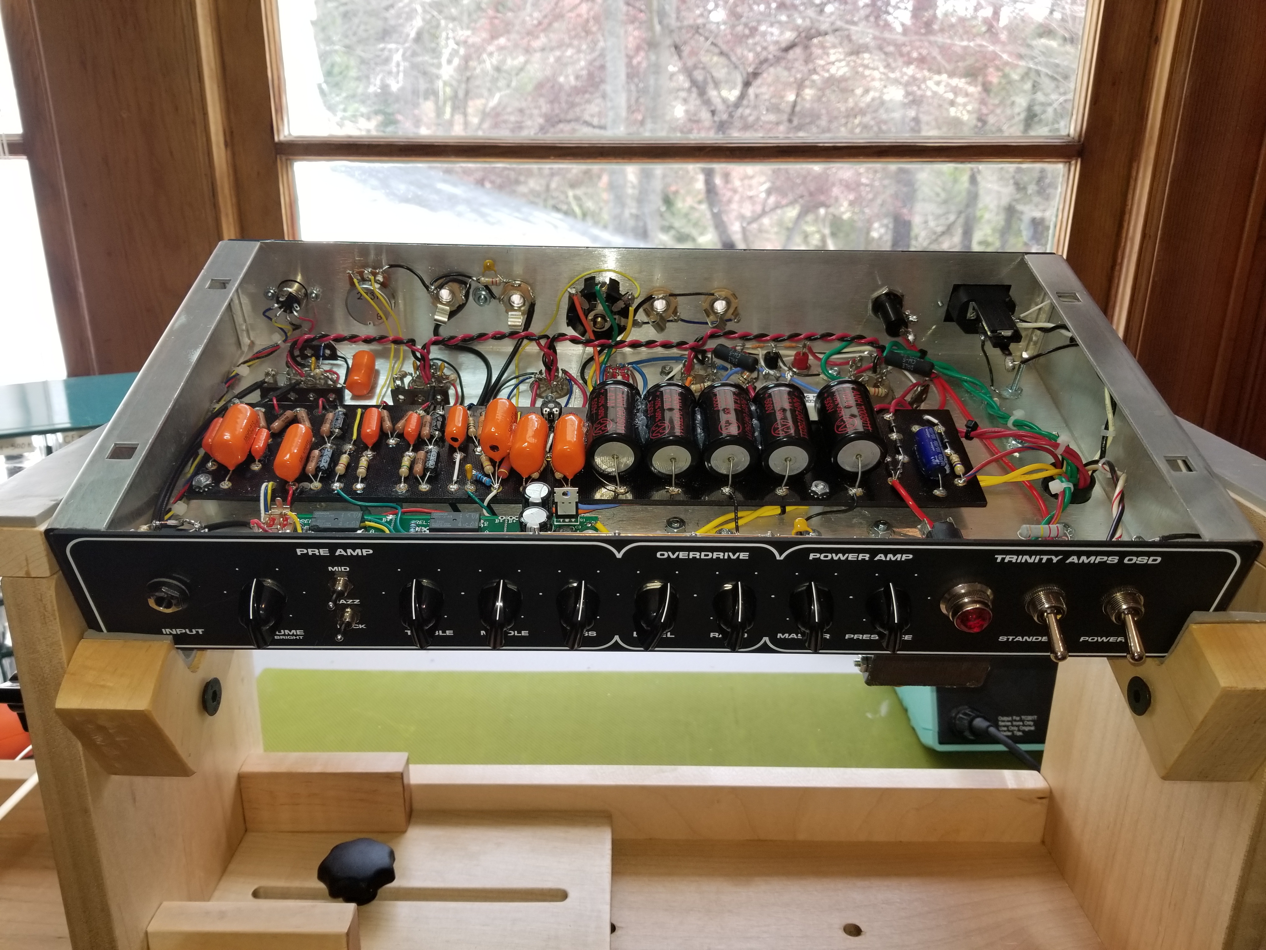

Hey everyone!
New member to the forum here. I thought I would post pictures of my OSD build as it goes along. I've long loved the tone of Dumble style amps, and I've made some attempts at Overdrive Special style builds in the past. I bit off a little bit more than I could chew at the time though, so I wasn't really satisfied with the results. I've built some Champs, 18 watters, and Trainwreck stuff since then, so it has given me some much needed time to work on my amp-building skills.
I picked up an OSD kit at the beginning of the month because I really liked how Trinity updated the layout - especially removing the FET board and powering the relays straight from the PT. I've been slowly working on it since then when time has allowed so. As you can see from the pics, I used a few different components for the coupling caps and the power light because I had them on hand and have worked with them in the past.
Special thanks to Stephen for his quick email responses when I had a question about the layout or builder's guide!
If anyone spots anything obviously incorrect please feel free to point it out!!!
All the best,
- Matt J.

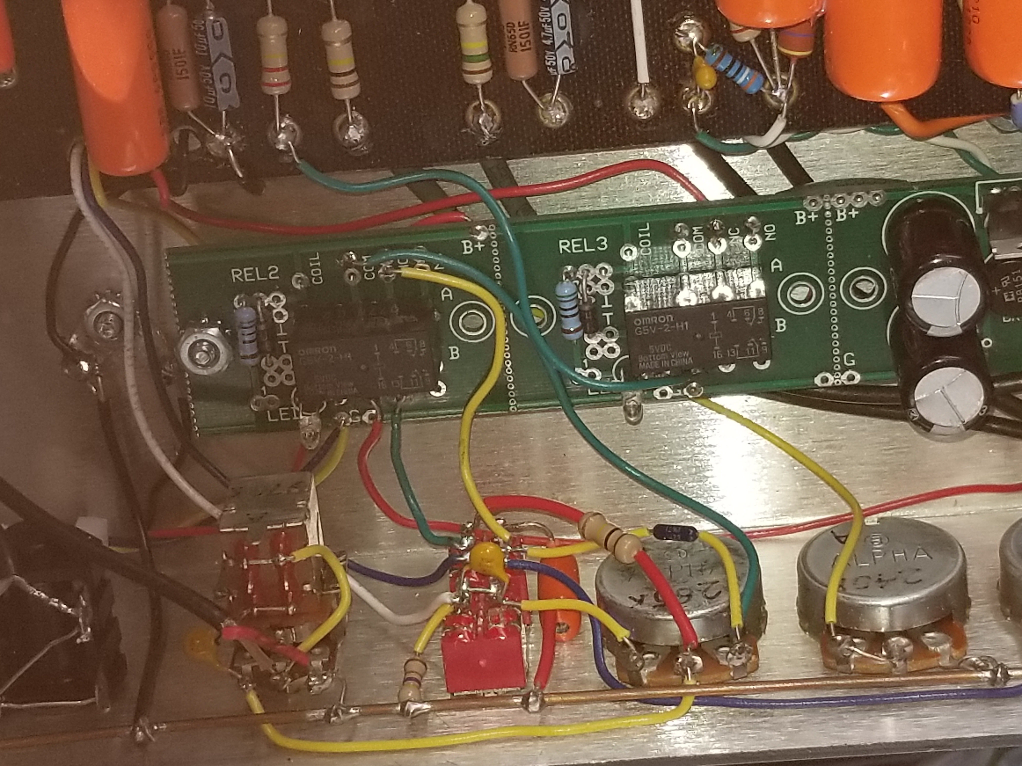

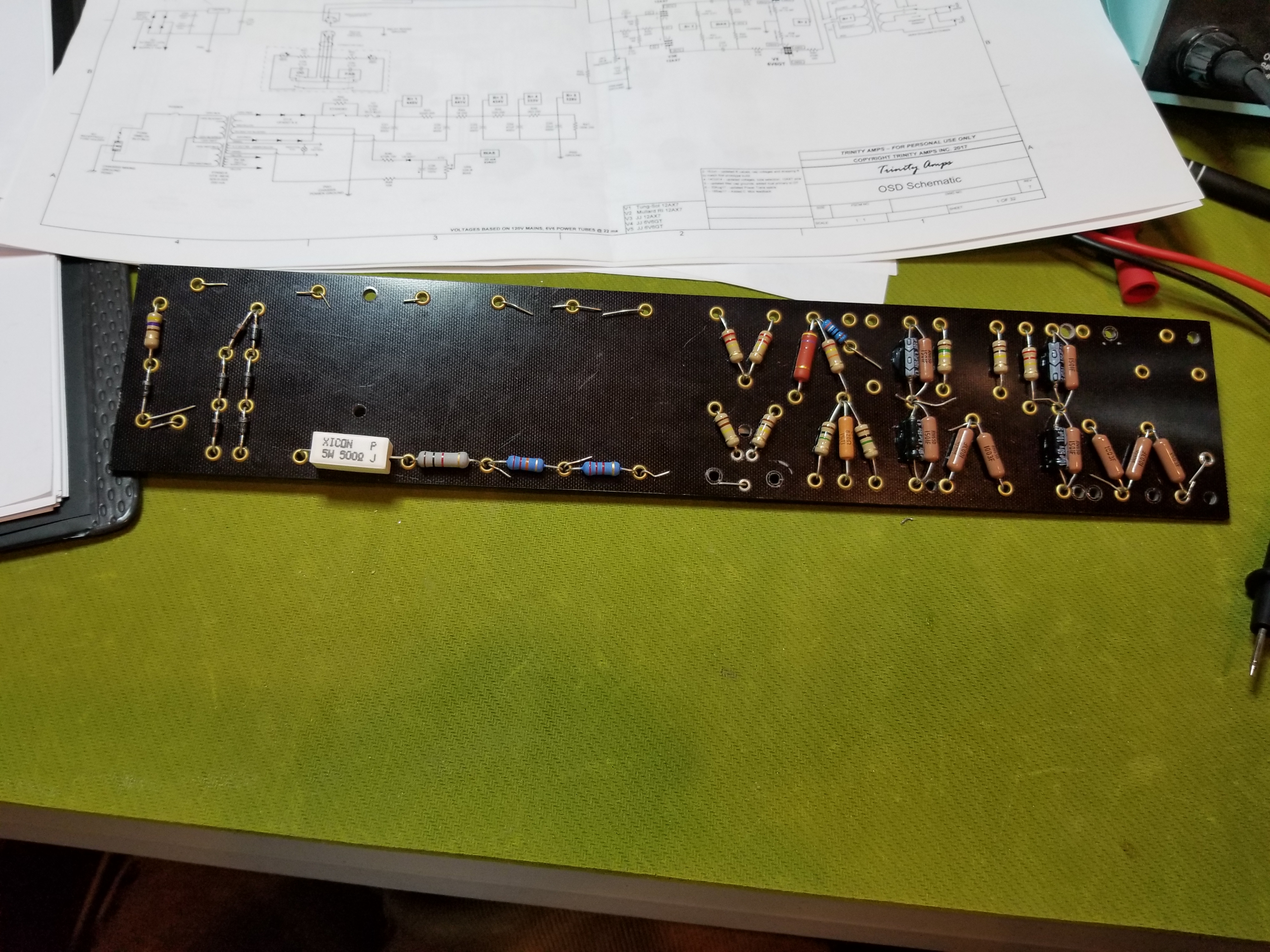

Here's more of the relays, main board, and chassis.
I haven't attached the leads to the board yet. The stuff you see on the capacitors is a silicon sealant that acts as a shock absorber since this chassis is eventually going to go into a combo cabinet. I don't want the speaker vibrations to cause too much stress to the solder joints or cause the power supply caps to rattle.
Today my goal is to wire up the PT and test the relays.
- Matt J.

Wired up the PT yesterday and tested the secondaries. Everything checked out ok.
Built the footswitch and tested the relays. LEDs on the relay board and the footswitch lit up fine and the contacts points tested ok with my DMM.
I am considering building a different footswitch, or modding the one that came with the kit so that there are different LED color for the OD and PAB switches. Anyone know exactly what type/voltage of LED I would need to look for that would work with the current footswitch layout?
Up next, I'll install the back panel materials, then the tube sockets and accompanying components.

Got some more work done this week.
Most of the chassis work is now finished. I've tested all soldered connections and things are checked out ok.
Next I'll be measuring and soldering in the flying leads and getting the circuit board ready to be installed.
I did notice that the mounting holes in the chassis were a bit too small for the bias probes, so they had to be enlarged. The same goes for the mounting holes in the relay board. I had to widen them slightly to get the board to fit into place.
- Matt J.

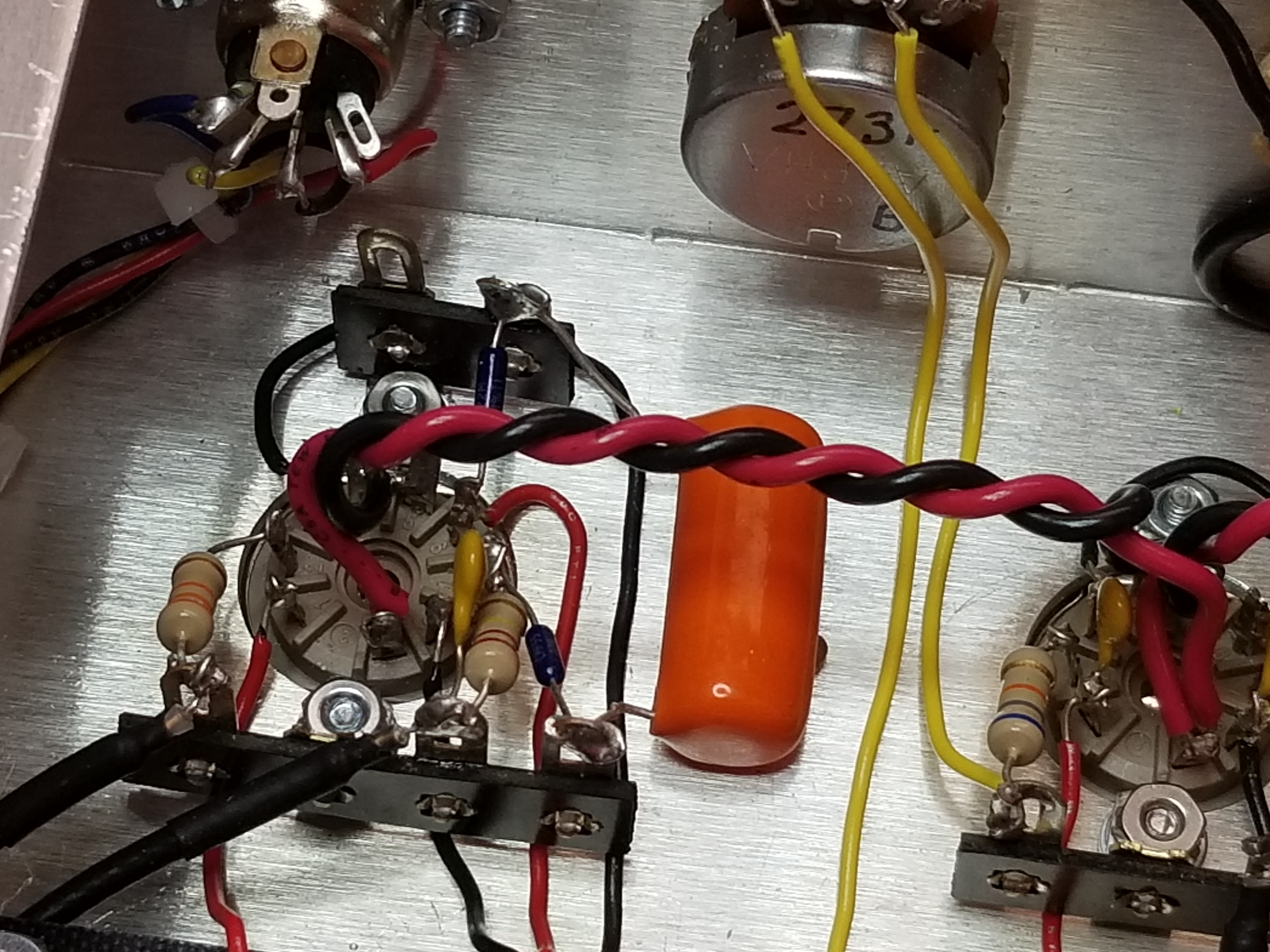

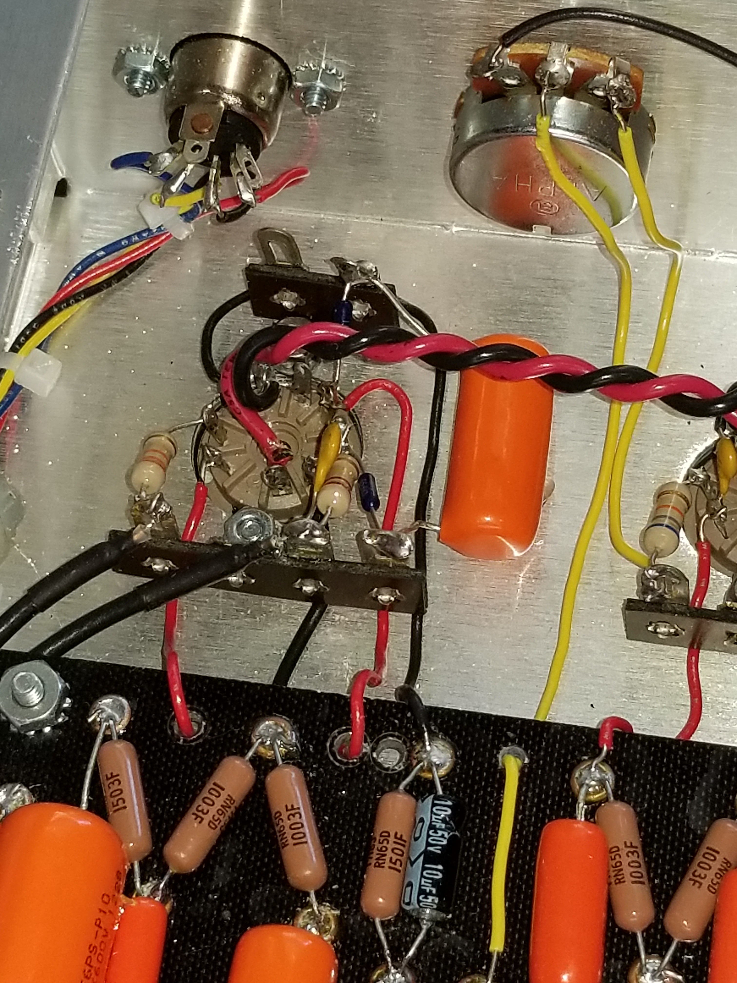

Hey Everyone!

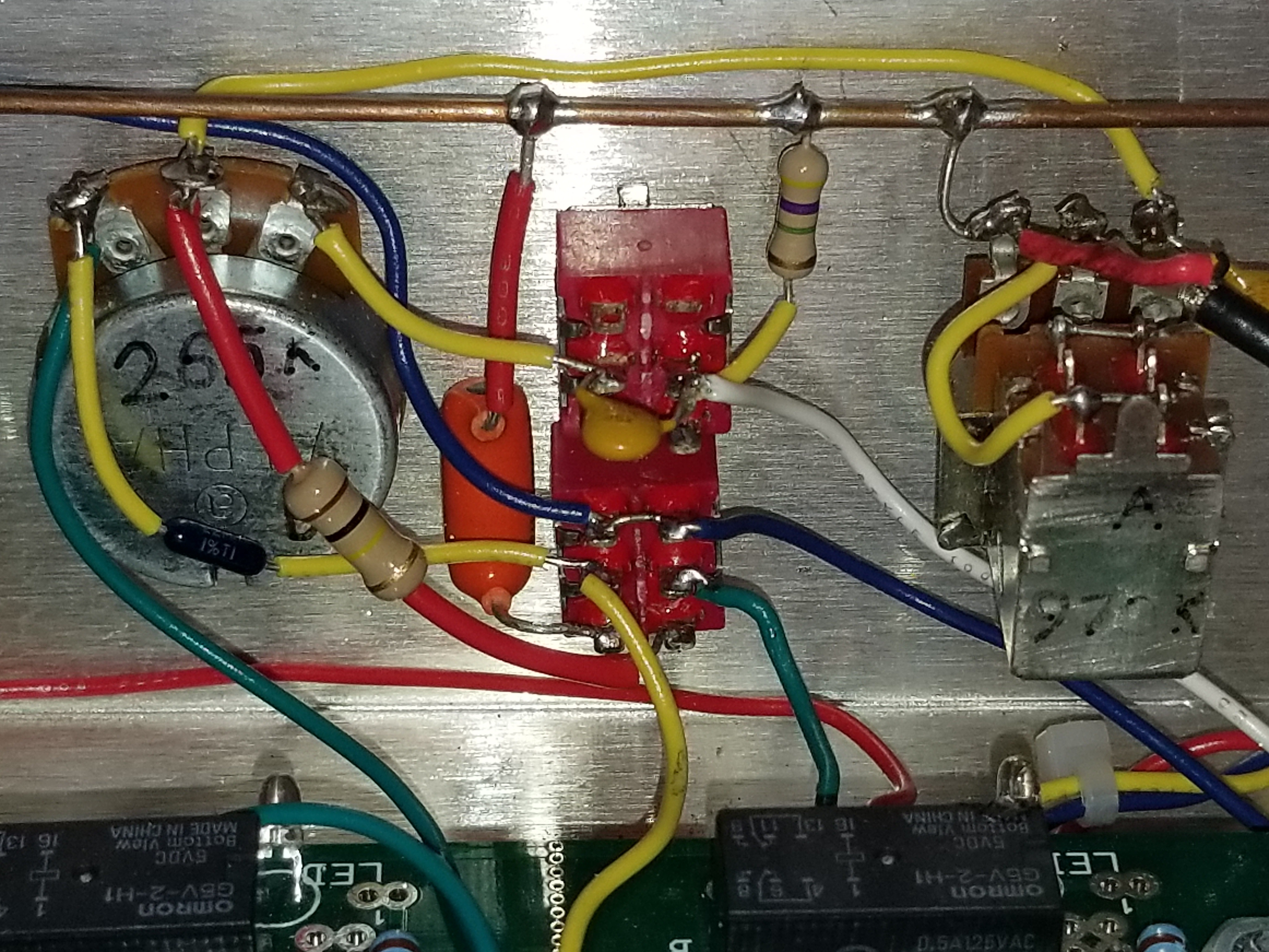

I have been out of commission for a bit due to a kidney stone attack, but now that I am feeling better I've been able to spend some more time working on my OSD.
Everything works fine mechanically, switches, pots and controls. I did rewire the Trim pot so that full clockwise, looking from the back, sends the most signal into V2 and vice-versa. Also, I changed the presence cap to a 2.2uf tantalum to give the presence control a little more depth.
The amp has had some noise issues since I finished it. I the JJ 12Ax7 I used for V1 to be a little noisy, so I replaced it. I also plugged the amp in into a different outlet since my house is fairly old and, due to some older wiring, may have some grounding issues.
That cut down on much of the noise, but, there still remains a great bit of hum when you are only in the clean mode. The OD doesn't hiss or buzz anymore than you would expect from an overdrive circuit, but the clean side has a LOUD hum/buzz when it is only activated. The sound and scope of this noise changes when you wave your hand over the chassis. Also, the level of the noise increases when the PAB is engaged, or when you set the Rock/Jazz switch to Rock.
I've taken some more pictures of the area. If anyone spots any errors, questionable solder joints, or wires were they should not be, please let me know!
- Matt J.

Oh, and I just noticed looking at those pictures that I wired the bright switch wrong too. I'll have to fix that when I get home! :roll:

 Post subject: Re: My OSD build.
PostPosted: Mon Apr 16, 2018 8:41 pm
Posts: 112
Location: Bangkok
For what it's worth.
My OSD is really quiet.
And I play vintage style singlecoils mainly.
Anyway, go through all solderings. Wiggle the wire a bit, so you can confirm the solder is solid.
I found a couple of loose solderings that way myself.
Good luck:-)
