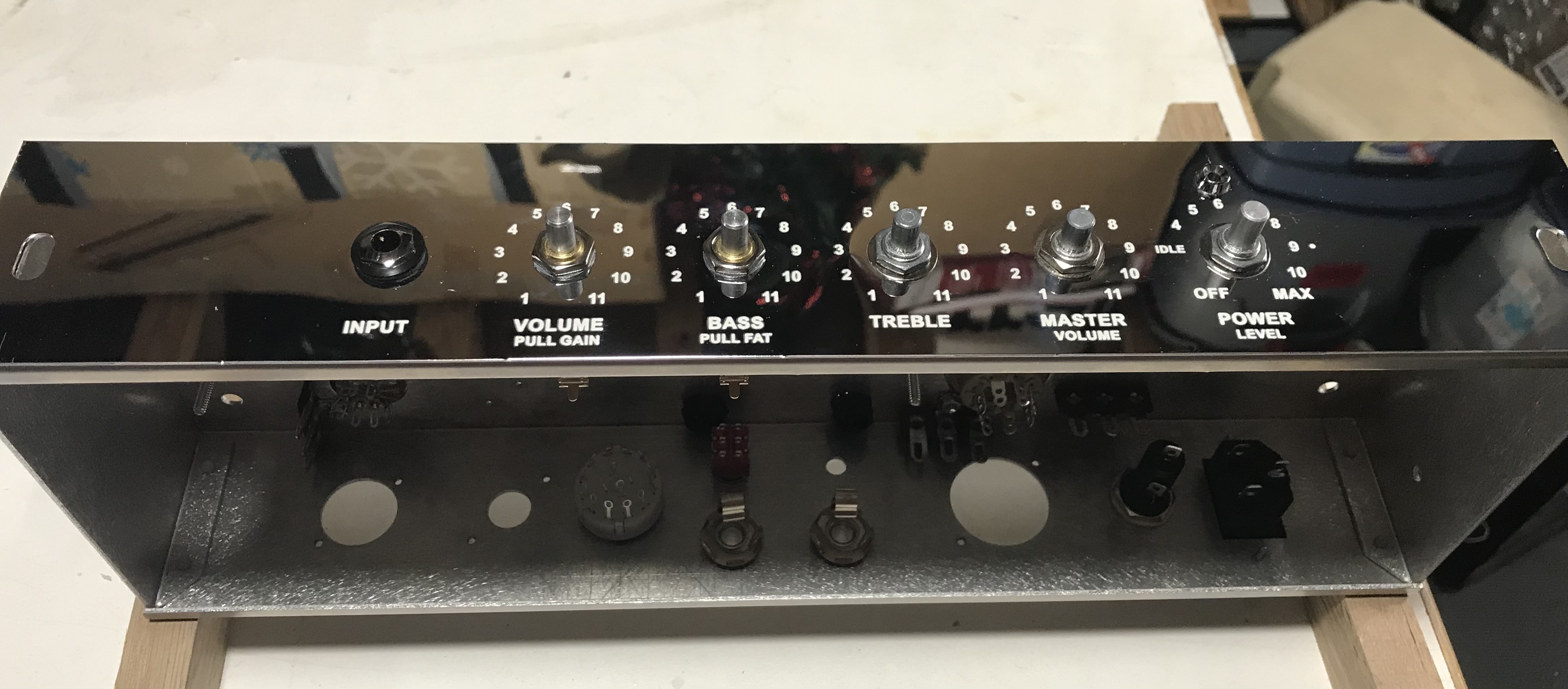

I've been dabbling in electronics for many years. Did a bunch of Monte Allums pedal mods, upgraded a VHT Special 6 Ultra, and modified 4 Fender Blues Jr's (billm), converted one of them from EL84's to 6v6/5881/6L6. Super fun!
So I figured it was time to do a complete build. I've also began doing more woodworking lately so looking forward to building the head cab and speaker cab; box joints, routing, etc.
I'll try to document this the best I can for posterity and to help other builders... just like a few of the other threads will no doubt help me.

Tonight, I installed all the hardware!
